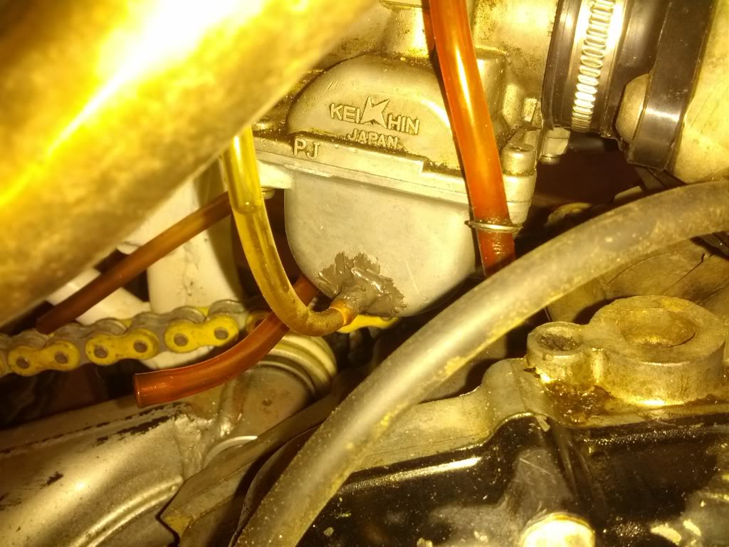

Ride report: its a blast! He, see what I did there?! It's a beast... power all over, handles great and NO MORE CARB LEAK!

Leaky carb culprate... that's holding strong. No issues there anymore.

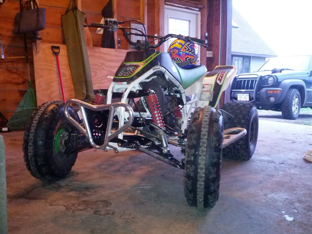

the graphics were custom. I cut them myself and pinned with green.
But on a side note... My wheeler is done, here she is!
