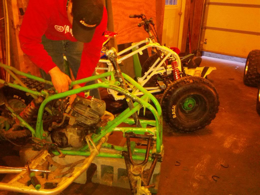

Commencing 240 rebuild!

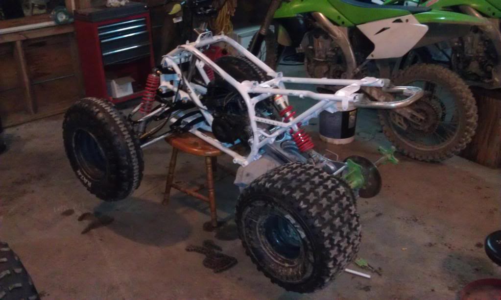

Did work again last night. Motion Pro brake cables, got it down to the engine and rear end left. Engine comes out tonight so I can get it cleaned up, maybe some high heat paint to make it look better. Hope to be running this weekend.

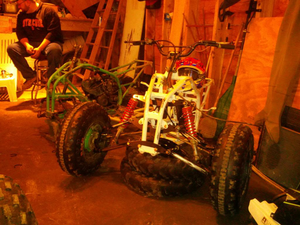

still not crazy about the red shocks on it thats the only thing that bugs me about this bike. IDK if the green color was off but it looked good for what it is but i also love the way the white turned out. im so interchangeable lol
in a perfect world, the red shocks would be green... or the green trim pieces would be red. I may try to fine some white shocks to swap on there. I think that would look better than the red.
interesting... I wonder how well they would hold up. I'm thinking I'd rub half the paint off the minute I put the straps back on to put them back together. I have debated on just doing shock covers... though I've always HATED them.
im shure it'd work/hold up nicely if you did a clear coat then a solid plastic paint coat or 2 and let it take for a day or so before you put it back on. ive always hated shock covers 2 couldent stand them never looked right.

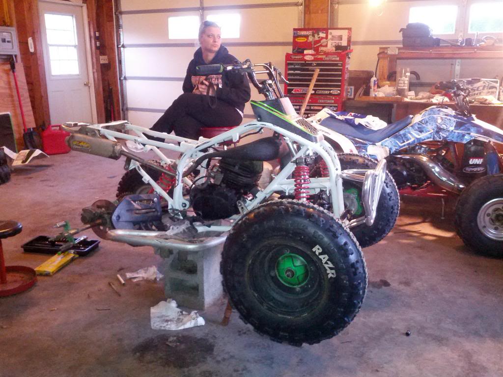

wiring is done... WE HAVE SPARK! The foot pegs, nerfs and exhaust are on. Need to get the carb not leaking, throw that on, put the tank and plastics back on and then I wait for the new chain pullers to get here and it's done. Riding by saturday!

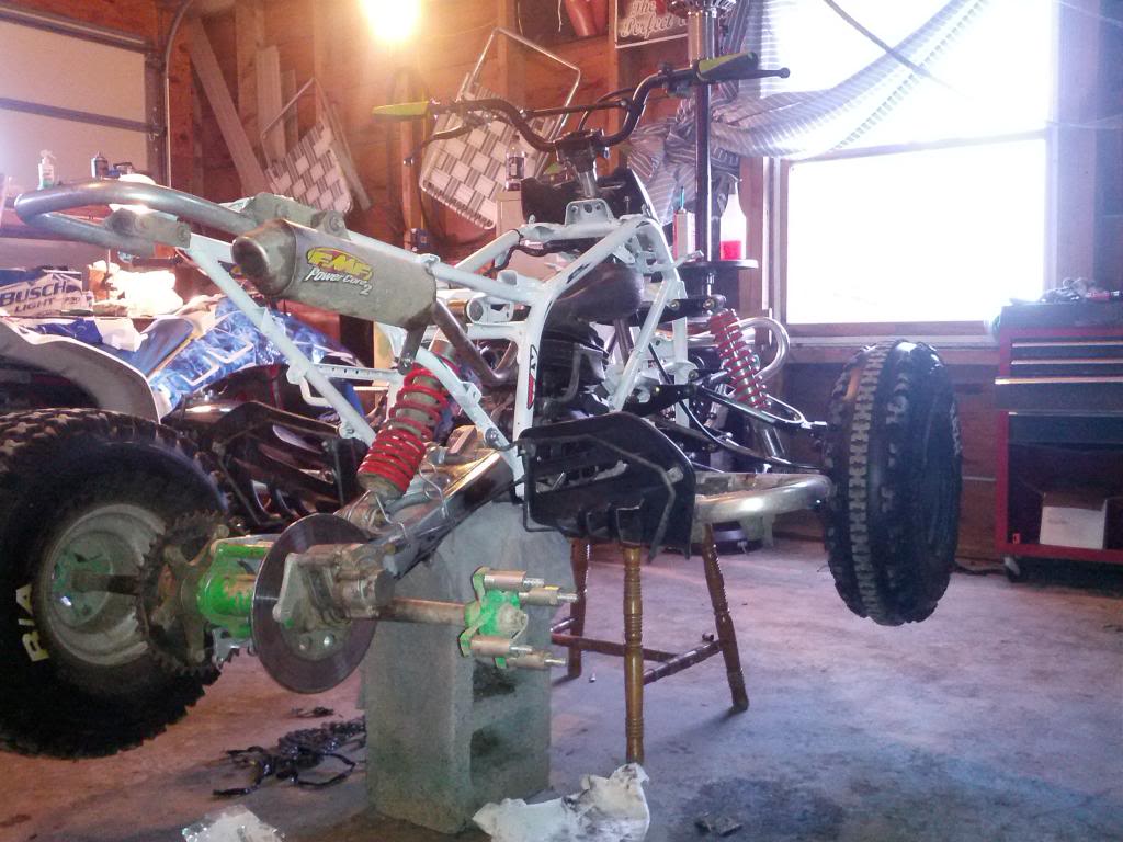

Ended up JB Welding the fitting to the float bowl. We'll see how well that works. Doesn't look the prettiest but it's about par for the course with the rest of the cobbed up, Jerry rigged nonsense on the bike. I'll throw a few pics of last nights progress in a few

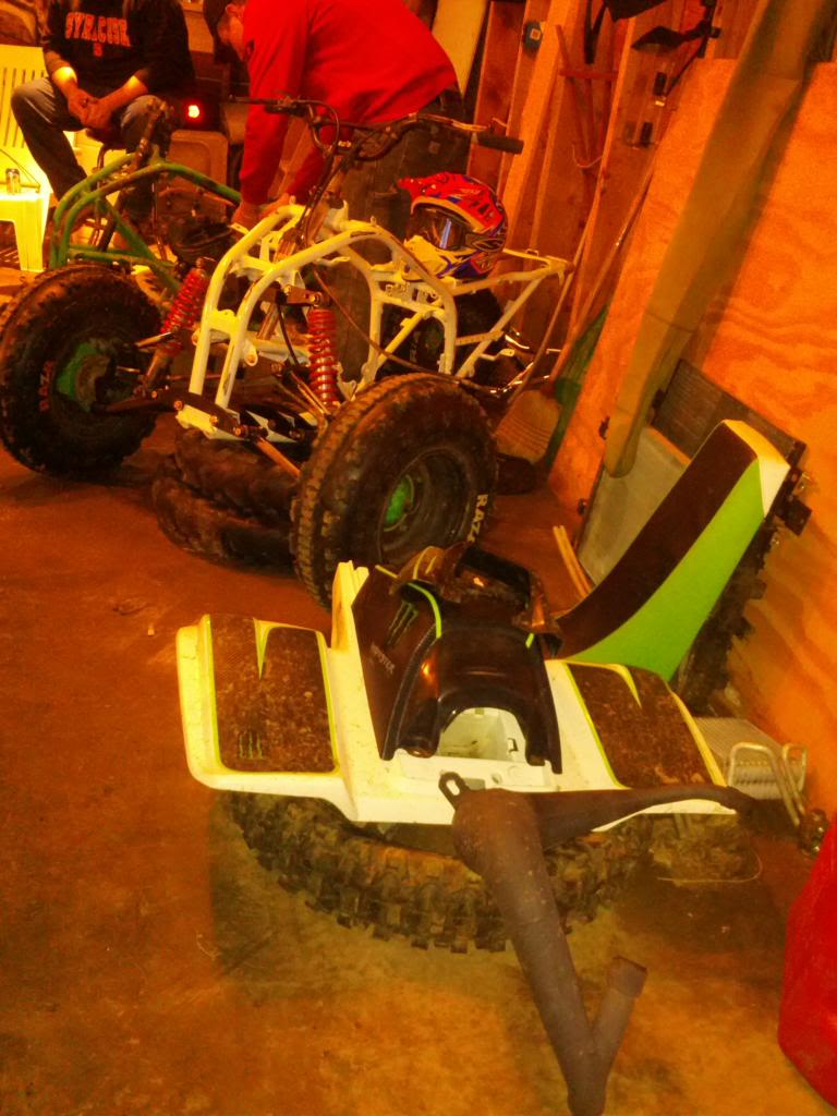

BAM!
(I'll be smoking that fella behind mine!.. lolz)
it's SO close!.. pretty much everything is good, would have been done last night if it wasn't for the carb issue and chain pullers. Looking at the float bowl this morning, it looks like the back yard, JB Weld fix will hold. I'm going to have my buddy try to get a hold of parts unlimited or Keihin directly and see if we can get a new one just in case. all that's left is to put the carb back in, plastics back on and finish up the carrier and rear end. All told, the whole thing should take me 30 minutes tonight.
