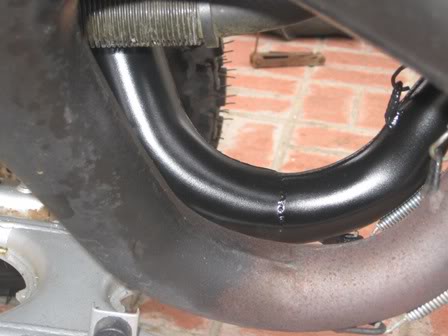

Before and After:
I used a course wire brush wheel then a fine wire brush wheel then i went back over it with the polishing wheel and it brought it back to a shine. not a new shine but close.
