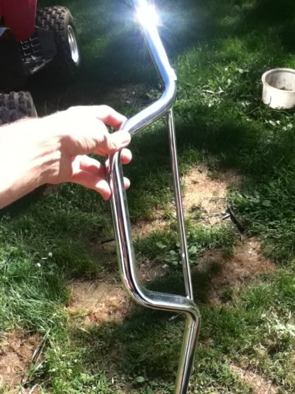

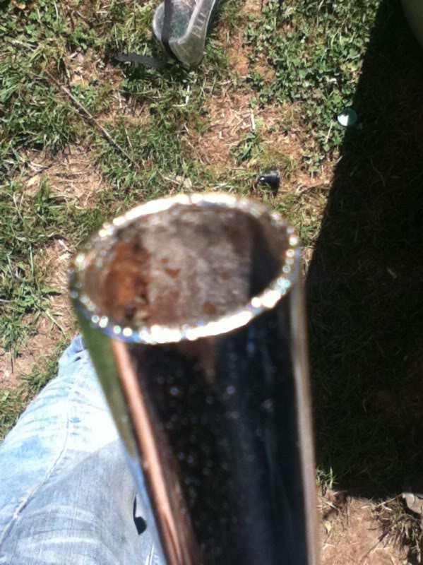

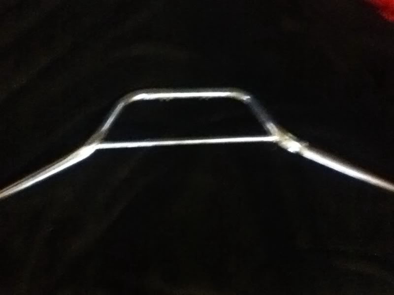

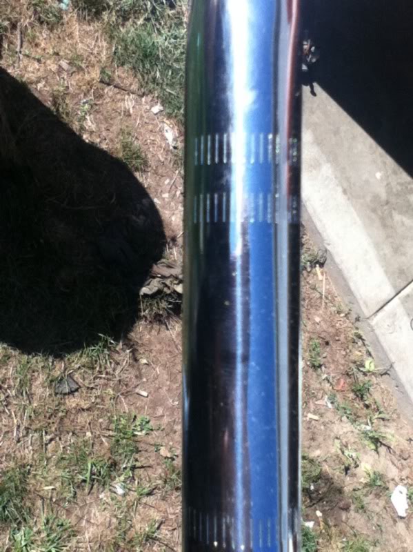

so far only gave him the handlebars. ne ideas on what will need to be done to swinger and a-arms before they can be dipped?
