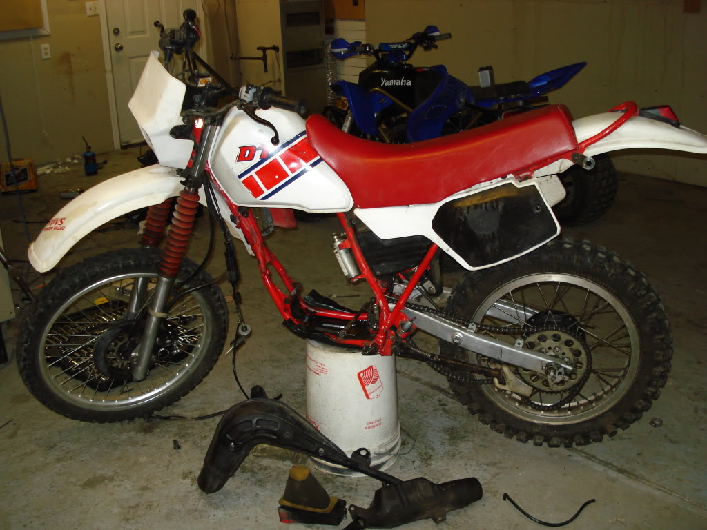

well it ended up being a blizzard out today so i decied to tear into the DT
One thing i noticed is THE SWINGARM BOLT IS GREASABLE! so the motor came out easy!
Also a few other things i noticed.

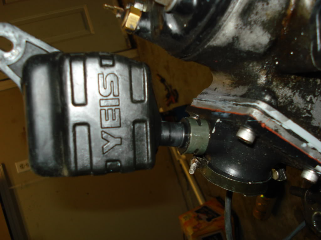

-it has some kind of boost bottle looking thing(ontop of intake mani)

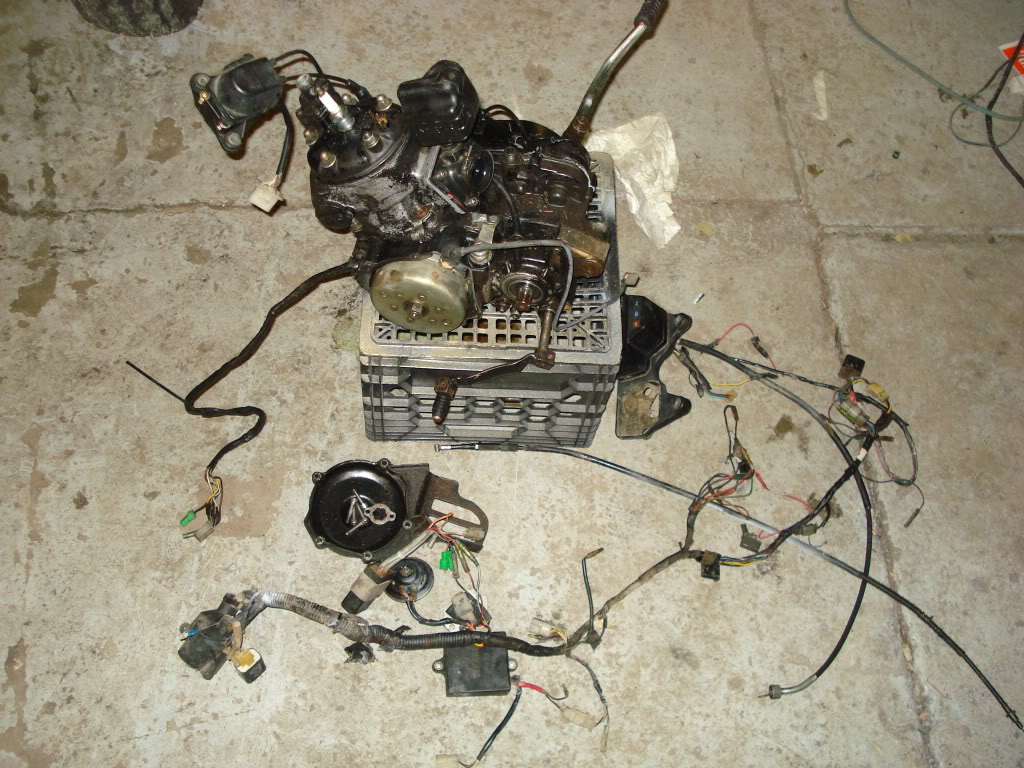

Here is some better pics those ones are really blurry.
I have everything off the Dt that i need to do the swap now.

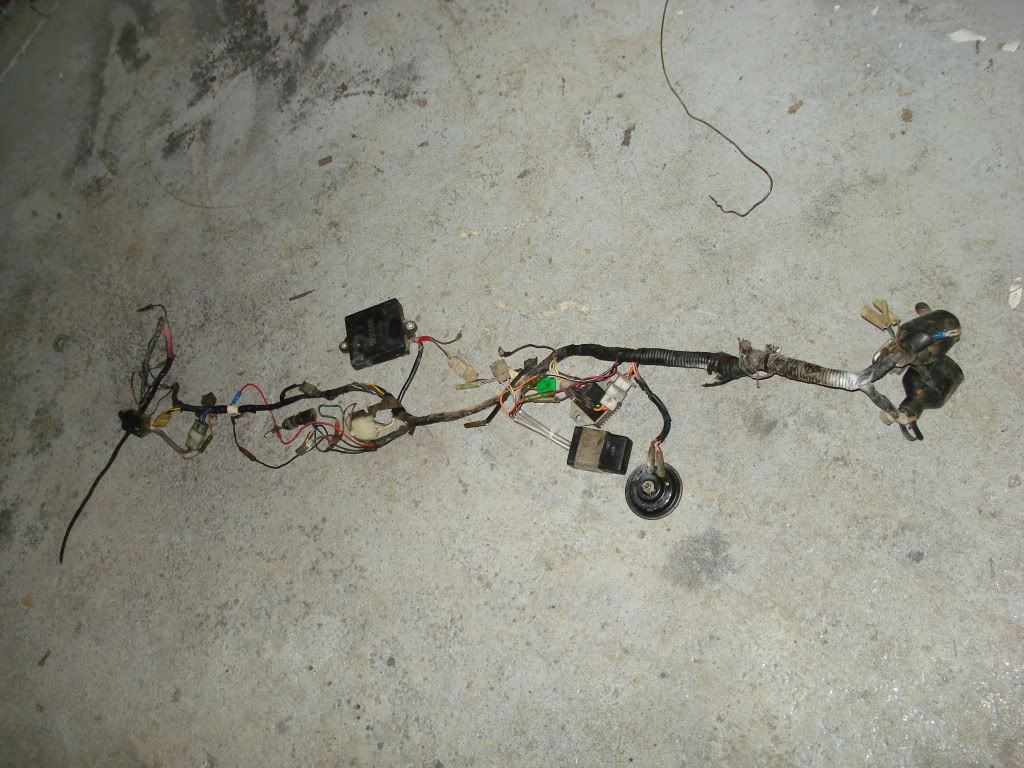

Look at this wiring harness its pretty complex compared to the blasty , but lots of it is uneeded. Ya thats a horn!
Here is all the parts for the swap minus the radiator
The motor
boost bottle?

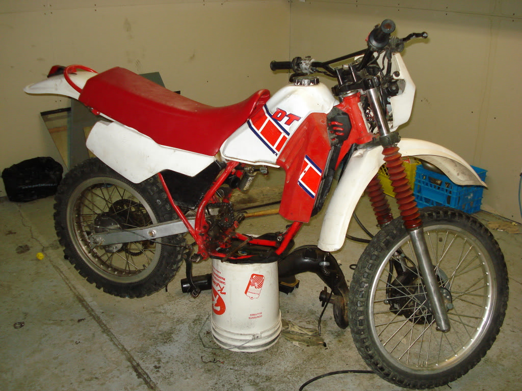

the bike now that its stripped down . Anyone need anything?
The blasty and its motor donor on the operating table!
chain look good, was it towards the front of the adjustment on the swinger? Does it have 114links or more?
