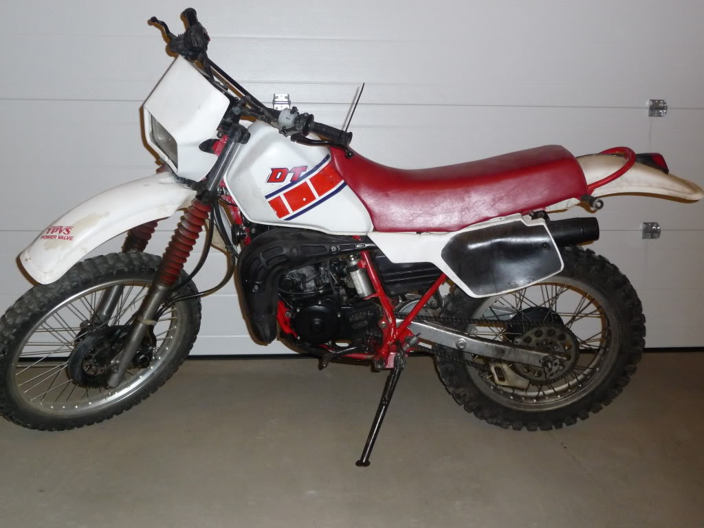

Well boys i wish i had done this before bought my 240 kit.
I Posted an add on Kijiji looking for DT200 Parts or a whole bike. By the end of the day i recieved various emails one guy says he has a whole bike thats running just leaks a bit of coolant at the water pump.
I talked to the guy some more he said 400 bux and its mine. So Here she is boys im damn excited , i will be able to totally swap the motor in my blaster!
MY NEW 1986 DT200 hahaha
i already have a 240 lol
Kennedy is going to weld the head and port this DT before it goes into my bike. after that My whole engine will be forsale its mint 180psi compression
i also have an extra dt 200 head and cylinder
if anyones interested?

Check your PM's I have the parts to fix the waterpump leak. EASY fix, I had the same problem. Just have the waterpump gasket sealing surface machined down if it's out of spec. If not I'll take some step by step pics and walk you thru the replacement.
Call Yamaha of British Columbia for the waterpump seal. If you post a pic of the leakage I can tell you if it's just excess coolant, or an airbubble forcing coolant out the "weep hole" in the waterpump housing.
O yea, get some spacers made for the swing-arm area, and the front engine mounts. The DT engine is slightly narrower, cases are for it to fit in the Blasty. Or just swap this one bearing and use your blaster cases. Then put the 240 in the DT and have a bike/quad!
