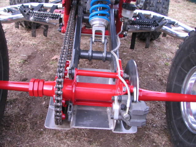

Again they will go in with no problems.I have installed a few banshee axles in a blaster.The shee axle is exactly the same as a 03-06 blaster axle except the shee is 3 1/2 longer.The carrier dimensions are the same exact carrier with just different brake mounts.Here is a pic of an older style carrier with a shee brake boss cut off and welded to it.And that is the shee axle pictured.I have installed a total of 5 shee axles in an older carrier without any problems.
So I can take a banshee carrier and use it and it will work?
No a banshee carrier will not work.You can cut the brake boss off (brake mount) and weld it to an 88-02 carrier and it will be the almost the same as what you have now.
