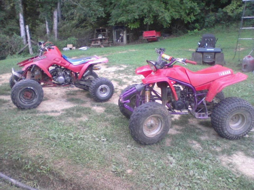

aubryblaster97 New Member May 16, 2011 293 2 0 Aug 5, 2012 #1 well my friend wants to sell me his blasty for 250. it was smokig pure white so im guessing new crank seals. what do yall think?

S scotj77 Member Feb 11, 2010 5,546 70 85 47 Orlando, fl Aug 5, 2012 #2 any mods or straight stock? you could possibly have to split the cases if the leak isn't at the seals

Braaaptor Member Dec 1, 2009 2,169 117 48 Hamlet, NC Aug 5, 2012 #4 For that price, GET IT!! Just do a leakdown test on it once you have it in your posession, and you'll find out right quick where the problem lies. Probably a damaged RH crankshaft seal.

LiftErUpTV New Member Aug 4, 2012 59 0 0 NWA Aug 6, 2012 #6 WHY IS IT HONDA COLOURSSSSSSSS!!!!!!!!!!!!!!!!!!!!!!!! I would get it, fix er up, then you have 2 Blastyyss

Blaaster Moderator Staff member Technician Jul 18, 2011 15,384 1,121 165 eastern australia Aug 6, 2012 #8 Depending on how long it has white smoking, the piston may need looking at. It is not only sucking in oil, but it too is sucking in air, which you should know is detrimental to piston life.

aubryblaster97 New Member May 16, 2011 293 2 0 Aug 6, 2012 #9 it needs a topend rebuild and the seals
B blasterBruce Member May 13, 2008 2,379 41 84 Griffin Ga Aug 6, 2012 #10 give him 200 for it , I bought one with mods for 200 that needed top end and seals !, In the process of doing the motor work now
