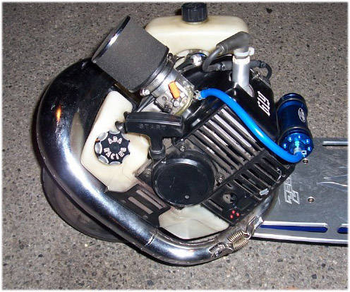

My son was running a boost bottle on his DT200 powered Blaster:
You can just barely see it between and over the carb and the cylinder.
Here is a close up from someone else's engine:
The volume is 200 cc's and the neck size is 8mm and the neck length is 29mm.
I figure a bigger bottle and more open neck should give a stronger signal as long as it is in the right tune range. Working with this Helmholtz calculator webpage I came up with some figures.
An 800 ml bottle with a 1/2" or 12-13mm neck that is 3/4" or 19mm long will be in the same tune range as the original.

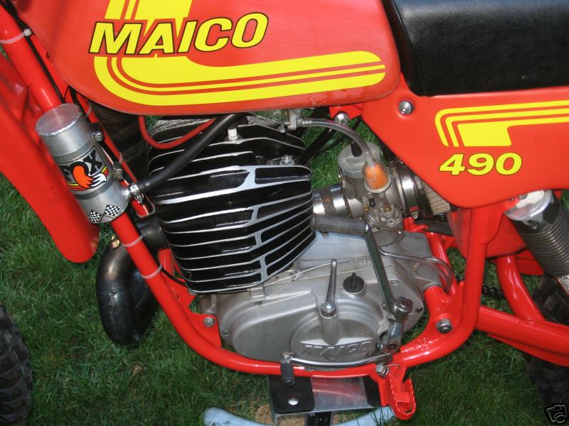

I have played with the boost bottle on this old bike:
OOPS! No, it was this one:
Yes it is rough, but it runs well and it has been in the family for most of this century, and if you came over for a visit without your own bike, this is what you got to ride.
But I digress. It comes with a boost bottle and you can swap it off and on and see that it has an effect.
