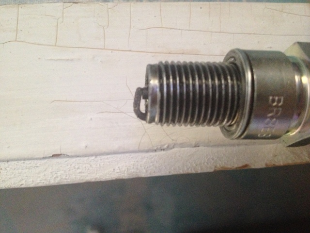

here are pics of both plugs i went through....
5
Hmm.... have you pulled cylinder off yet? If not do a leak test quick. I'm interested to see what caused this. Keep us updated.. like best said there is no way for a piston to hit plug. The plug is recessed in the head. Unless you have something in your cylinder, did anything fall in there when you changed plug???? Something is definetly wrong obviously..

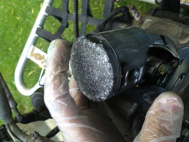

so finally started to take my motor apart and this is what i found....
soo my question is now... how do i actually take off the piston from the rod and can i just throw on a new piston and be all set or what should i do???

dude, thats horrible :eek:
there is chunks of piston missing. :eek::eek:
and i hate to be the bearer of bad news, but that needs much more than "throw a new piston in it"
that needs at least bored/honed to a new piston/rings,
and the bottom end checked for shrapnel and cleaned < but thats a huge risk just trying to clean the bottom end bearings, if 1 little piece is still in a bearing, it will fail and take out the new top end :(
i'd be doing a complete top and bottom end rebuild if that were mine
FOD - Foreign Object Damage, although in this case the foreign object was likely the rod bearings.
You need a complete engine rebuild. Case split, new crank and bearings (~$200), an oversize piston kit (~$100), Bore (~$50) and cylinder head rechambering ((~$70). Sucks man, but then what 4 stroke can be completely rebuilt for under $500?
Steve
Top and bottom end rebuild is definitely a must ! And it does suck but I had to do the same thing last spring and I can tell you there's nothing like having a brand new motor ! I got a Wiseco top and bottom end kit complete with everything ( piston, crank, bearings, gaskets, seals etc. ) for $315 shipped from Motosport.com. Also as mentioned your going to need a new/used head or have the one you already have rechambered/redesigned ... Considering the money your going to be spending on everything you might as well spend a little more to just have your head redesigned/milled and get some more performance out of it. Hopefully your cases wernt cracked from when that bomb went off in your motor !
I had the same exact thing just happen to mine. I ordered a .20 over piston vitos +3 stroker crank and new hot rods crank bearings with seals for just under 300. On ebay you can get a complete weisco engine rebuild kit with new stock crank and piston with all gaskets for 229
