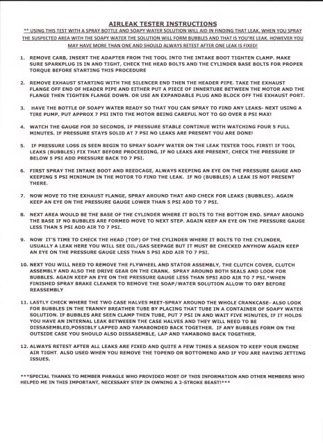

Does It seem to have Compression on the Kick starter ? . did you check all the obvious areas , Carb , spark plug , Reeds ?, Search the forum for Leak down test ! . Chime back in too !
