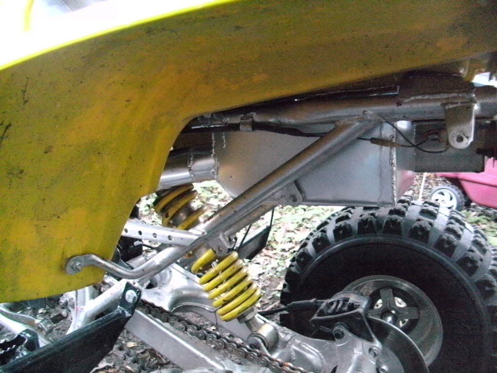

I didn't order any stuff and I didn't take any measurements. I knew where I wanted the box and the carburetor was already set in place. I went to advance auto parts and purchased a 3 foot stick of 2" exhaust pipe and then to ace hardware for a 24" x 24" of 22 gauge steel sheet.
I drew up the plans on the sheet itself and then cut it with aviation snips. I bent it by hammering it over my vise and bending it with sheet metal vise grips until it was the shape I needed. I turned my welder on 1/4 amperage and slowed the line speed way down until I could weld without burning through it and went to town. I set it in place as I worked checking to make sure it wasn't warping out to where it wouldn't fit and then I drilled the mounting holes in the tabs after it was all built to match the frame holes.
voila! custom 2" airbox with uni pod filter
It's an OKO 30 mil I bought off Ebay from a distributor out of Taiwan. I had it in about 5 days from clear around the world.
I probably could build it but it won't be much cheaper than a CFM aluminum box off of Ebay and they look better. If you're like me and like handbuilt stuff, it can be done. Let me get back with you about the price.
