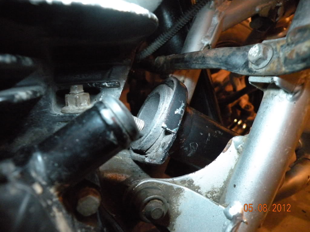

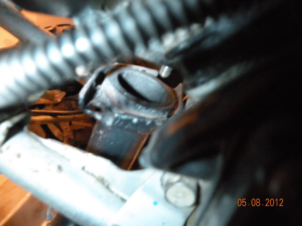

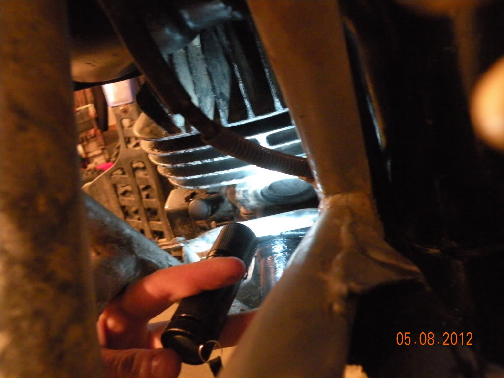

Exhaust gasket. I took some pictures, because i've never seen an exhaust gasket in my life. B)
But I'm pretty sure it's not there. But just to be sure:
