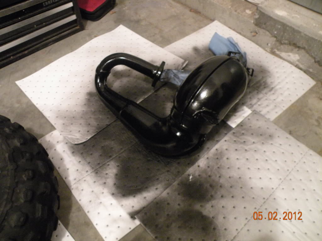

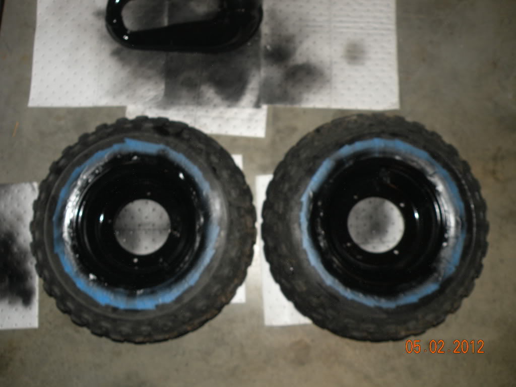

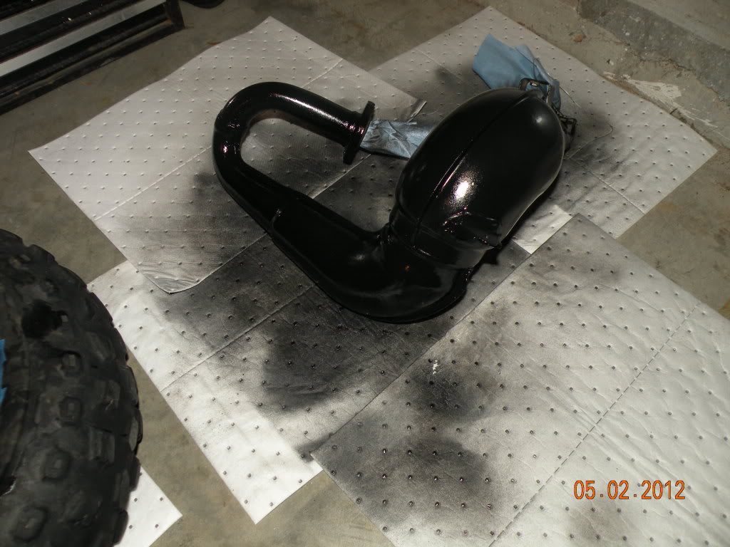

Finished up my pipe, and put the first coat on my rims!

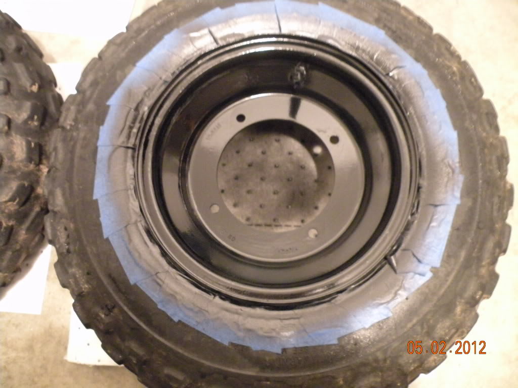

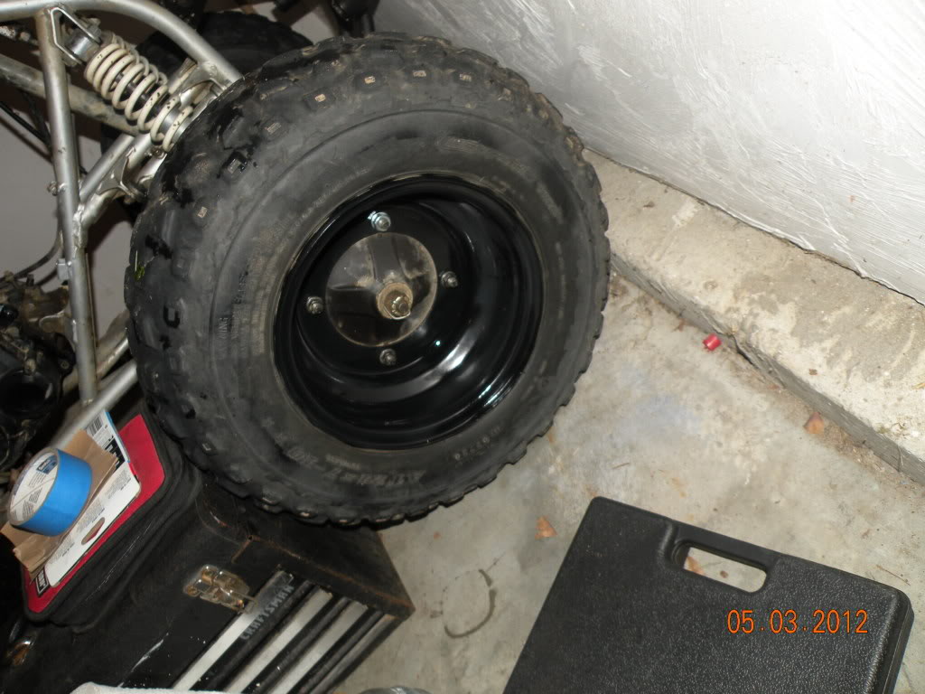

I know i took the easy way out on the rim's. But as you can see from the picture's they are pretty beat up. When i need to replace the tires, I'm going the replace my Rims too.

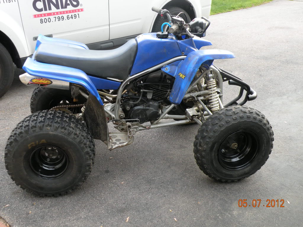

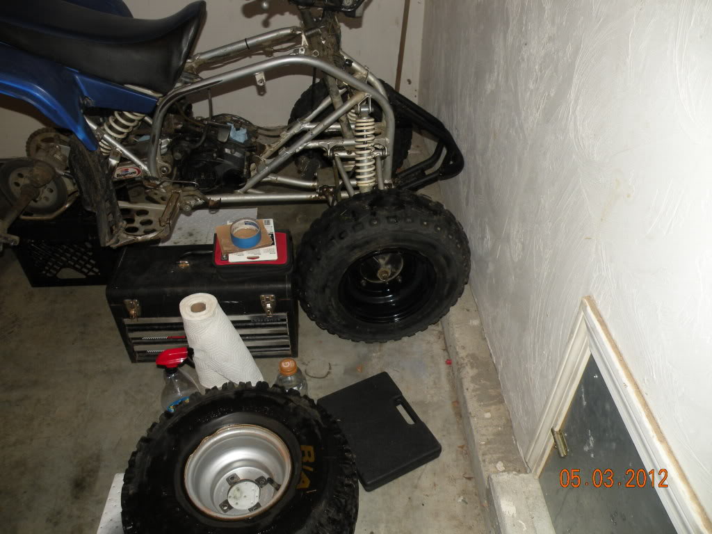

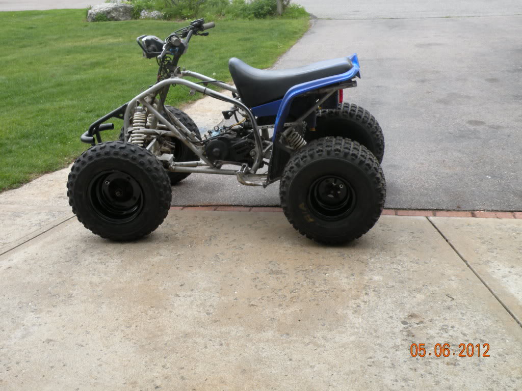

Finished the Front wheels and mounted them up.

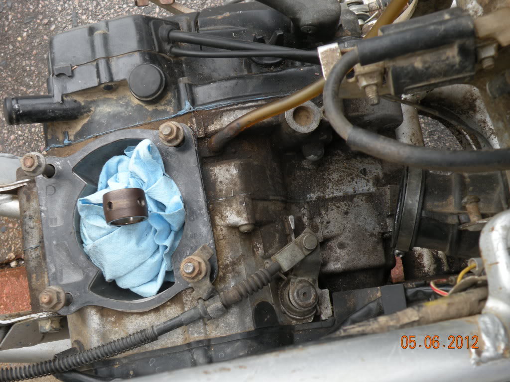

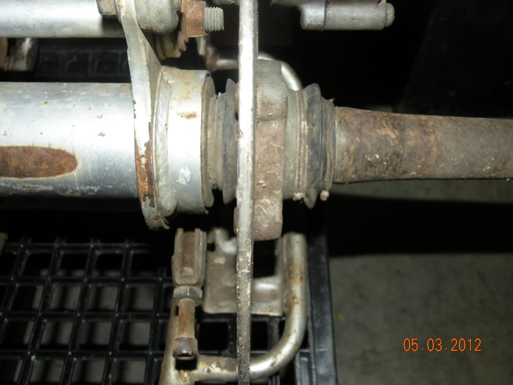

I'm not sure if these are seals to be honest, but it looks like they need replacing, along with my swing arm spacers, i've got a little side to side play with the swing arms.

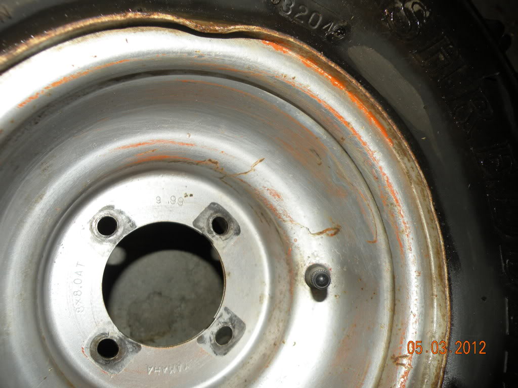

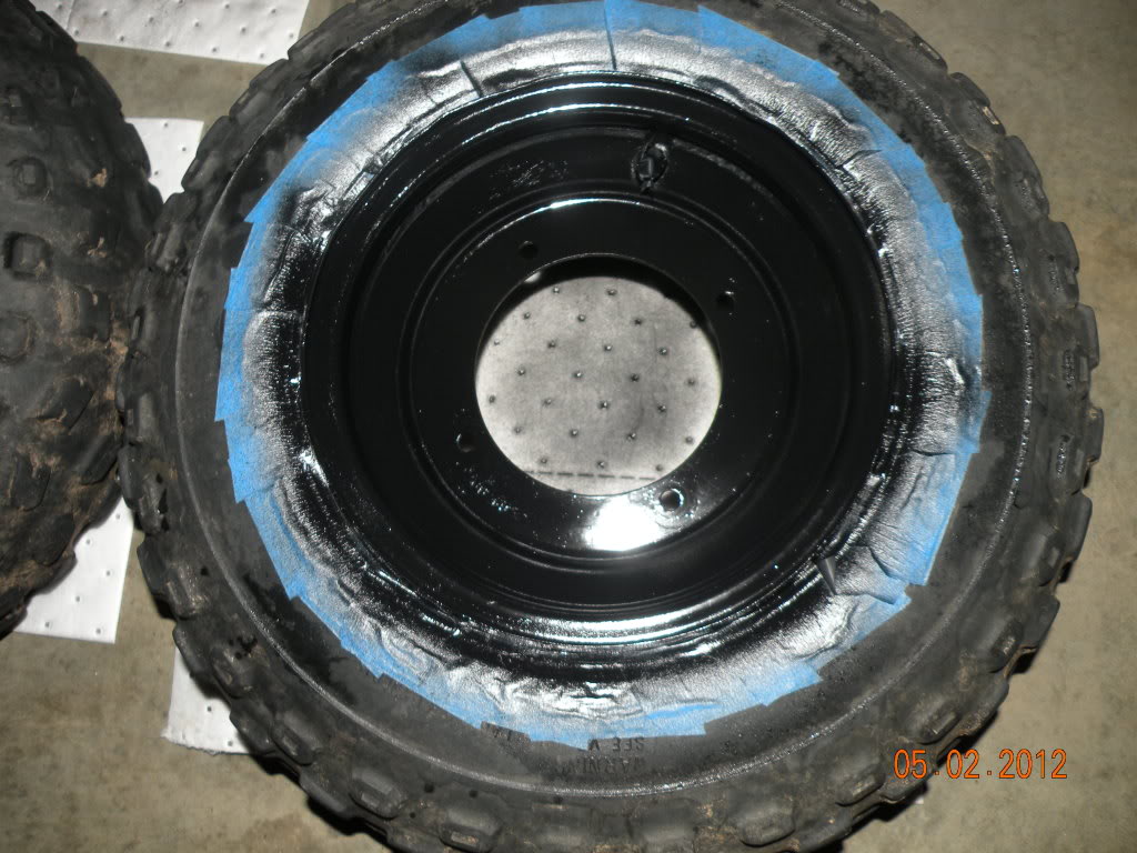

And while prepping the back wheels i noticed someone painted them orange are some time. Such an ugly color.

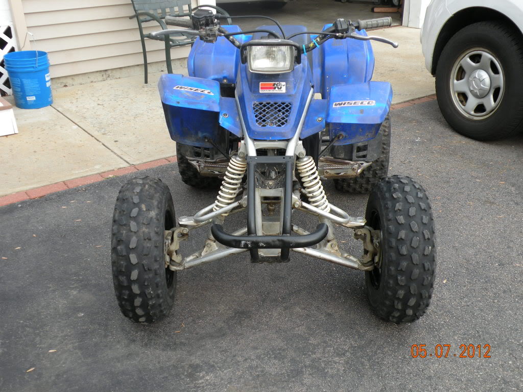

Wow mine's a 2000 also and I thought mine was in bad shape, I guess I should stop complaining about mine. You or the previous owner must've drove that thing pretty hard. Looks good though, was the bumper painted when you got it or did you do it? Because I had a huge dent in mine about half as deep as the pipe, so I drilled a hole in the back, heated it up and pounded it back out, so I have to repaint and I'm wondering what's the best way to make sure that it stays.
Yeah, the guy was clearly a hick. The type that knows nothing about anything and if it runs, it's good enough. No hate against hicks. I'd consider myself a redneck, the ignorant ones are the ones i hate.
That bumper came painted, but if you sand it down, and clean it up, then put like 3-4 coats of paint on, then another 3-4 of gloss it shouldn't chip too bad. I haven't hit anything with it yet ( Knock on wood ), so the paint is holding up good.
