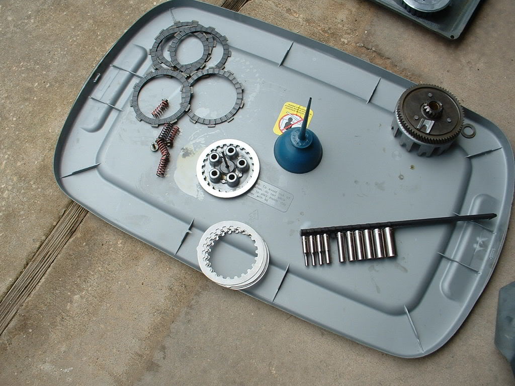

This morning I'll be performing minor surgery on the newly broken in Blastard.
I took it out on the dirt road beside my shop yesterday to see how fast it really is. All was well til it came on the pipe in 5th and 6th,then it slipped pretty bad. I have another clutch that looks good out of my parts motor so I'll give it a try failing that i'll order a Barnett. Surgery pics to follow.
Clutch repair complete ,filed down the ridges on the clutch basket and after careful assembly and adjustment with all the pieces from the original motor all is well with the Blastard... Also found that my spare basket had a cracked ear which broke as soon as I pushed on it good thing I didn't use that one...
