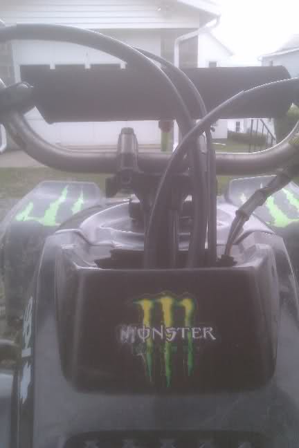

as promised, a video just for you !!!!.................
and for my buddy dualstroke, who said my bars looked like apehangers ?
(ya don't really think i bought anything without doin my homework, do ya ?).............

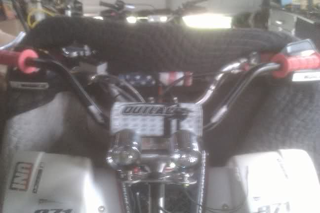

i am a little surprised my renthals on the bike now, are an inch or so wider each side, than these new outlaw fatbars ???
but the height looks real close...........

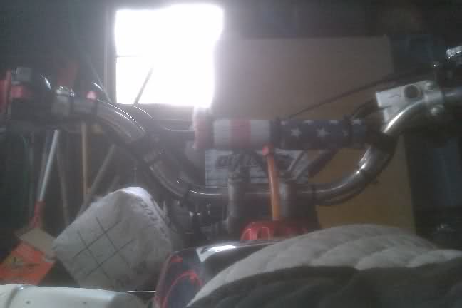

this pic was taken at a downward angle, the mount just looks lower
all lined up........

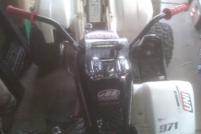

removed my stock stem today, cause it has the hole needed to mount my old denton stabilizer on my black bike, then decided to also extend it 2"
in the mean time i sat the new anti-vibe in place..............
/\/\/\ i gained my target 2" over stock, 1 1/4" over my old set-up with the flipped mounts under the bars

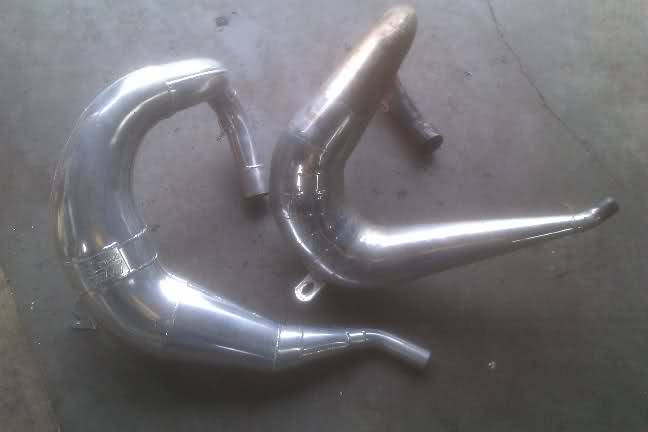

got a chance to throw these 2 side by side the other day, to see the difference in expansion chamber size, what that determines i have no clue
Dynoport vs. Trinity (?) multi cone

heres my thoughts......
the LRD adjustable had more top end when adjusted to the shortest expansion chamber size, and more bottom end when adjusted long
i hope that doesn't mean the huge, long chamber on the dynoport will not give my bike more bottom at the cost of more top end ????
is so, my old pipe will go back onto my bike, and the DP. onto the black one

How similar is the LRD adjustable pipe and the dynoport adjustable pipe??
the LRD which has now sold, had a similar diameter expansion chamber, but it continued back much further
here...........
Dynoport vs LRD adjustable side by side comparison.....................
