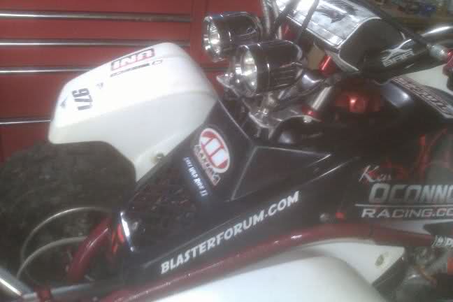

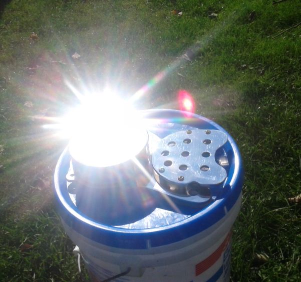

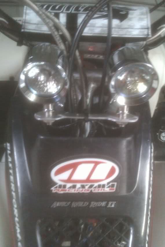

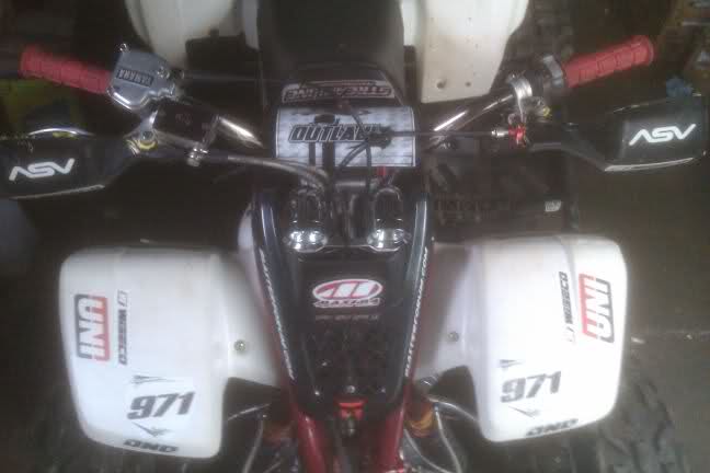

got the mount finished for the Trail Tech lights and got them on and wired today.
Contrary to what the technician at trail tech told me, you CAN NOT run 2-35 watt lights on the stock blaster stator, when both on they were hardly lit at all, even when revving it
so they got wired ...flood light to low beam of the switch, and spot light to the high beam
i have a 75 watt lighting coil, that will go in soon so i can run both of them at the same time

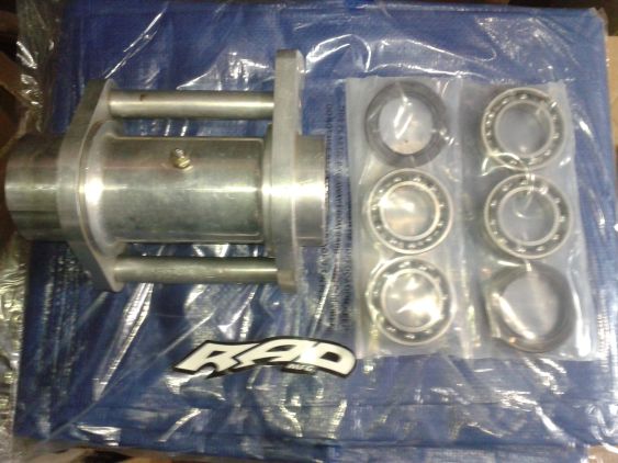

snagged a replacement for my trashed rad carrier,
all 4 brand new bearings and seals
notice the bearings are not sealed, to allow grease in when added to the zerk, not sure i'm a fan of this ? i like my bearings packed and resealed.
the external seals should do a fine enough job keeping the crap out of the grease and subsequently the bearings.
to each their own! I would like it better sans sealed bearings

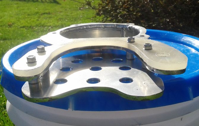

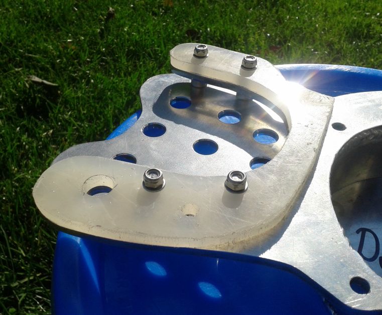

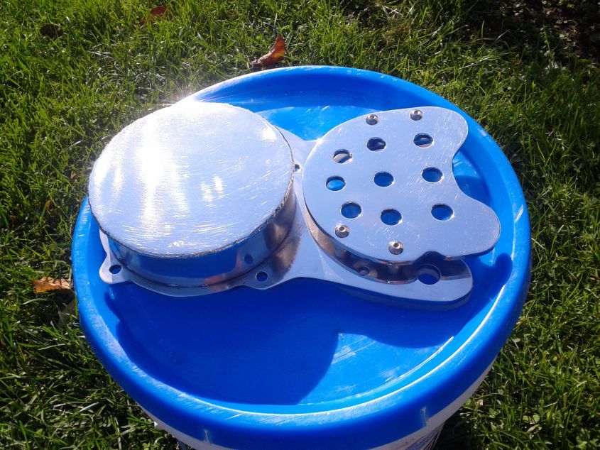

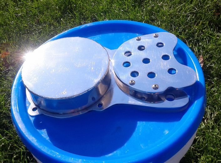

another member made this for me, THANX BRO !
we'll let him "out" himself if he'd like to, or not to keep from getting unwanted requests.
.190 6061 aluminum with built in case saver :)........

When do we get to see pics of that sexy Stator cover on the blaster? I feel like your teasing me! lol;)

install the purdy stator cover which will require the clutch cover to get polished also,
