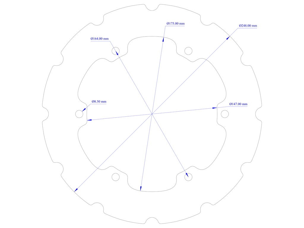

Quick picture of what I have so far. Green dotted line is OD of the sprocket, Blue dotted line in OD of the chain on the sprocket.
Reactions: colescustom
Here you go. From what I can see online they make them out of 6mm thick aluminum. Some make them out of stainless. You will need to make spacers and get longer bolts.
PDF: DOWNLOAD
DXF: DOWNLOAD
Designed for the 40 tooth sprocket.
