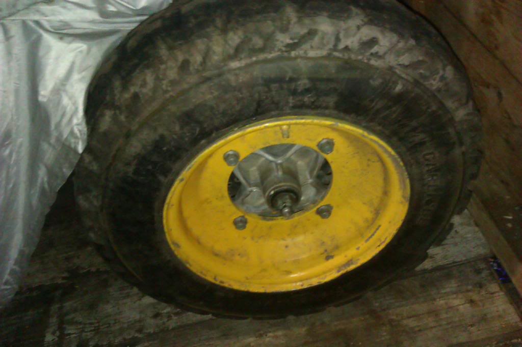

Hi guys anyone got a close up picture of the front hydro hubs with rims mounted? just i think mine have been cut before i bought them and want to make sure before buying others.

just when i tighten them it seems like the nuts don't go very far before there up againest the rims.

ah the nuts are flush with the end of the threads. they don't look like they have been cut but you never know. il get sizes tomorrow and check back :D just hope there not as il be contacting the seller i bought them from as i already spend more than i should have lol

not entirely sure buddy about hubs as i got them in a hydro conversion kit. i just have the nuts on them. also thats without the metal plate thing.. il double check and get a pic tomorrow of the hubs. knowing my luck they will be warrior hubs lol
just found my problem through google images and threw a picture i took of my hubs. appears to be warrior hubs. will this make a difference? or will i need the correct ones.
I think you are going to be fine.
My hub studs are pretty much flush with the nuts too, although I have thicker aluminum rims.
Many Yamaha front hubs are the same, interchangable. Your Warrior hubs will be fine.
