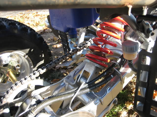

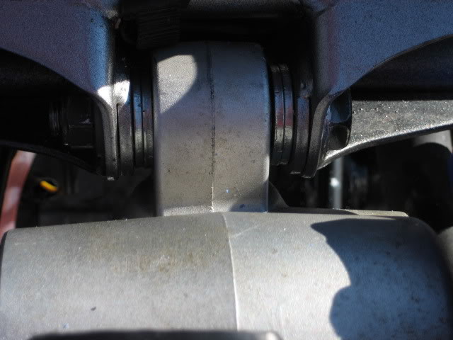

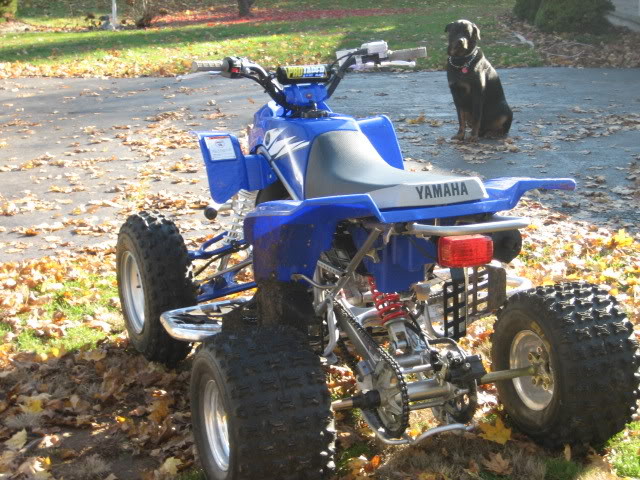

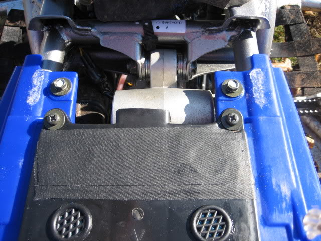

Got it all together!! Time for a ride!
Started cutting the fenders too. Still need to smooth them out.
Thanks to everyone who chimes in to help and greatly to those for the pics and ideas.
I:I Fawken SWEEEEEET!!! I:I Best mod yet....besides power mods of course!! Well......18" rears were the best mod I think too. Also it's much better with the little lady too!! It sits a little higher (which also looks badass) It's fully adjustable for the conditions you ride that day for example compression, rebound and preload. *NOTE- what alot of people don't know though is that even the stock Blaster shock is preload adjustable (from the bottom) which even that makes the stocker more bearable to deal with untill upgrade. However, even with the stock shock's preload cranked up, if my 210 butt sat on the rear grap bar for instance....it would be completly bottomed out. But now with the 400ex shock, I can't get it to bottom if I jump on the rear grab bar. It still has another inch or so (at least!) of shock shaft visible!! Of course, this is just a stand-still example and representation of just how much better this shock is to bottoming with such smooth resistance compressing AND rebound!! You can just absolutely notice the quality w/ NIGHT & DAY difference!!!!!!!!!! So to sum it all up.....the ride is just awesome to what it was. DO IT, DO IT NOW!! I:I
