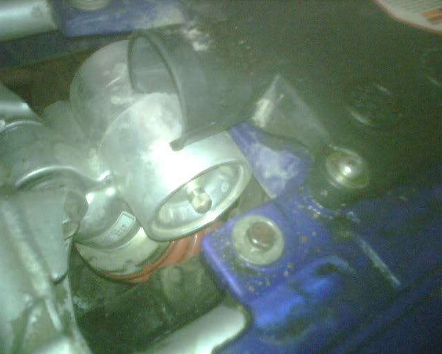

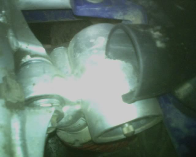

HEY! can i get an acurate measurement from the center of the bolt to the very back of the shock(the furthest point to the rear of the bike). also a measurement from the flywheel side of the rez to the inside edge of the frame dirrectly beside it(checking clearence for the downtube to the carb) i need to see if this will hit the f7 airbox.

Is the airbox lid snorkel base ALL we have to trim?

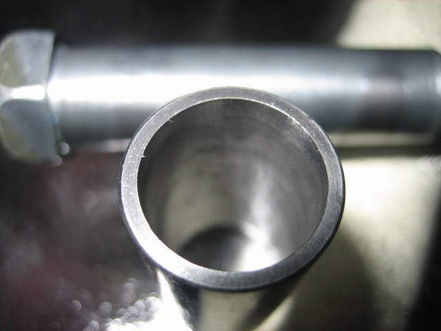

Pics of 400ex bushing bored out to 9/16"

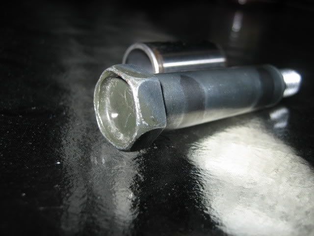

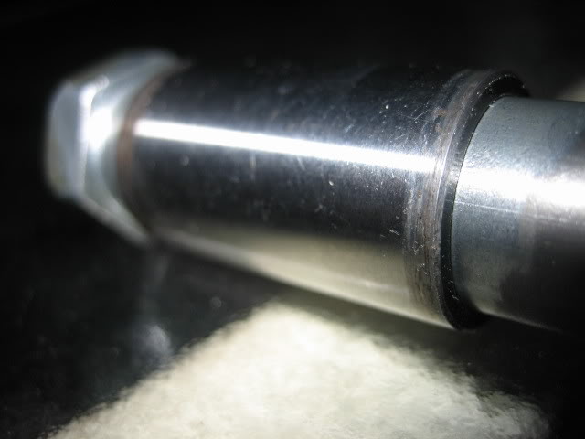

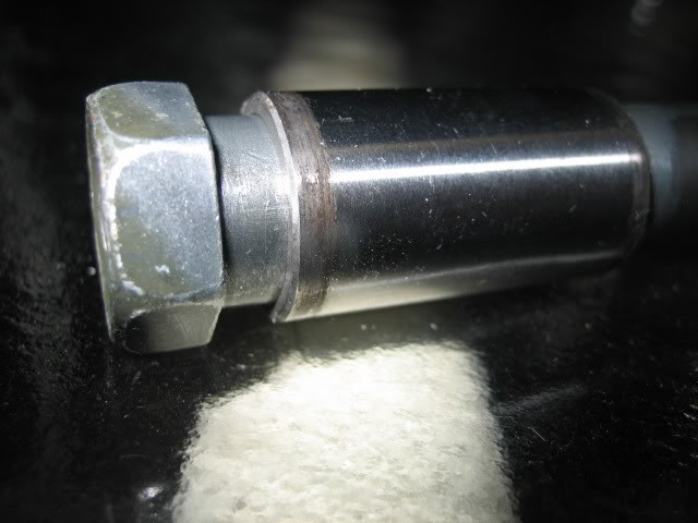

Just got the bushing back!!! He had to put it on a lathe while a fixed, stationary carbide bit came in horizontally to remove the material, creating the larger inner diameter. Then honed it smooth. He mentioned once the surface is removed (which is the hardest from the heat treating or case hardening....whatever), it was easier, i.e., being able to hone smooth the i.d. It's ALWAYS good to have a great machinison hand. The place is called A & M, in Meriden, Connecticut. It feels like he did it to 9/16" instead of a TIGHT 14mm. Probably better so that the gease doesn't scrape out when sending the stock Blaster bolt through. ......I'm VERY pleased!!
Here's some pics:
Original Blaster upper shock bolt.
Bored 400ex bushing.
All together nicey nice!!
