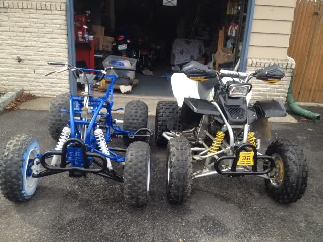

350$ 2001 Blaster

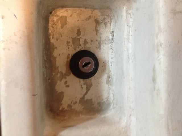

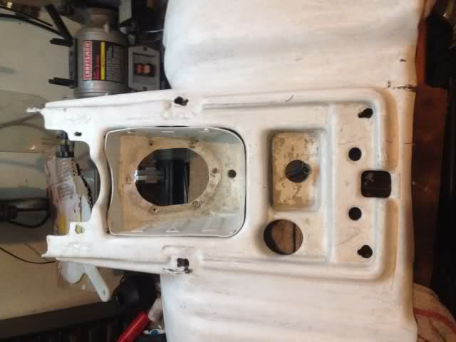

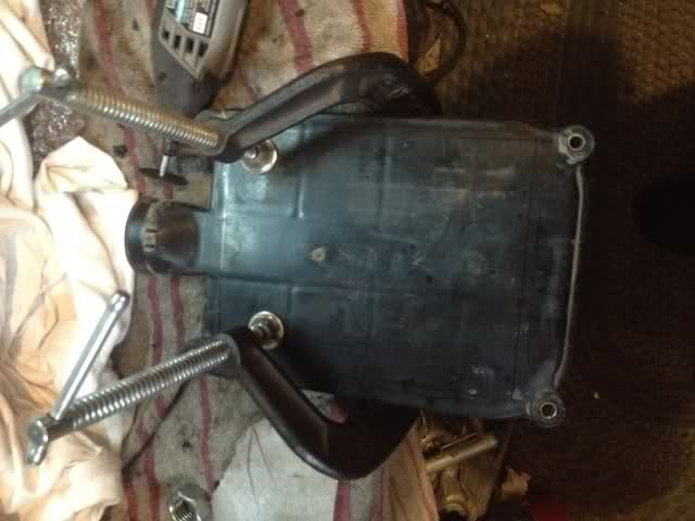

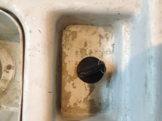

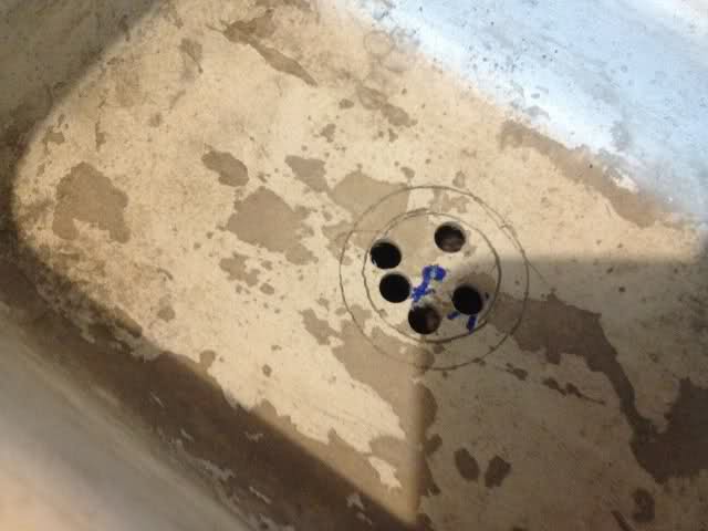

relocated the key to under the seat..
First i measured and used a compass
Next i used a drill and a wood drill bit to start off with holes.
Then connected them and evened it out.

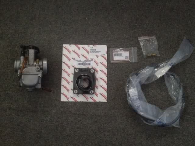

trx 250r carb is on the way
throttle cable
intake manifold for 34-35 mm carbs

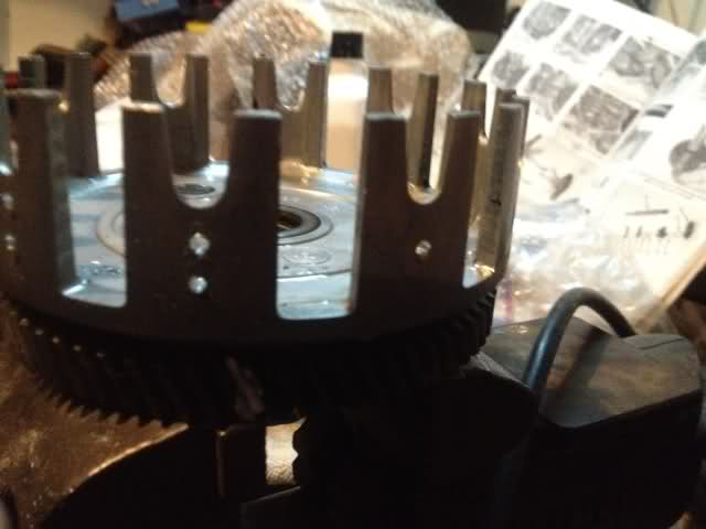

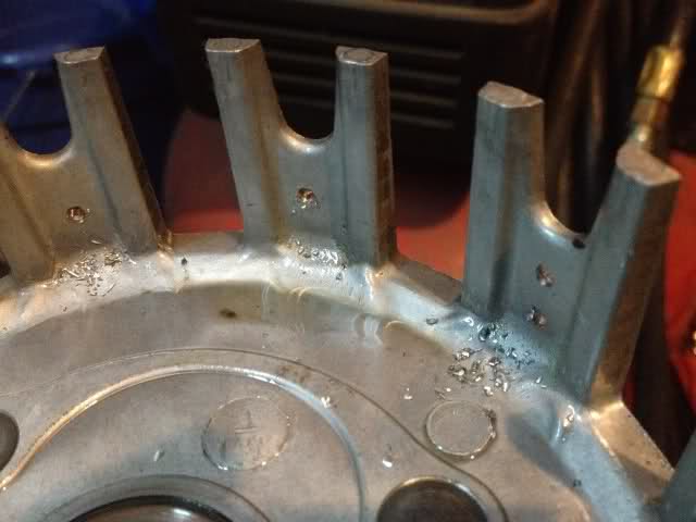

in the next few days im going to do the clutch oil mod. drill 2 holes in the outer clutch basket to allow more oil to get to the clutch plates. will post step by step pics..

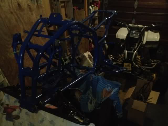

heres some pics of what ive been doing

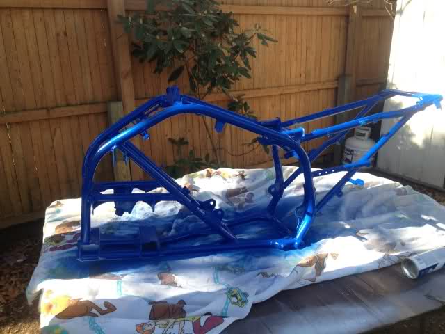

Frame is deep gloss blue by rostoleum

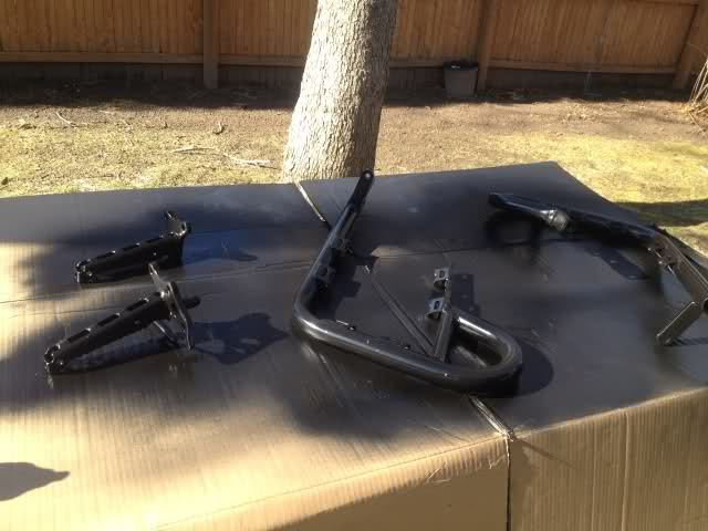

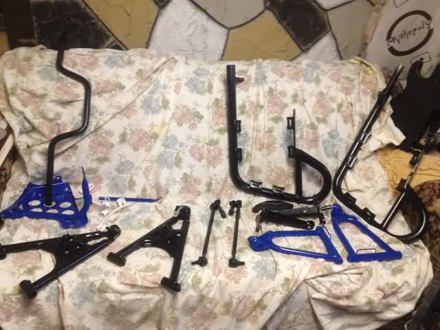

some parts that are painted black

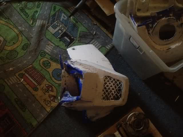

plastics with automotive bondo to get out scratches... ready to be sanded then painted..

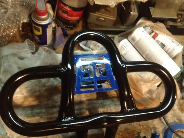

DG front bumper painted the blue and black.
watched a KOR bottom end rebuild vid and he showed this cool little mod to allow more oil to get to your clutch so i did it!
drill a 2:1 pattern around the basket and at the end you will end up with 2 2s or 2 1. ex 2 holes then 1 hole then 2 holes...

Some parts painted and ready for clear coat...

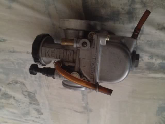

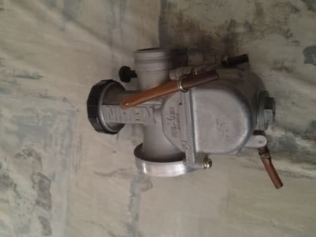

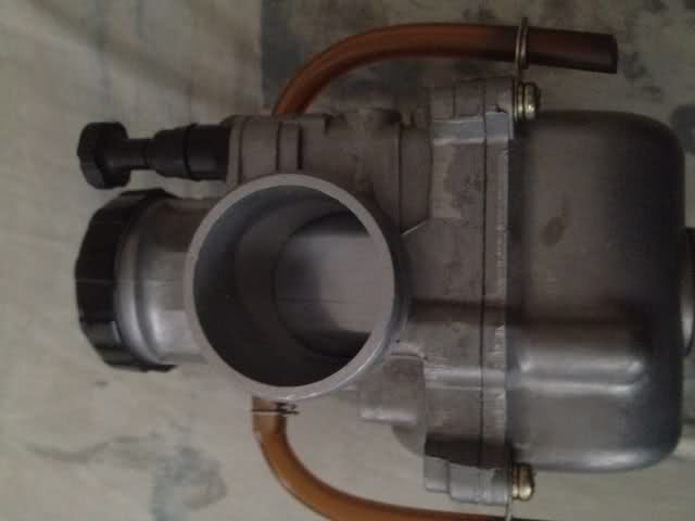

Some parts i have gotten in the past week or two.. Trx 250R Carb 34mm (Thanks awk08 For finding this for me) intake manifold 34-35mm carbs, throttle cable, jets and needle

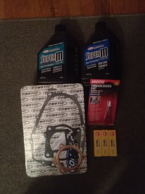

Parts I got in today!..Gaskets, oil, loctite, spark plugs, main jets, pilot jets

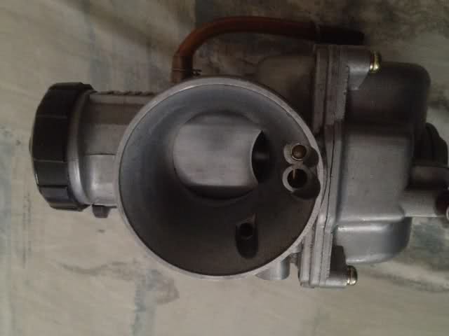

Go the Trx 250r carb apart and put in a 165 main and 45 pilot to start off.

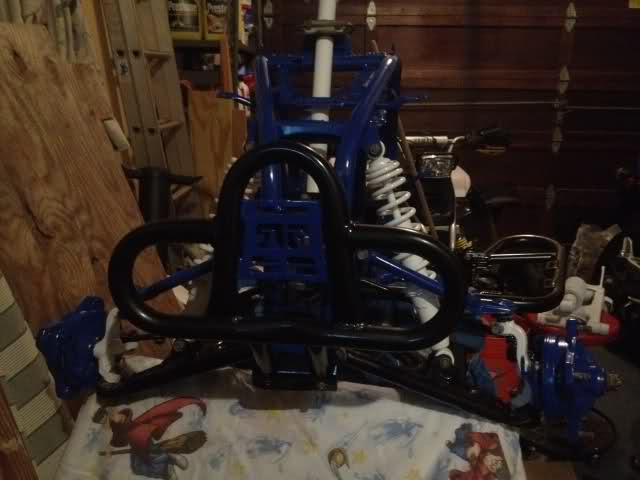

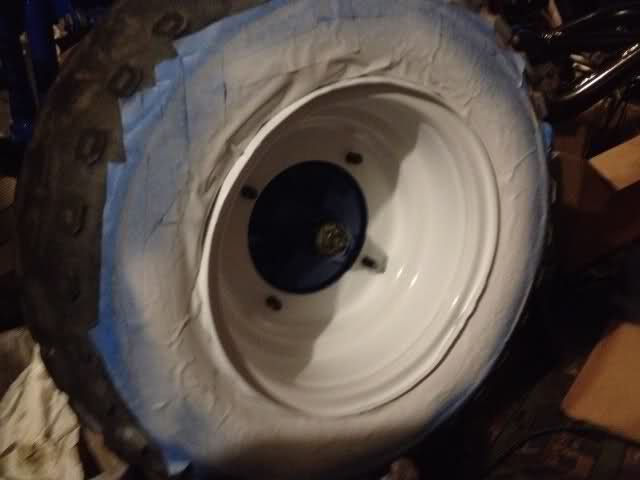

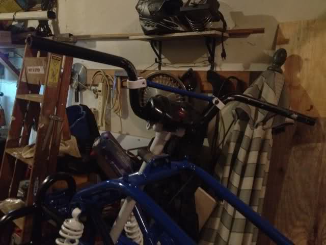

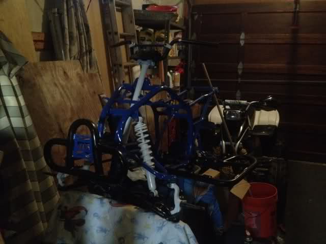

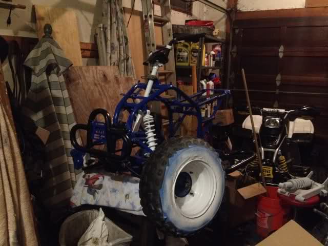

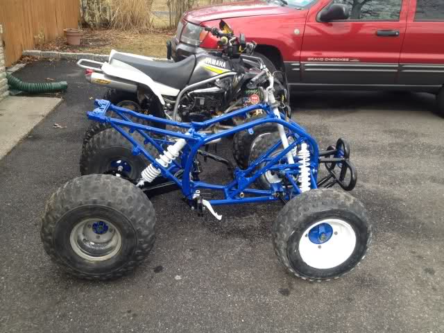

some updates...got the whole front end ready...finishing up painting the rear shock, hubs, carrier, and swing arm, and plastics then it will be a complete roller....waiting on my new case bolts from motosport. taking forever... got my cylinder, piston, and gasket set back from ken... will post pics in a few..
here it is as a roller... bottom end should be coming this week from ken..should be all done this weekend.. couldnt get one of the case bolts all the way in so i gave it to ken to do it right. will post pics this weekend as it is currently at a relatives where i ride it...
