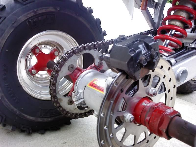

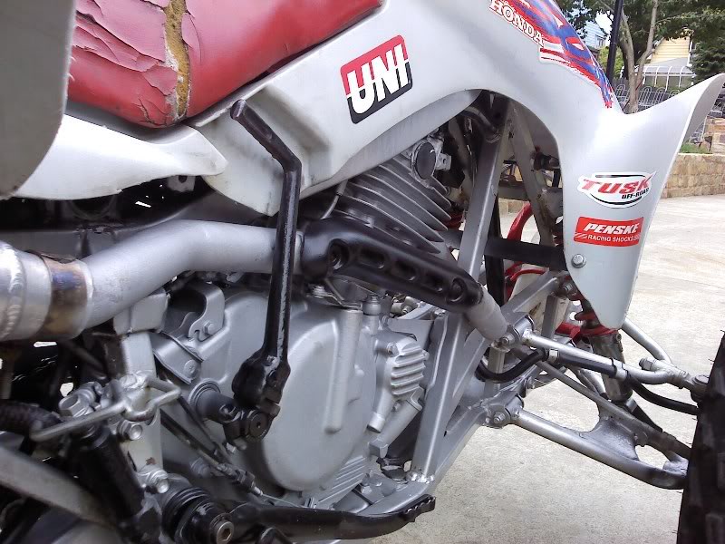

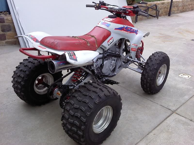

well i restored this quad about a year ago now.. since then lots more done to it including:
trimmed plastics
new tires
coffmans race exhaust
new brakes
new rear rotor
new handlebars and grips
new swingarm bearings, wheel bearings, shock bushings..
found out the motor has a cam and piston I:I
only thing left is that damn seat! but got the material waiting on someone to cover it hahah but it wll be done!

thanks man and i knoow hahah i actually have the same red vinyl material, found a piece that will fit it at a crafts store for $2.50! just gotta get the dame thing on, today after i finshed replacing all those bearings and rotors and all i went to ride and the motor decided to sputter and breakup bad so now it sits yet again as i figure this out =/
just try cleaning the carb out and stuff if its been sitting.
and it looks really good man, should be a decent trail machine
thanks guys! i just redid the seat today, not an easy seat to recover but its much better than it was! ill get pics up of it sometime, now i gotta figure out whats wrong with the damn motor..
and that sucks just cause, they are very funn quads def hard choice between it and the blasty because its soo much better for the trails
thanks alot guys! but nah i dont wannt a bumper or anything else for it as of now, i wanna keep it running good and keep it clean, eventually im gunna want a bigger more powerful quad of some sort so i dont see the need to dump more money into this than i need to hahaha
