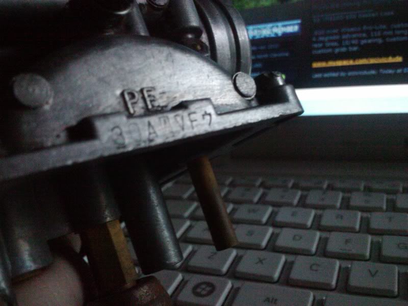

Ok, I decided to snap a pic of the side of the carb, I cannot locate the model number online any where - on the side it has PE and 30awvf below that.
On the smaller side it measures 31mm, according to Keihin the closest is a 30mm and it would be a 20, 22, or 24mm found here: Carbs
I am a little confused as what carb this is, maybe the guy I picked it up from was wrong in saying its for a 250r?
The inside diameter of the carb throat on the engine side is 31mm?
I didn't know they made anything other than a 26mm PE (only because I've got one)
I don't think the 30 is the model number... only the serial number.
If that carbs for a 250r then it must be for an old air cooled trike and not the liquid motors. Honestly if your running a ported 240 bbk, don't bother with that carb. Either get yourself a 34mm pj or 35mm airstryker
The PE series carb isn't related to the PJ series but they are similar (like how a PJ and PWK are similar but not related)
I've never seen one and have no idea what a 30 mm PE carb might fit, but older model dirtbike makes sense.

Well I just got the top end back from the shop tonight, everthing is looking good, went ahead and chambered the head since most everyone said it would be the best way. Had the shop take a look at the carb and he also said the carb was older than dirt. Looks like I am gonna be going with the stock carb with a jet kit, atleast until I get the cash up for a PWK or PJ, thanks for your input with this guys.
ps - the keyboard, does it look old? Its a brand new laptop with spaced keys for us that know 3 days in advance when its gonna rain... I hate the 'pain weather radar' from riding since I was 4yrs old but Im sure Im not the only one.
