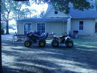

Well got a new toy with a blown top end all stock for 300. ruff but can be fixed. It has a good frame and is all stock front brakes work better than man and i have adjusted it. Also the frame has no bends crack or welds unlike mine, I think i might put all my aftermarket stuff on it and rock this depending on year of frame etc. Heres a few pics just goin back to stock unless i use this frame and motor for my build. This thing has never seen soap there is grime everywhere! It has no front or rear fender brackets etc just unmaintained the reedcage/manifold bolts were finger tight with grime around them assuming that was a air leak. The guy said he was 6th wot and it blew so hes a dumbass.

Well i got tired of the other one figured i switch to this one for a bit. I Painted the hood and tank cover white and painted the frame a lil to clean it up. Also i painted the grab bar and bumper black. Heres a few pics. The front fenders are just sittin there since ill have to take the exhaust off to do a leak down test anyway cause it needs crank seals.
Painted the kicker thumb throttle and the clutch cover.
new seat
