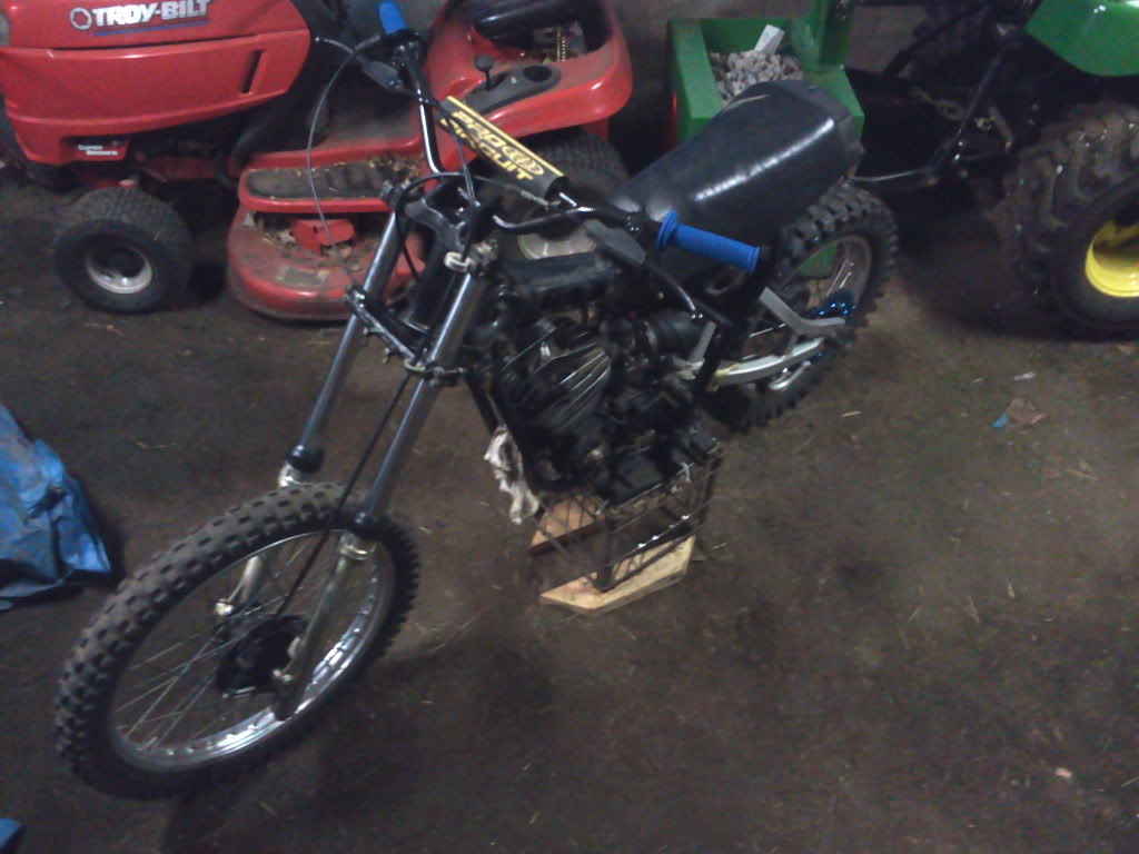

1979 yz250 for 100 bucks :D

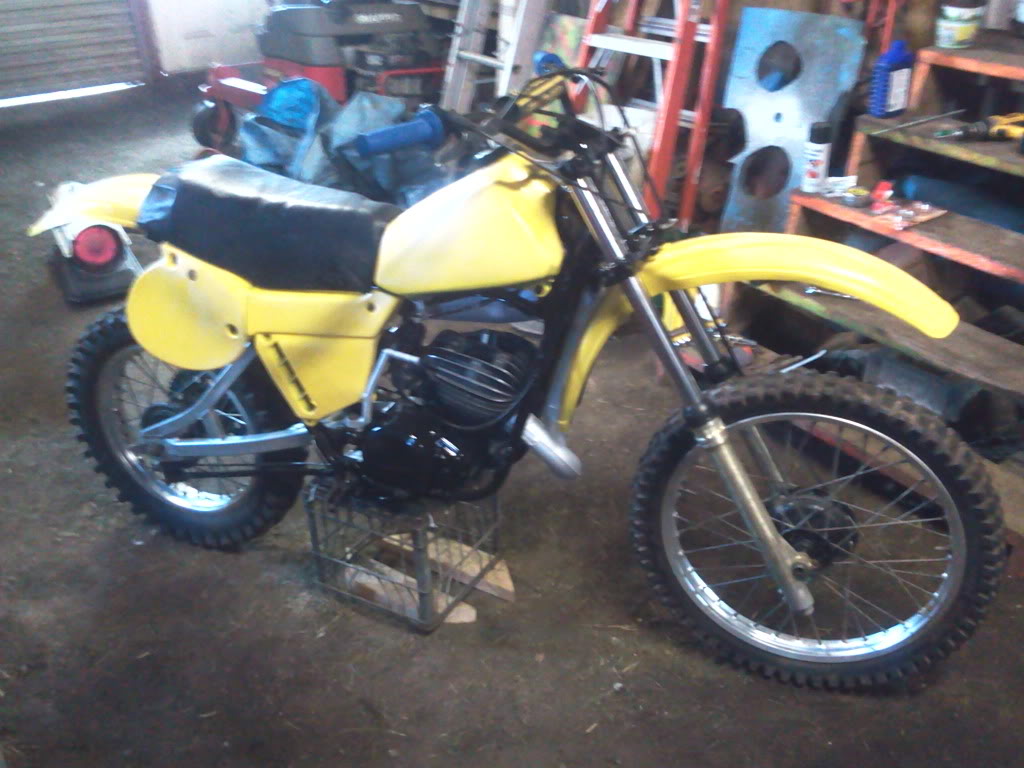

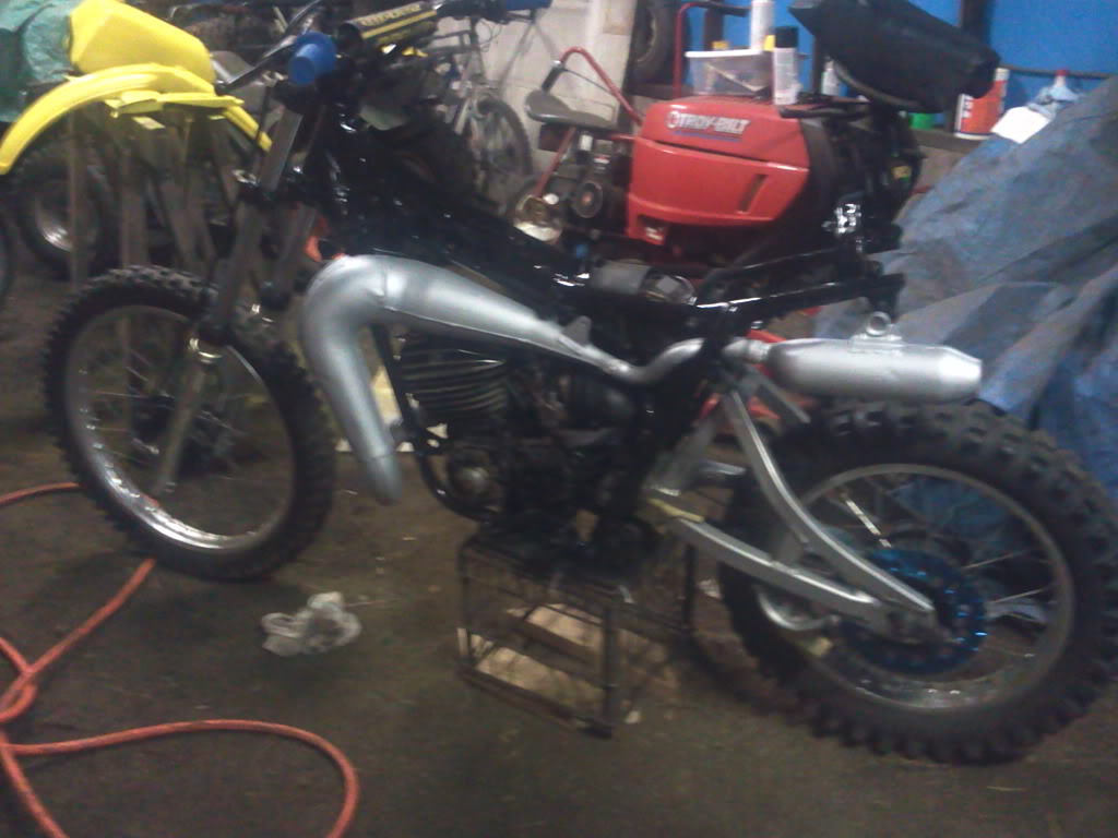

did some more stuff tonight, removed the crappy old fork covers, the seals on the forks look fine, a tad bit of oil on the left side seal, the right looks new, put new grips on and painted the bars, primed the pipe and silencer.....
i was lookin, some of the electrics are newer lookin, and the right side fork looks to have new seals, like someone started restoring it, or sumthin, the airbox boot is newer too, i might pull the left side fork and do the seal, anyone have any experience on doing fork seals, is it hard to do?

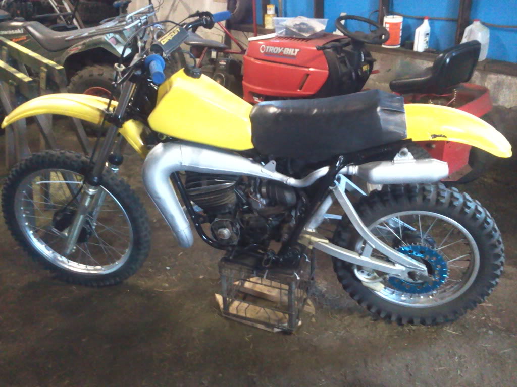

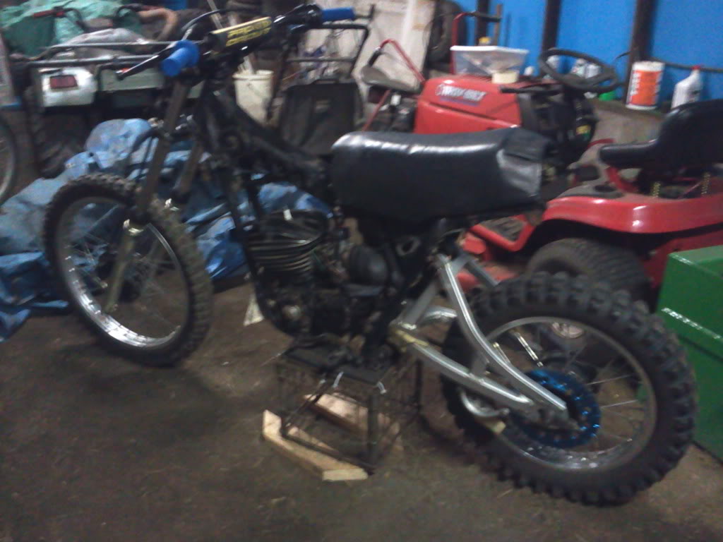

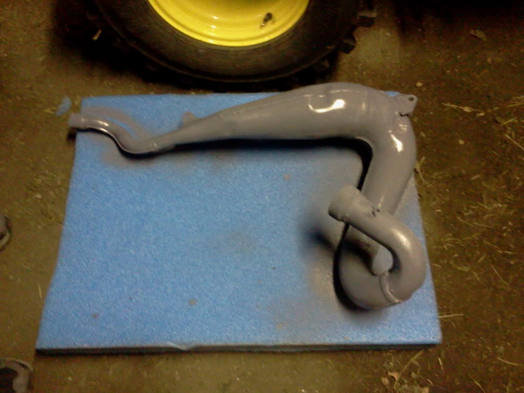

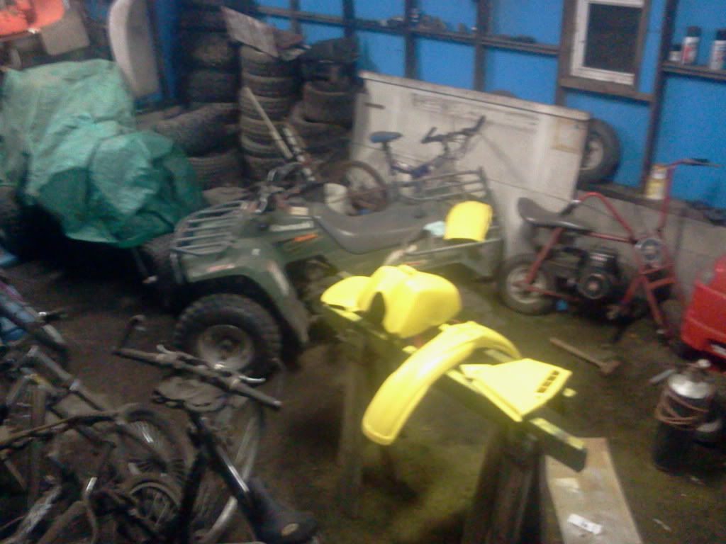

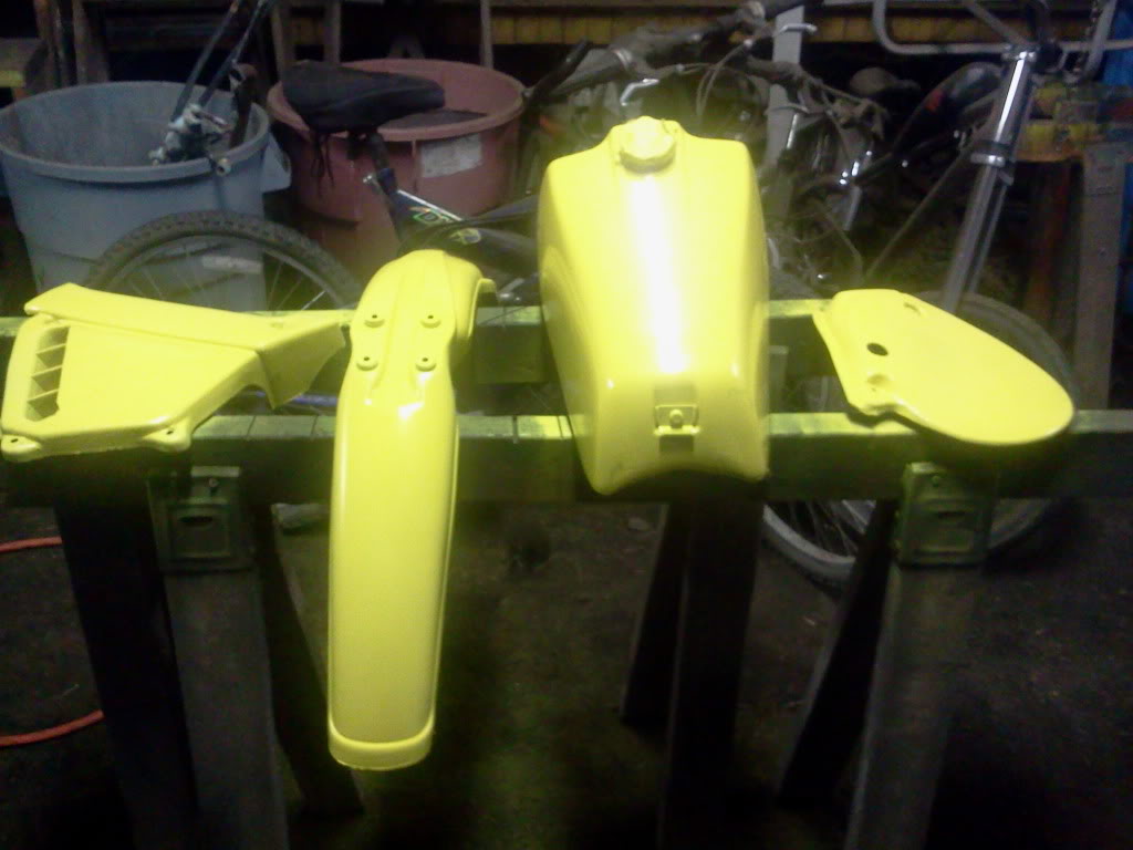

finished priming the pipe and silencer with heat resistant primer, now i'm gonna pick up some heat resistant silver paint ( i don't like dull old black). i'v decided that the plastics are in such bad shape i'm gonna go ahead and dry sand them and use some yellow krylon on them( the yellow, from what i'v been told, is the same as the stock color). i'm gonna try to get the gas tank better lookin tho, cause i rlly don't wanna krylon the tank.

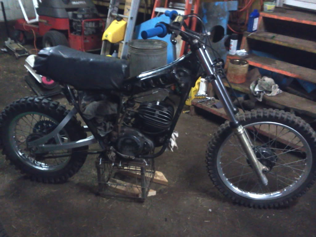

Well, went and did some more cleaning on the bike and found that the swingarm bearings are shot, but that's fine cause I gotta take off the swinger to put on a new roller for the chain anyways.
I was just about to ask you about this. That pivot can be a pain to remove when they are 30 years old (or even 10). Sometimes all they need is a bit of heat and some bashing with a large hammer. Other times you have to cut them. You pretty much have to jam a sawzall blade between the swingarm and the frame then cut the bolt on both sides then you can use a press to push out whats left of the bolt.
