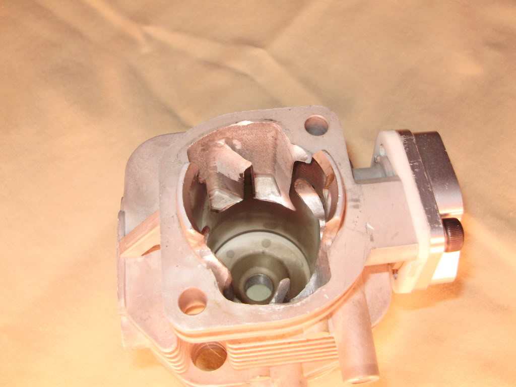

Great lookin work Freek, as usual ... ... Do ya have enough surface for the ring ends to ride on?
thanx otis...u lost me tho, the ring ends line up in the middle of the intake windows...do u mean above the transfers and below the triples?
call me stupid but r u actually drilling out the head to make the other ports then
He is taking a drill to his cylinder to make more ports.

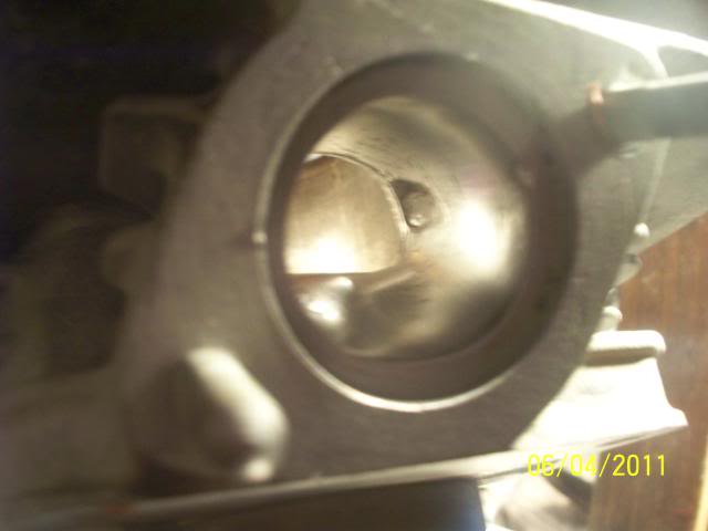

Just curious freek, you have pics of the exhaust side so I could see where they come into exhaust or am I looking at this wrong?
Great modding as usual freek, you can't leave a single part unmodded.....hehe
Looks sweet bro.Looks 100 times better than the one cylinder I sent you,bahhahahahahah caveman style!!!!! Ride report is a must!!!Great job brotha.
i have no doubt it will impress even the hardest critics.
Nice work Freek, looks good brutha.
Very curious on the ride report with those boyesens and triples, for sure.

well guys im waiting on a call from the machine shop, he is boring the cylinder and doing some head work for us.. i thought it would be done today but i couldnt get in touch with the guy...im gonna stop by tommorow, with a little luck a ride report will be sunday...mabe some vids lol
