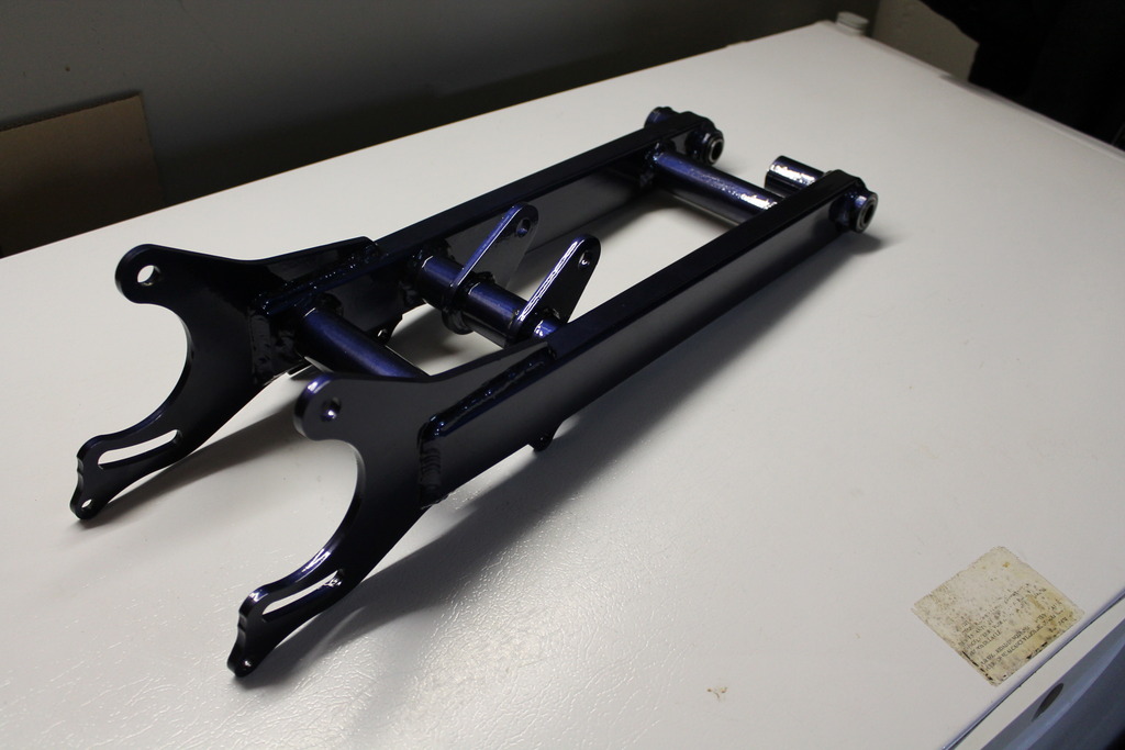

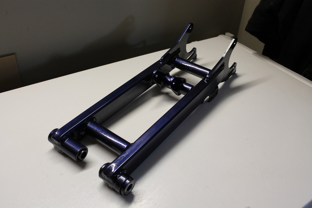

Hope so. Will get the wiring all ran tomorrow and put the chain on. Might powder coat the swinger tomorrow so I can put the bearings in it.
