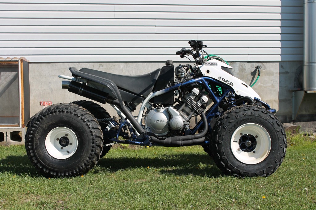

Looks really cool from the distance tho! Will plastic colors be matching it?
Yea I'm thinking of doing the tank to match. The front hood will white and the rear fenders black.

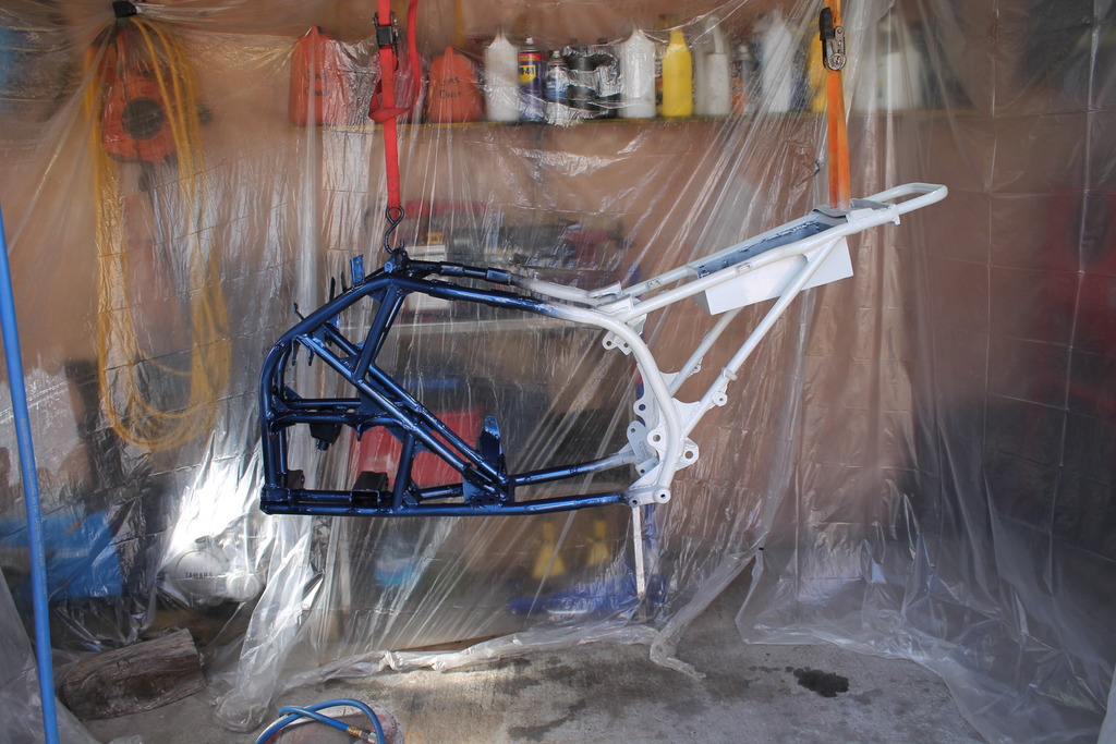

So I re-based the frame since itd been too long by the time I got the clear. I like the blending more this time around.
I really went all in with the Pearl in the clear, so much so that it tinted the black of the frame to a blue. Happy accident as it is an exact match nearly to the majestic blue powder I used.
It's much more pronounced in person but I kind of got the blue pearl in picture.

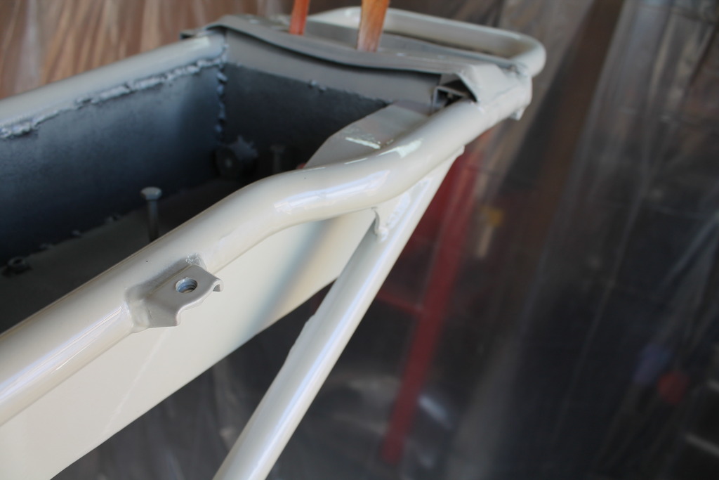

whats up with the chix sh*t welds/ splatter on the frame brace???!!!?? in picture 3?
btw keep us informed with this build. looks cool.
I never cleaned up the spatter from the flux core in some places.

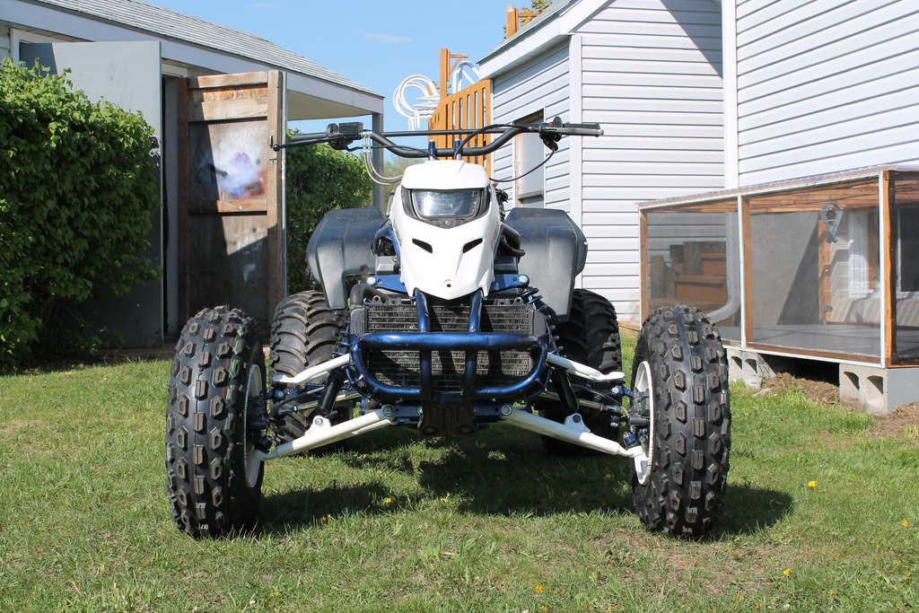

Nearly finished the fab work. I have to finish weld the front bumper and then all that is left for fab is to fiberglass the tank cover and gauge cluster.
I had to add these to the bumper to protect the corners of the rad since they stuck out and made the bottom likely to get stabbed with a stick. I'm going to add a steel mesh to go infront of the rad.
That bumper looks absolutely sick. Truly the best looking bumper I've seen modified/stock, or aftermarket.
Thanks. I like how it came out. Couldn't decide on coating it white or blue since I think the blue will hide the side pieces with the black rad behind it and I really like them but don't want the bike to be all white either. Went with blue as that was always the plan. It's baking now so I'll see.

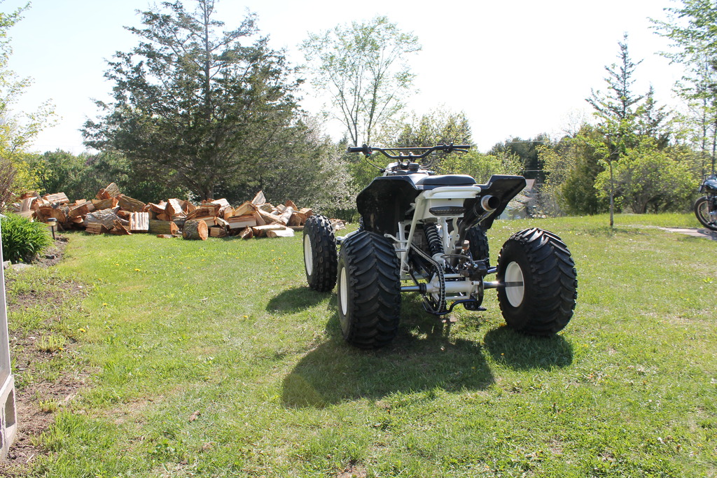

Got the new braided lines today. Took a bit of messing with the routing of the fronts to get them to fit well and not get pinched in anything. I'll make some tie-downs for them later.
I hope so. I hope these tires throw a big roost. Still waiting on my throttle to come in the mail as they only sent half of it the first time. Little wiring left to do and fluids but that's only a few hours of work. The tank cover and plastics will be last.
The bike is quite a bit heavier now and frame is longer so it won't wheelie as easily but we'll see. I'm still waiting on the throttle.
