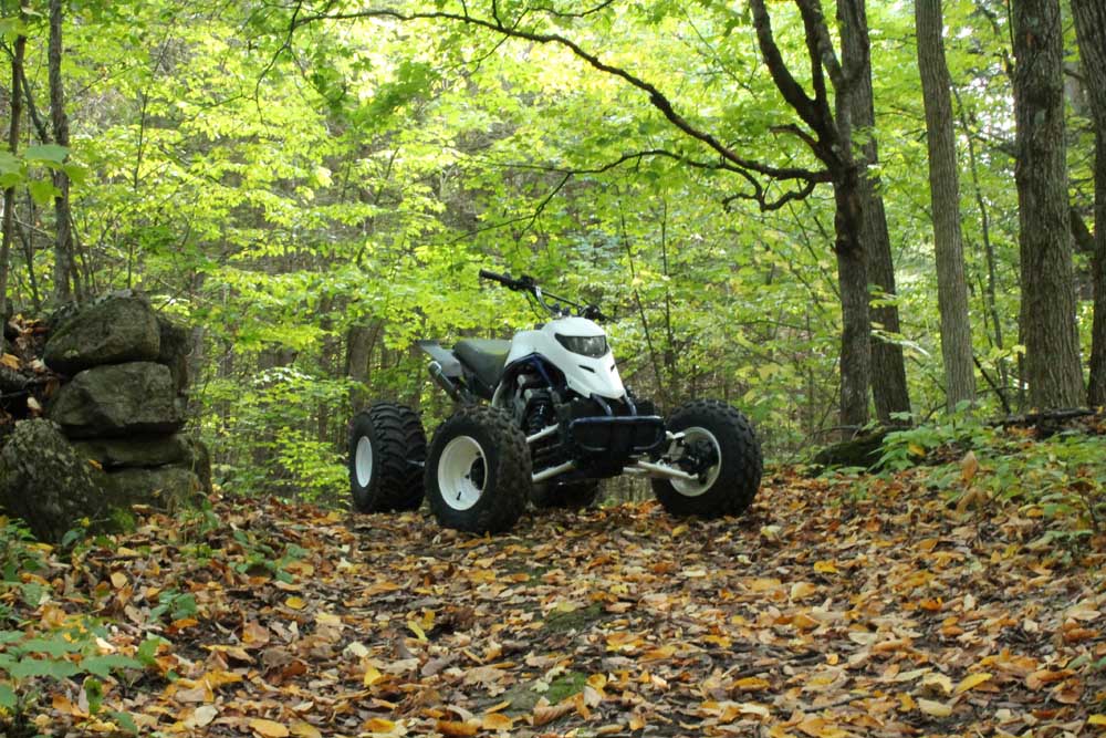

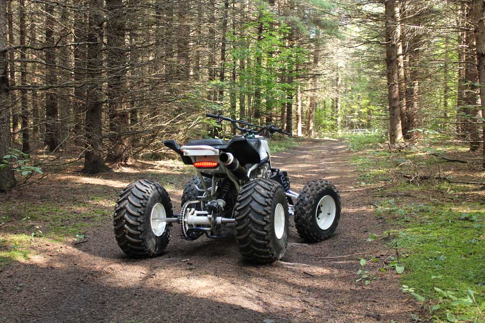

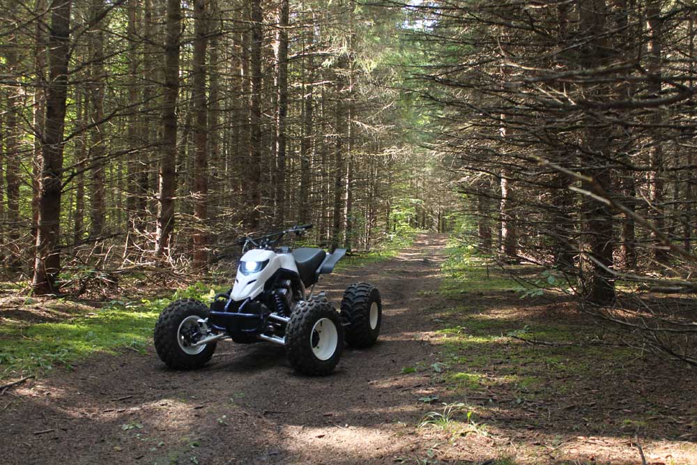

Took it to my in-laws tonight for them to try out.
Then went out for some trail riding. It works great. Need to make up a spring loaded tensioner sometime but not a big deal.

Thanks guys. Nice to finally ride it. I've got a few things left to finish up on it.
