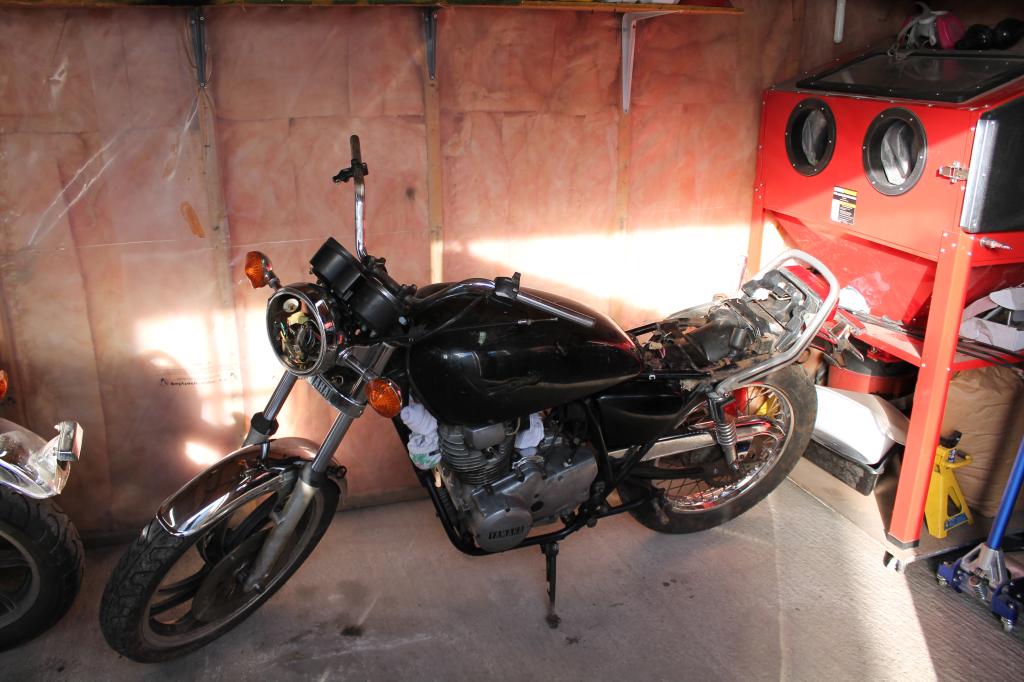

How we bought it on Christmas day:
I wanted to do every feasible part in powdercoat that I could on this bike, do a complete rebuild of nearly every single part and also do 100% of the work myself, from metal fab, wheel building and truing to paint, electrical and even sewing a seat cover.

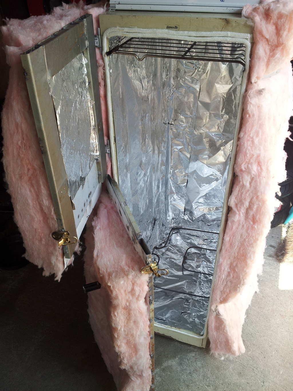

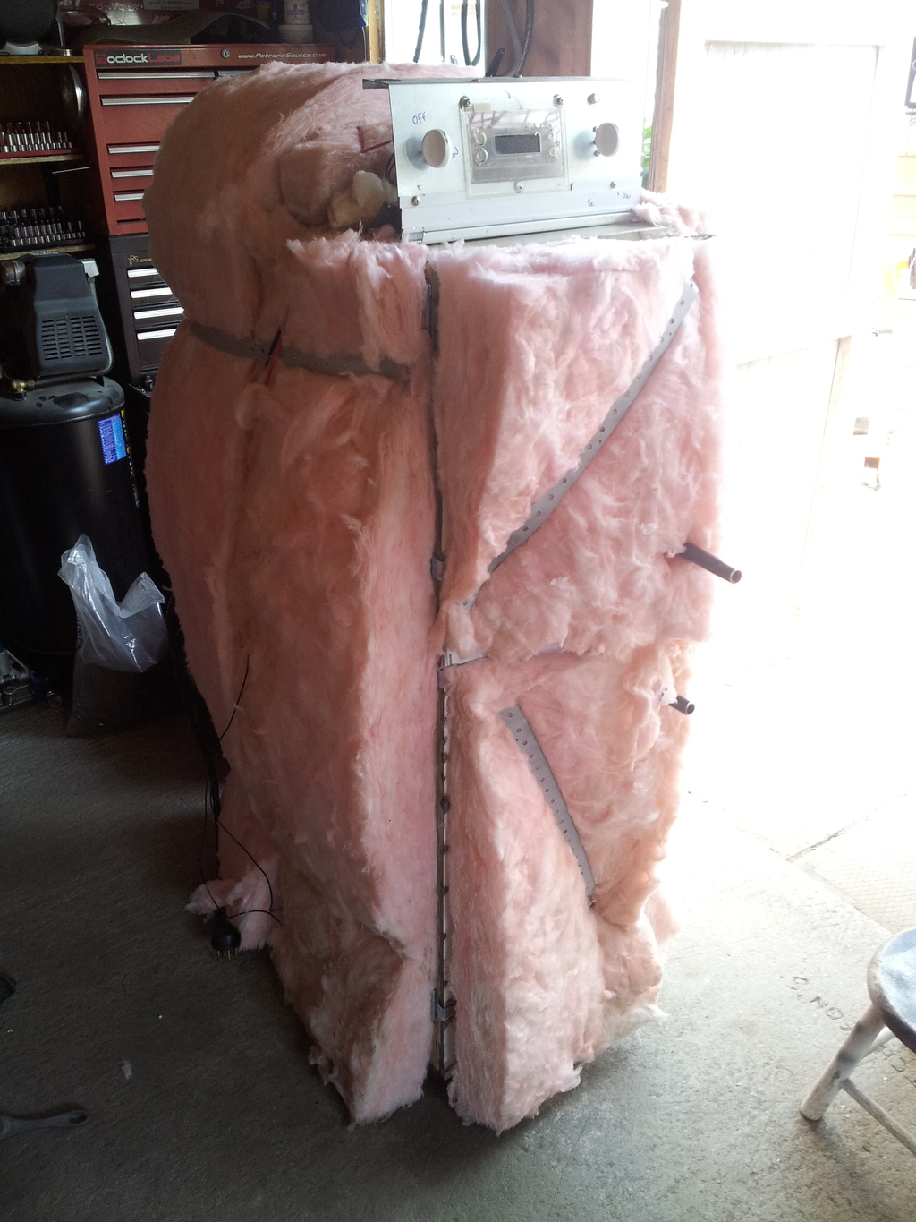

I had just started to do powdercoating for myself and this was going to be a good learning curve. Previously I had only been doing smaller parts that would fit in a regular kitchen oven I picked up for $20 which made it a pain so I decided I needed something bigger for this bike. Quick look on kijiji I found a $10 filing cabinet. Few hours later I had this beauty. Works great and heats up very quickly with the 2 elements.

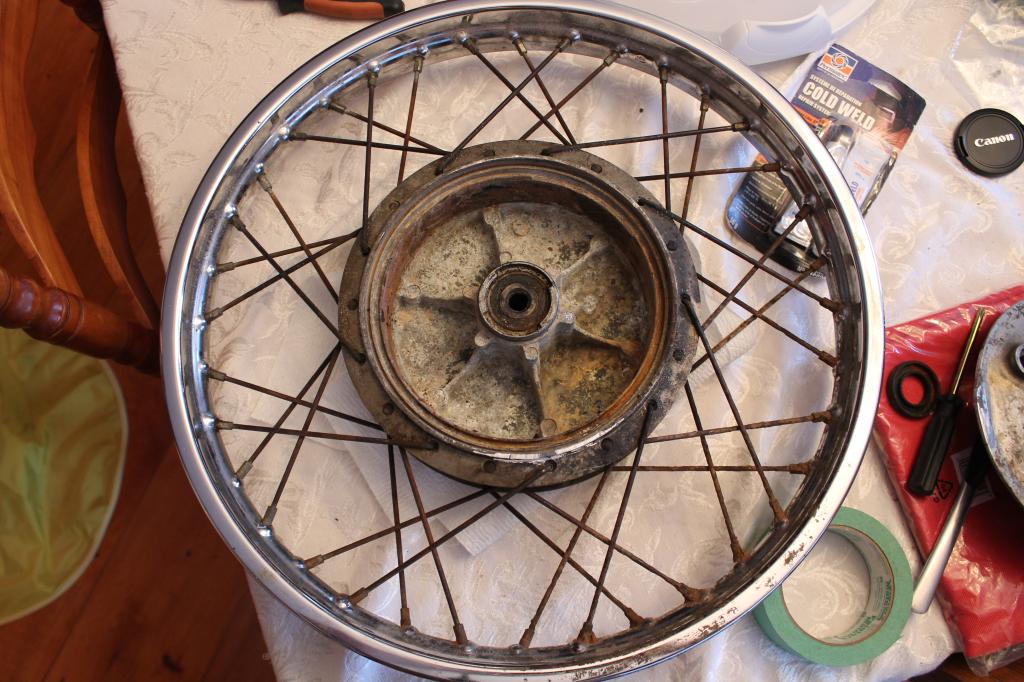

Blasted the old dirty rims and hubs and put some powder on them.
Go from this
To this with new spokes.

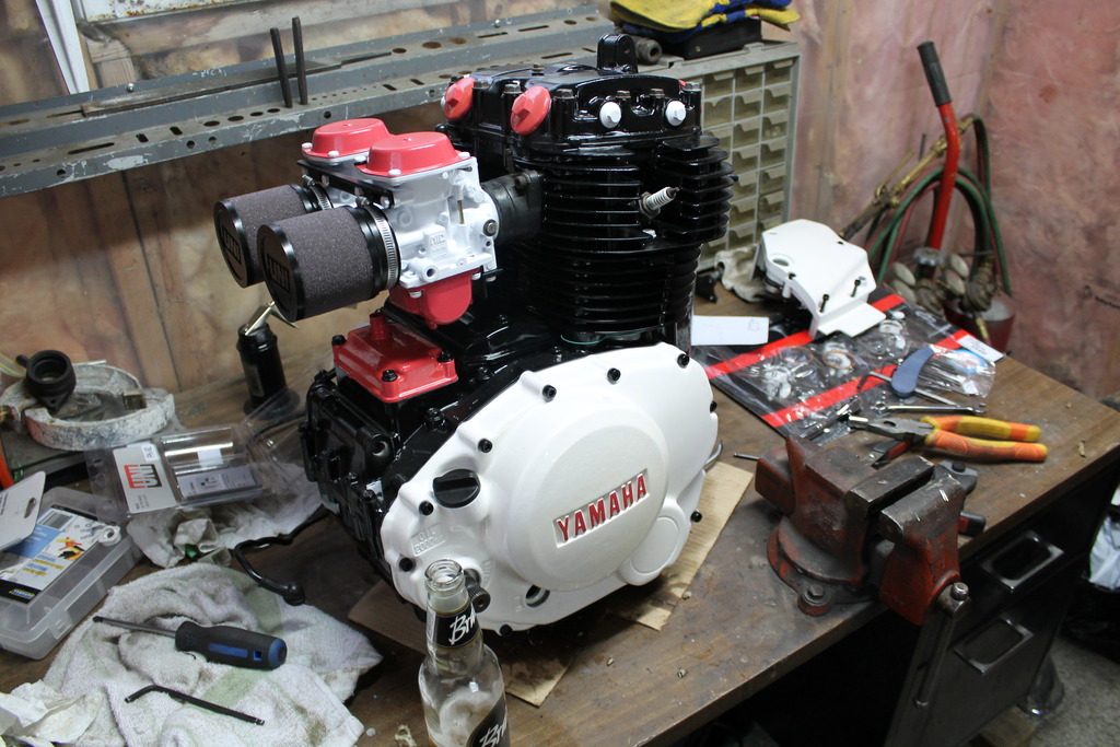

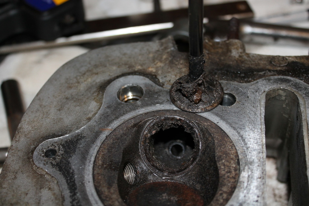

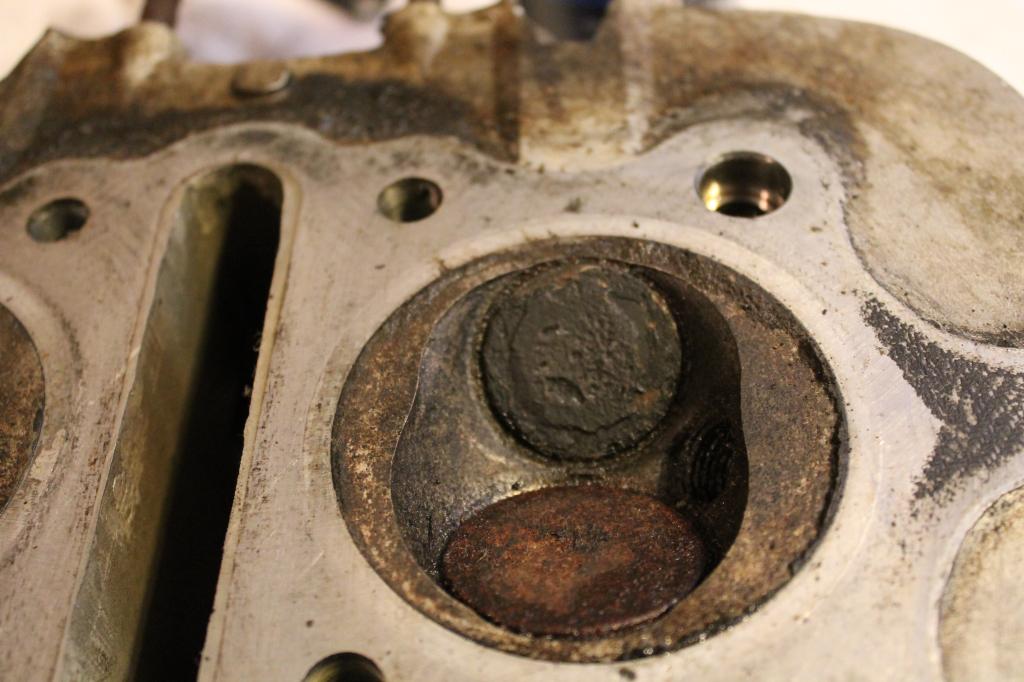

The engine had only 30 psi compression so it was time to rebuild it. After tearing it down the rings were completely seized in the pistons. No matter how much heat or soaking I did, the top 2 compression rings wouldn't free up. New pistons, rings, gaskets and seals were ordered.

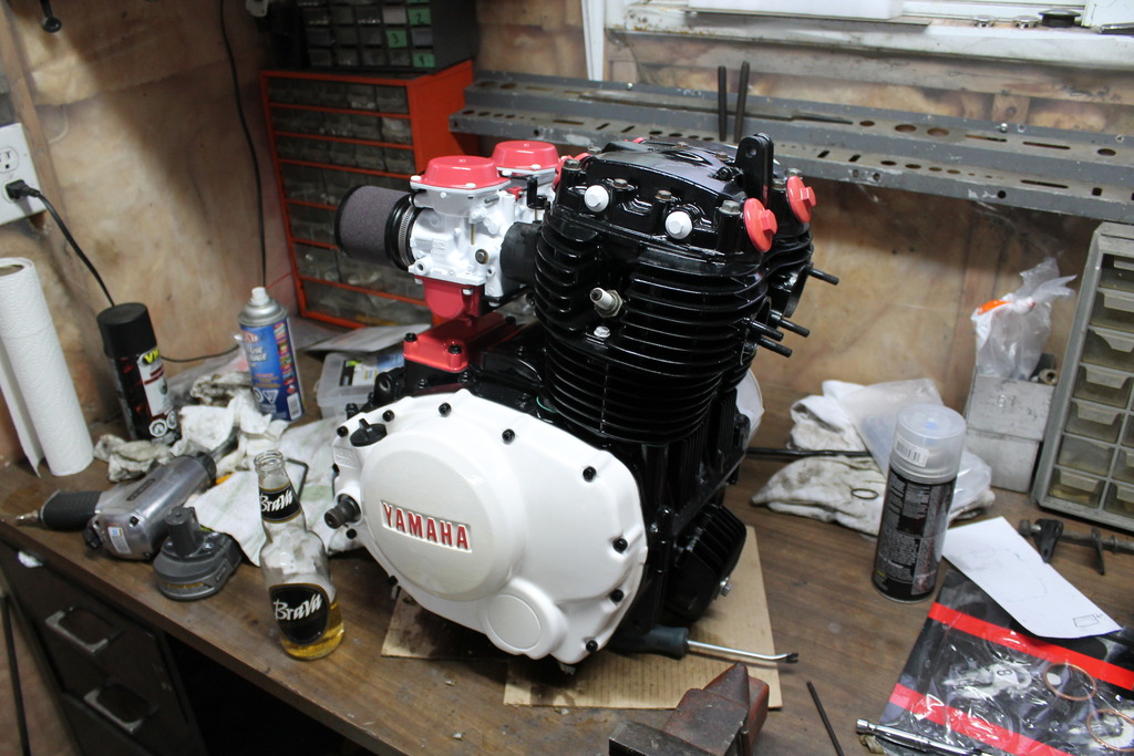

Had the bores measured and were still in spec so I just honed them as they had no crosshatch left. Cleaned up the ports and valves and lapped the seats. Luckily that's mostly all it needed. Then it was time to paint the engine, powder coat the cases and reassemble.
