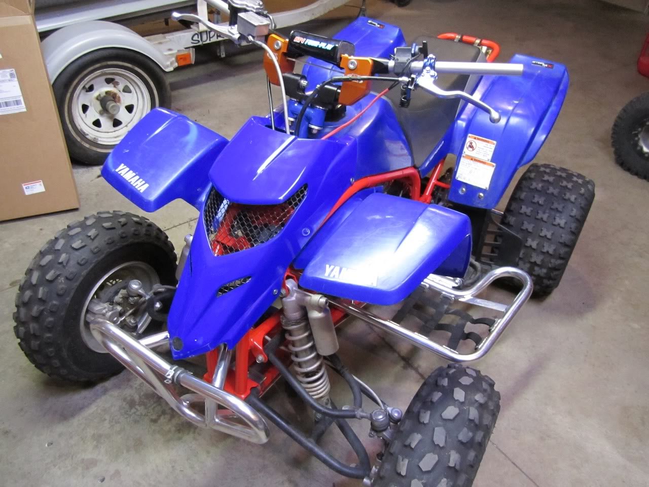

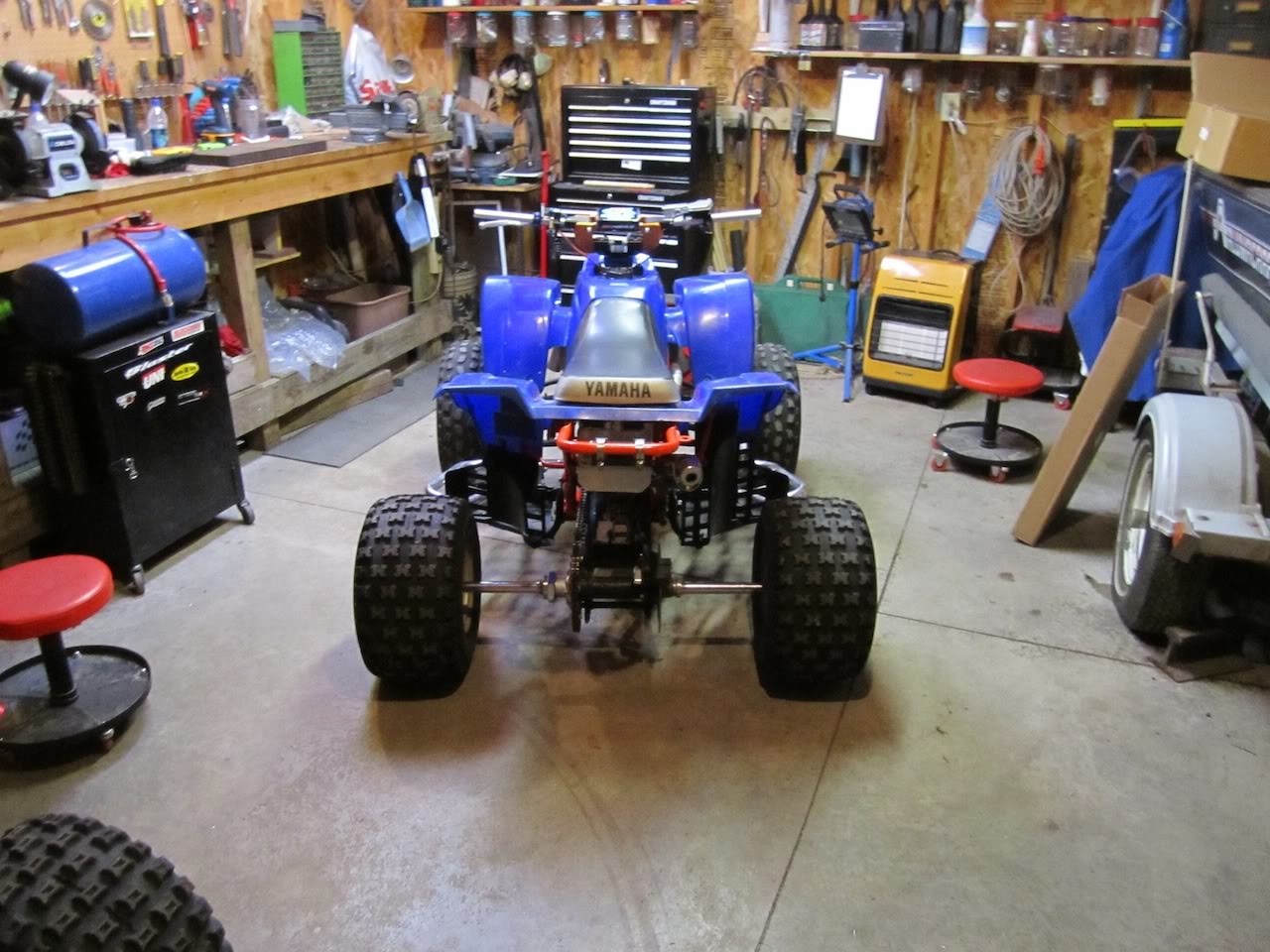

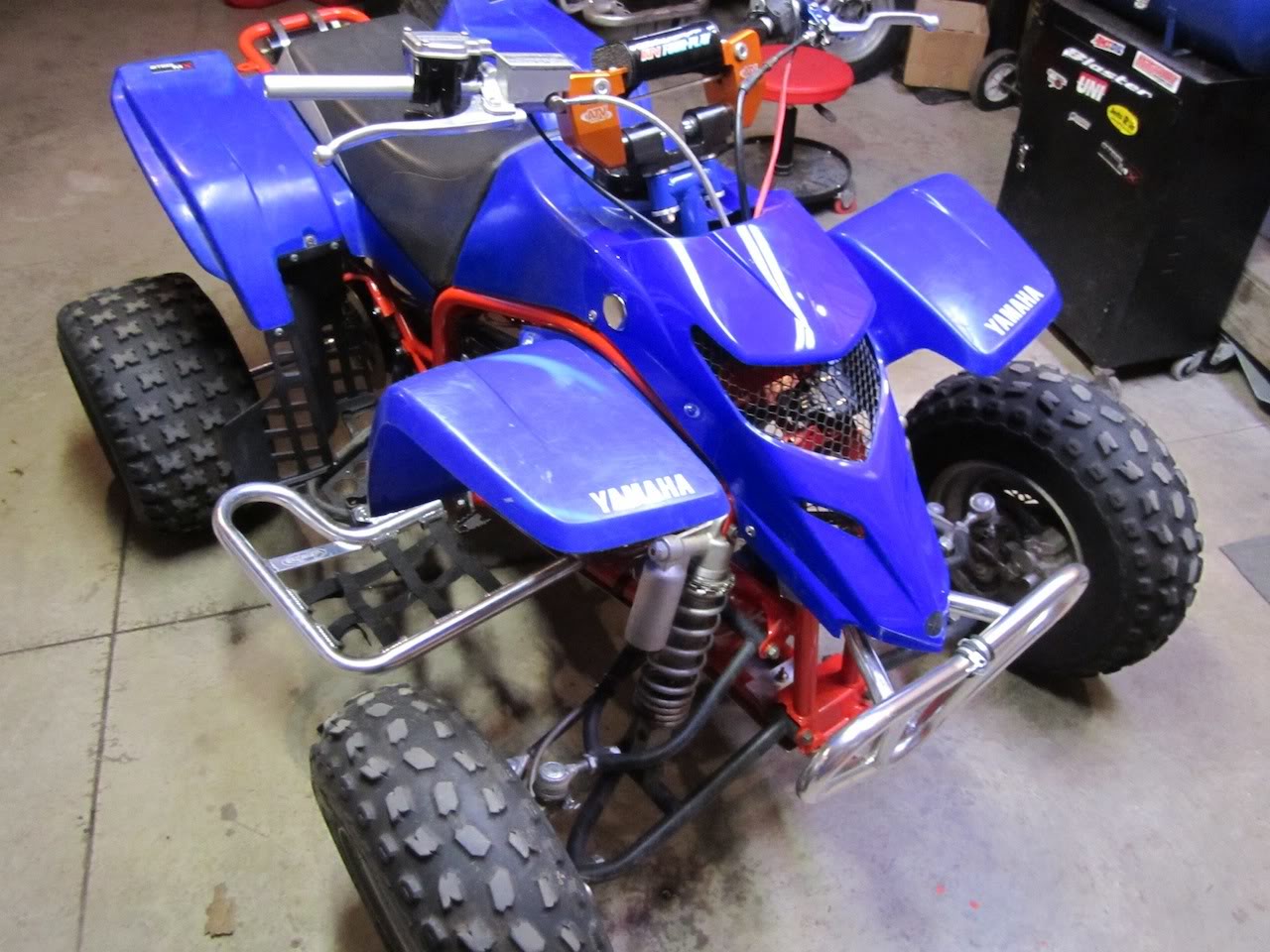

yz85 Blaster.
Nice job!!!! How did the engine match up with the rear mounts and swingarm...

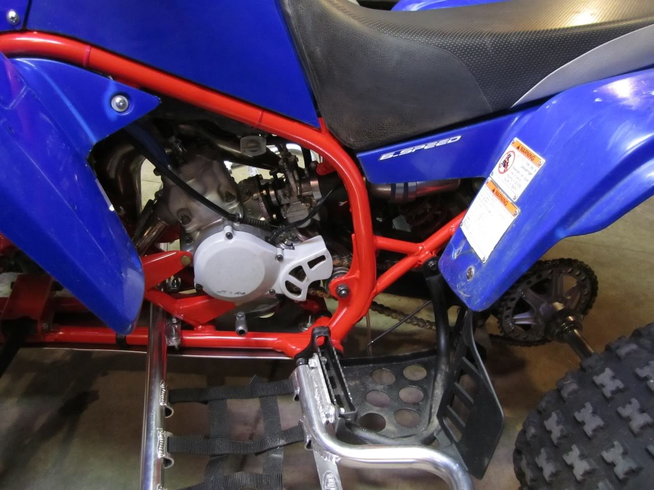

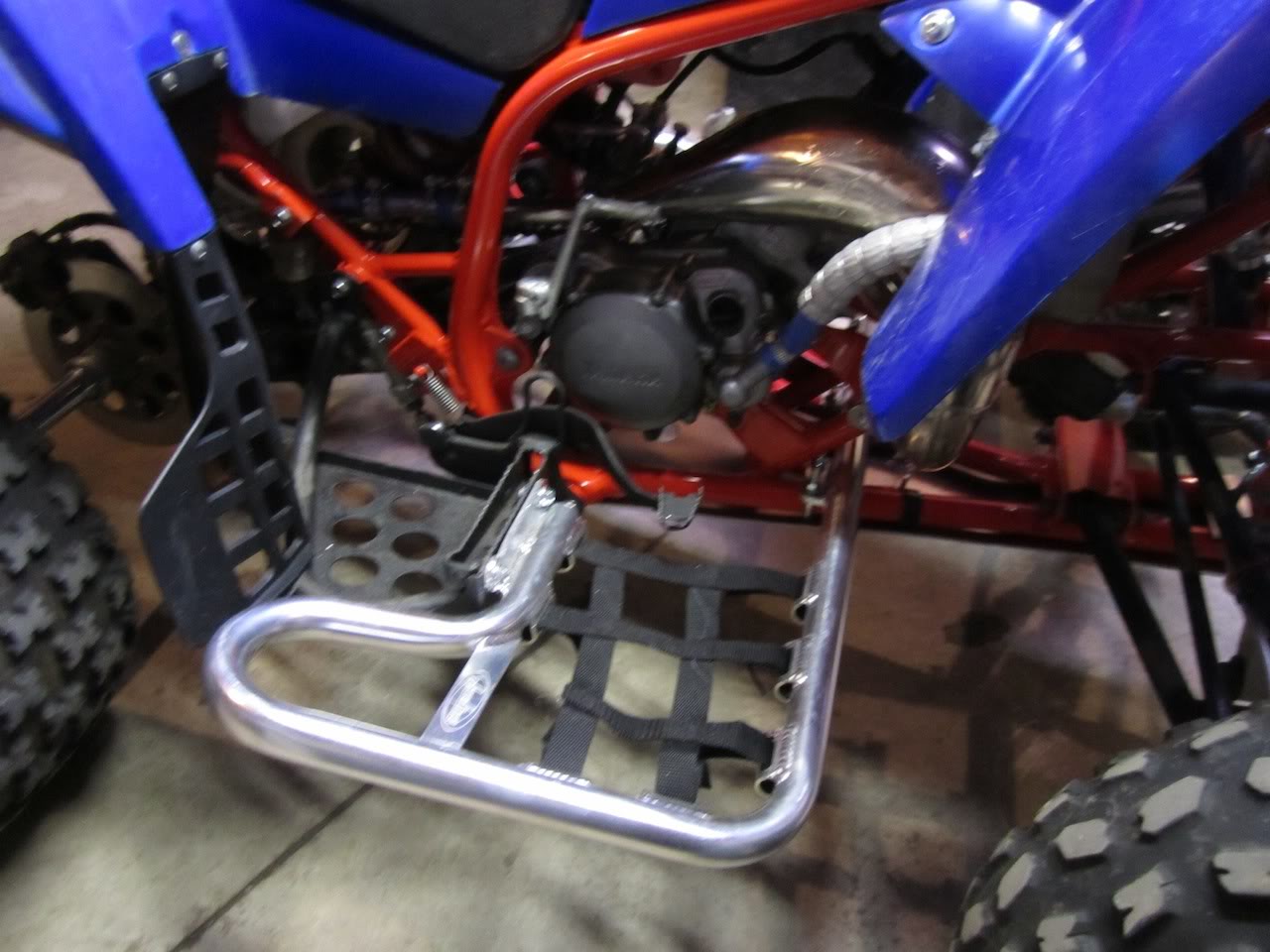

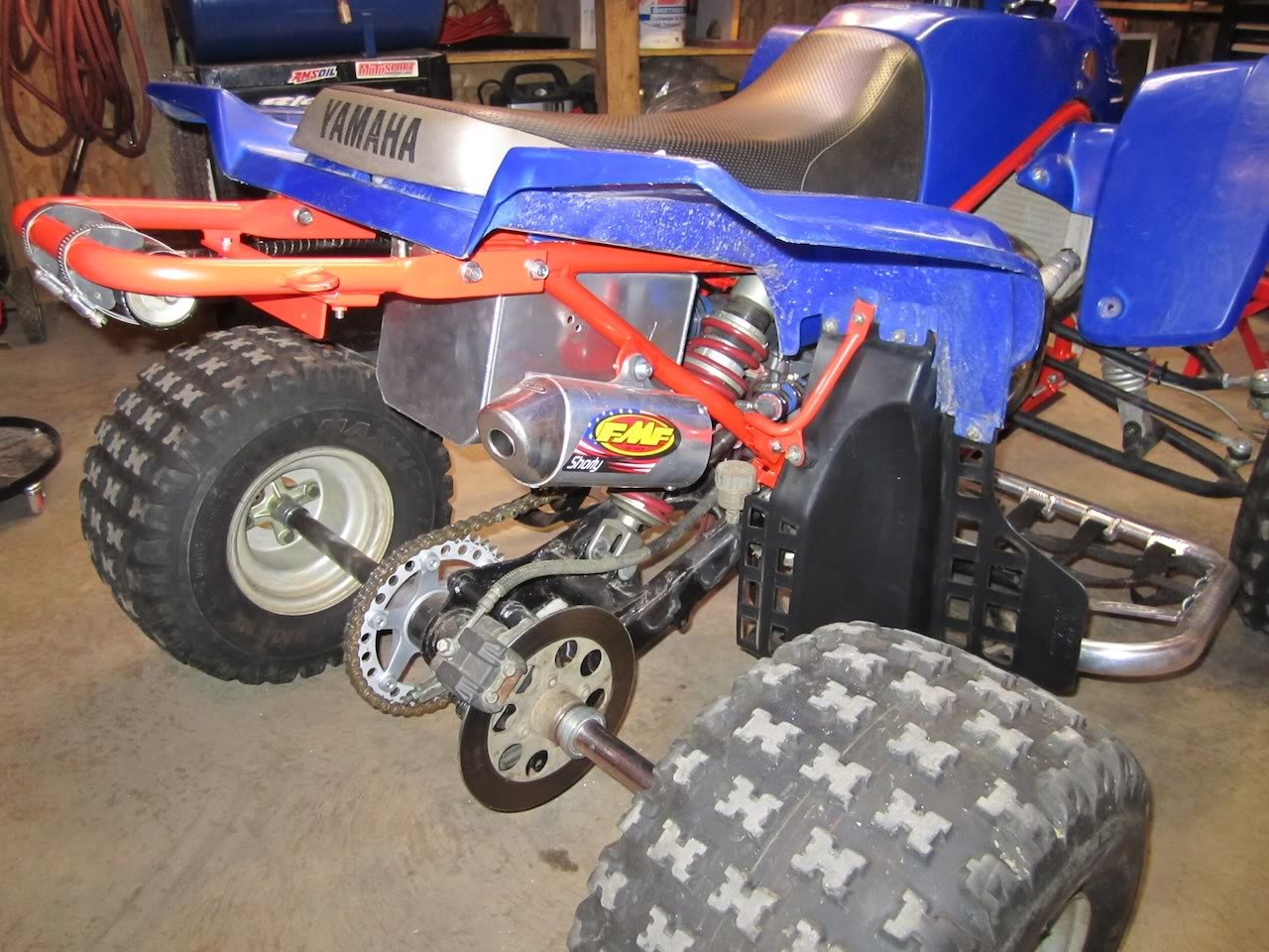

the swing arm mount on the engine had to be bored out to fit the stock blaster swing arm bolt. and we are not running any rear motor mount's, just the front mounts and the swing arms mount..

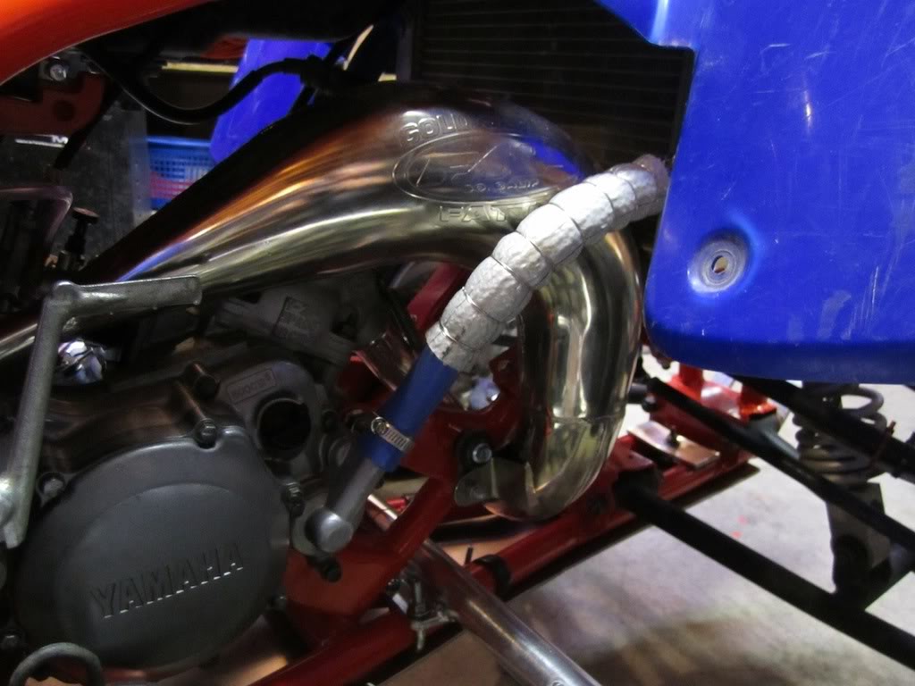

the engine has a stroker (not sure on length, but it makes it an actual 90) high compression Wiesco piston, ceramic bearings, all Hinson clutch (basket and all) fmf fatty pipe, milled head..... and alot more... there is not anything else to do to the engine other then a BBK..
im not sure what the weight is, but it is light as hell....

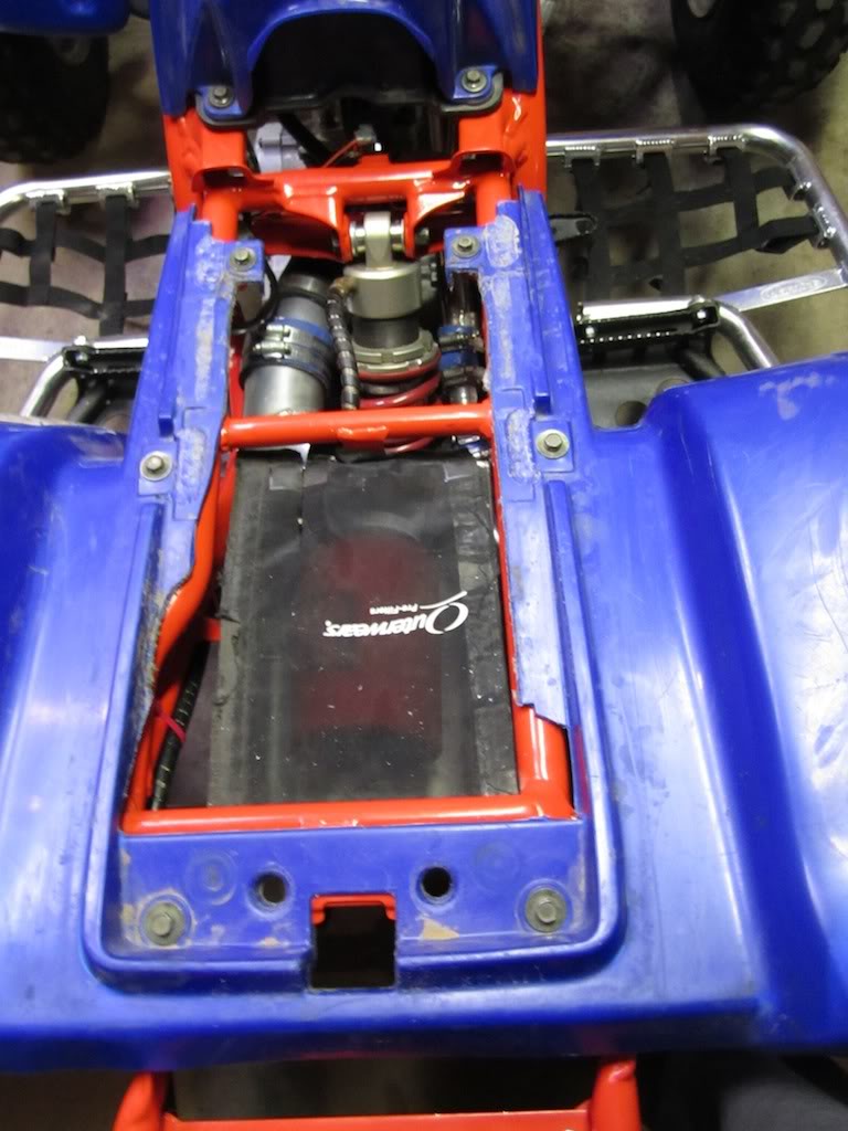

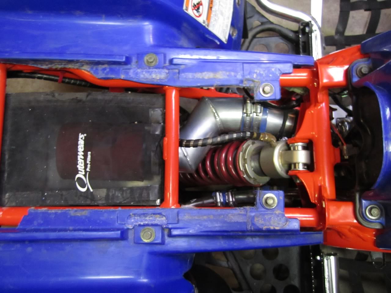

forgot to mention, the rear shock is the custom axis off of my 450r. thats why the ressie is so long, it will not stay on the grab bar.. we will be having it rebuilt and a shorter ressie hose put on it...
