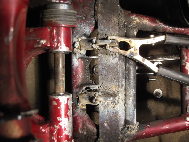

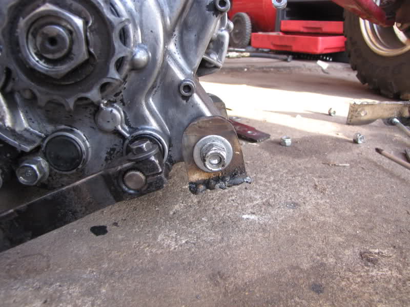

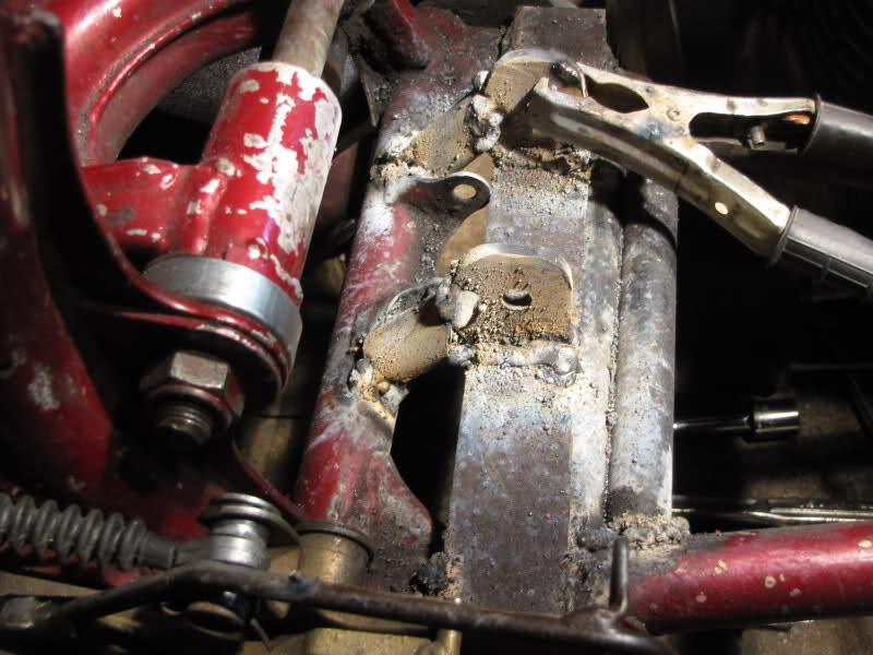

thats right the motor broke the welds on the qquarter inch plate steel I used for the back mounts. So I rewelded them and reinforced it with this.

If you continue to have welds break on the motor mount use some 1/4" angle iron and run bolts though it. It's what I did from square one after reading others bad luck with welded motor mounts.
If you go this route you will need a drill press and some cobalt bits.
If you don't have one just make the mounts, mark your holes and send them to me I'll drill-em out for you but the holes in your motor plate you'll have to do by hand of course.

the reason why the welds are breaking is because welds dont hold up to harmonic vibrations very well (strong ones anyways)
see if you can bolt it and weld it

well as you might be right, the main reason this specific set of welds broke were due to poor penetration. I was just learning how to weld and after closer inspection, I didnt even penetrate the mounts.
I belive you're not getting good penetration on your welds. Clean the weld area of all rust before welding. If this holds till you get to paintre-do the welds. Put a bead on the other side of the tab, grind it for clearance if needed. Don't know what you're using for a welder, but try turning up theheat a little.
I was using a base model flux core mig welder. this last time i got some good penetration on the mounts the first time i didnt know what i was doing.

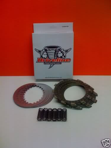

Just ordered this
its basically like there stage 2 clutch kit. DReeds says he runs one on his modified shee so I should be good on my bike.

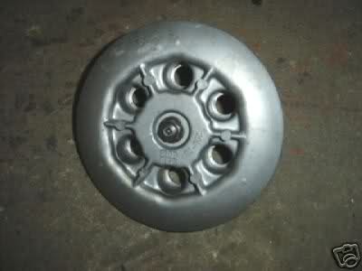

Also ordered one of these for easier clutch adjustment
banshee pressure plate.
