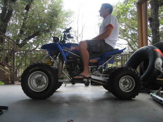

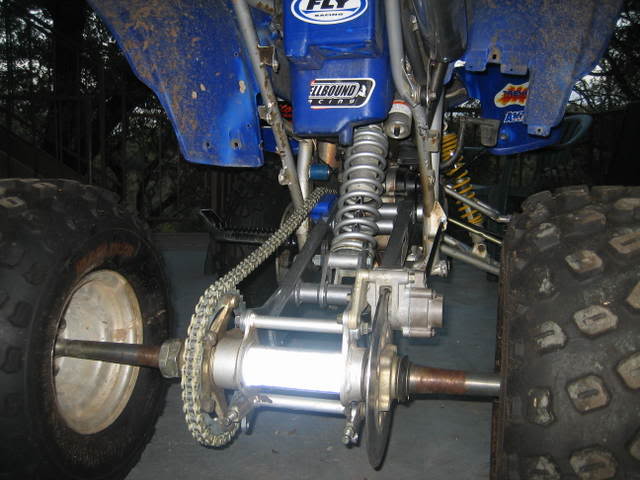

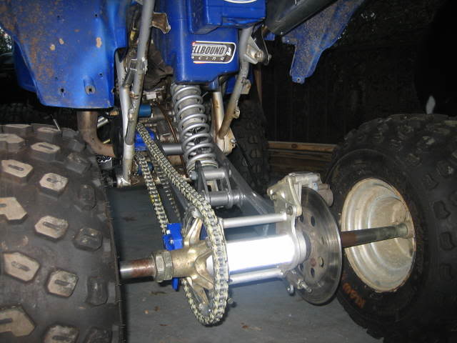

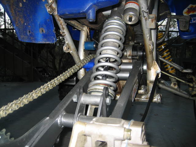

I thought everyone on here might like to see this. I put a +4 swingarm on with a lowering kit so I could put the longer YFZ shock on the rear. There is a small clearance issue with the silencer pipe, but I just spaced it out from the frame on the mounting so the pipe is not touching the reservoir. Any questions, lemme know...this ride is 10 times better than the stock setup, and I didn't have to drop $400-800 bones! People are selling these shocks on ebay for nearly nothing and trickin out their YFZs. Now I just need a longer axle with a wider, YFZ equipped front end!
![IMG_6548.jpg](/proxy.php?image=http%3A%2F%2Fi123.photobucket.com%2Falbums%2Fo289%2Fchrispershall%2FIMG_6548.jpg&hash=dcf199ed4fbe5ae156eb7daadd3f0e9e)
![IMG_6549.jpg](/proxy.php?image=http%3A%2F%2Fi123.photobucket.com%2Falbums%2Fo289%2Fchrispershall%2FIMG_6549.jpg&hash=33723d43026a7a41387457ce86afb974)
![IMG_6550.jpg](/proxy.php?image=http%3A%2F%2Fi123.photobucket.com%2Falbums%2Fo289%2Fchrispershall%2FIMG_6550.jpg&hash=51a73d742eaa3b6f12619b46eecaa70c)
