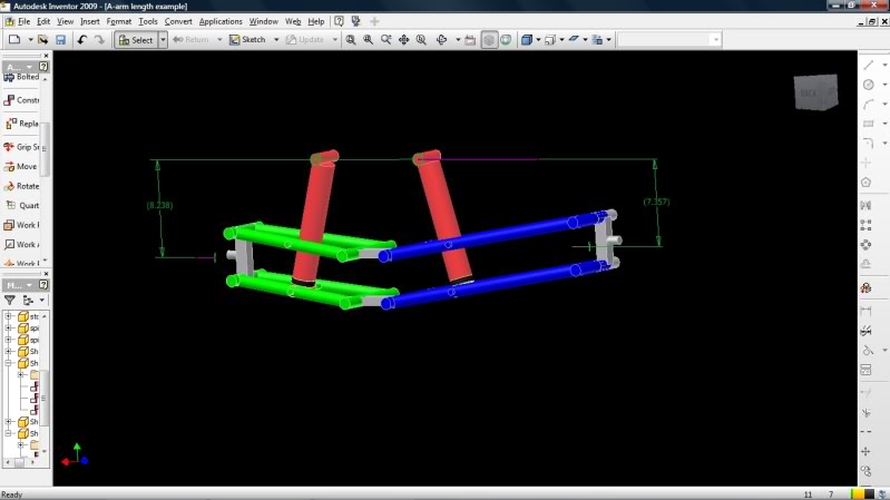

Here's the lever idea in a simple model, dimensions are made up randomly but the principals are all the same.
"Stock" A-arms depicted in green and +3 in blue.
Stock is 9.614" of wheel travel, +3 is 14.423"
First picture is drooped all the way out.
Dimensions read 21.78 and 17.852
Second picture is at full bump. Dimensions read 7.357 and 8.238
Again, the numbers are not actual wheel travel of any blasters that I know of. Based upon arbitrary numbers for dimensions.

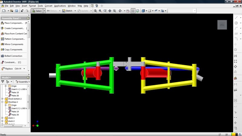

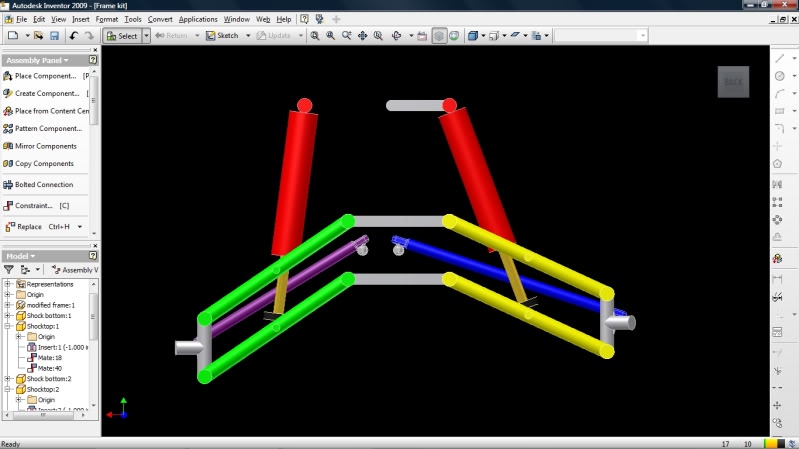

I wanted to add a visual to the tie rod situation with the kit that I touched on above. Here's a couple more models. Again the dimensions are arbitrary.
"Stock" arms in green, a simulated frame kit with "Stock" arms in yellow.
Tie rods are "Stock" in purple and the tie rods from the kit in blue
Full droop note the angle of the tie rods compared to the A-arms
Full droop from the top look at the change in toe in/out.
Full bump again note the angle of the tie rods compared to the A-arms
Full bump from the top, once again look at the change in toe.
