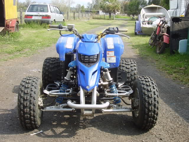

My lads bike he uses for flat track and MX (he lifts it up for that.)
Works very well but does exhibit more bump steer over wider A arms.
Fit up was a small problem as 4 of the lower bolts were to short, (cant remember which ones, but I think the 4 longest ones in the kit).
The tie rod extensions are a little weak, my lad bent one on a rough surface, but it did not break.
You may need the lowering kit as well to allow the shocks to sit at the right angle, and to adjust height.
This is my lads Blaster with both the widening and lowering kit fitted.
That is a sick bike. Like I said, I have the kit, just haven't installed it yet. After seeing your buddy's bike, I just went on eBay and ordered a lowering kit.. lmao
Its my 14 yr old Sons bike, its the bike in my avatar.
