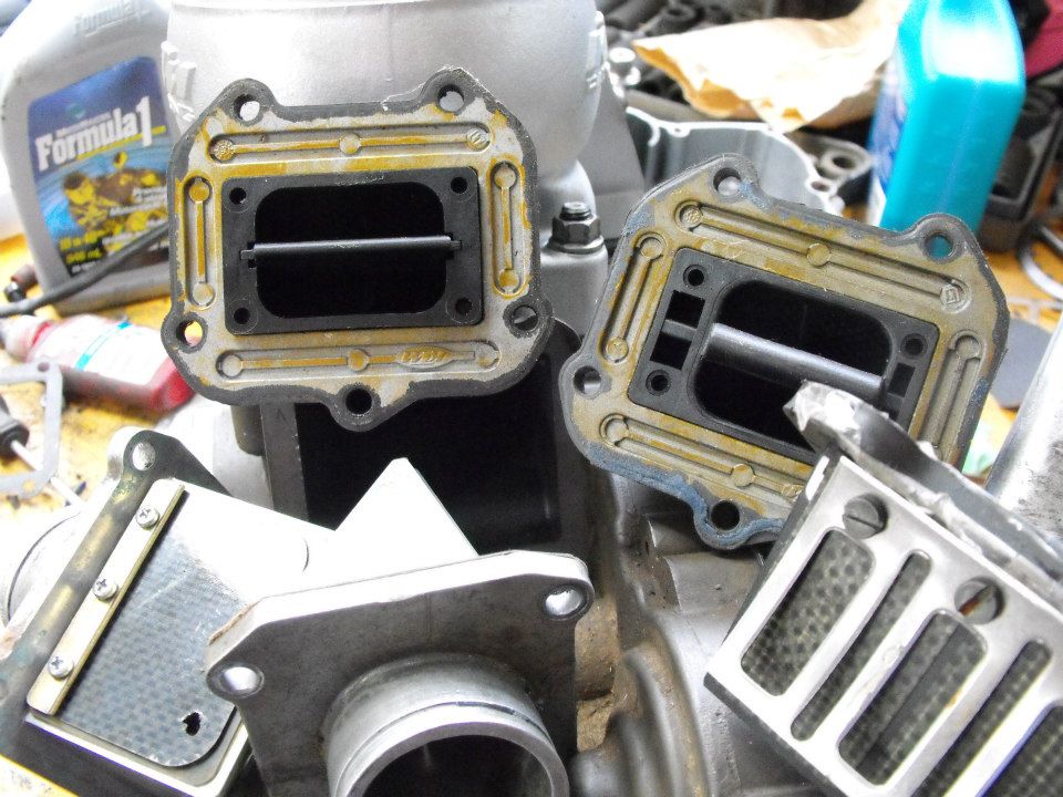

Okay so Im going to be replacing my reeds on my blaster I got for cheap, I want to use the stock reed cage. What are some good reeds? Boyeson makes like 10 different kinds so be specific.
I have dual stage reeds amd honestly i would rather have single stage
Why? Give us reasons?
I dont like the gap in the dual stage. It makes me feel uncomfortable. The dual stage have 2 reeds on each side basically. The bottom ones which seal and the top ones that have a little gap. And that makes me feel like my reeds are bad.
Personally, unless your Blaster is already highly modified and you are trying to get the last 1 or 2 ponies you will not see a noticeable gain from changing to an aftermarket reed cage. Save your money and use the stock cage with aftermarket petals. Plenty of people will contradict me on here but do your research, talk to professional engine builders and see what they say.
