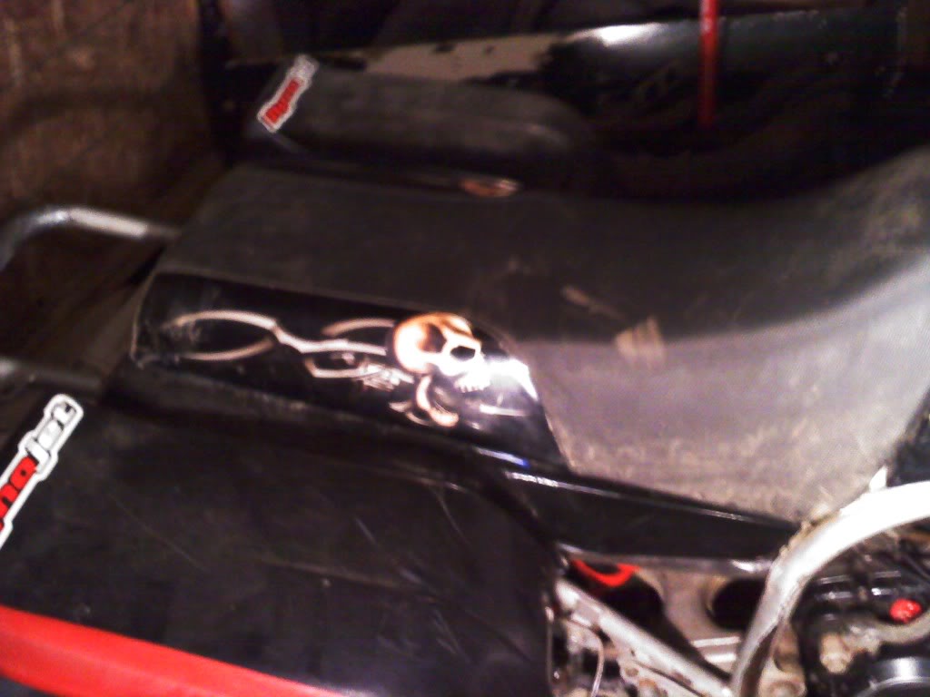

my seat cover!!!!!

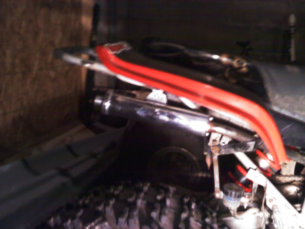

silencer got all finger printed up when i put it on gots to wipe it off
well just did the first heat cycle and she sounds just amazing if it moves as good as it sounds il be realy happy and i had it ported redisgned head toomey silencer 450r shock and took the air box lid off
