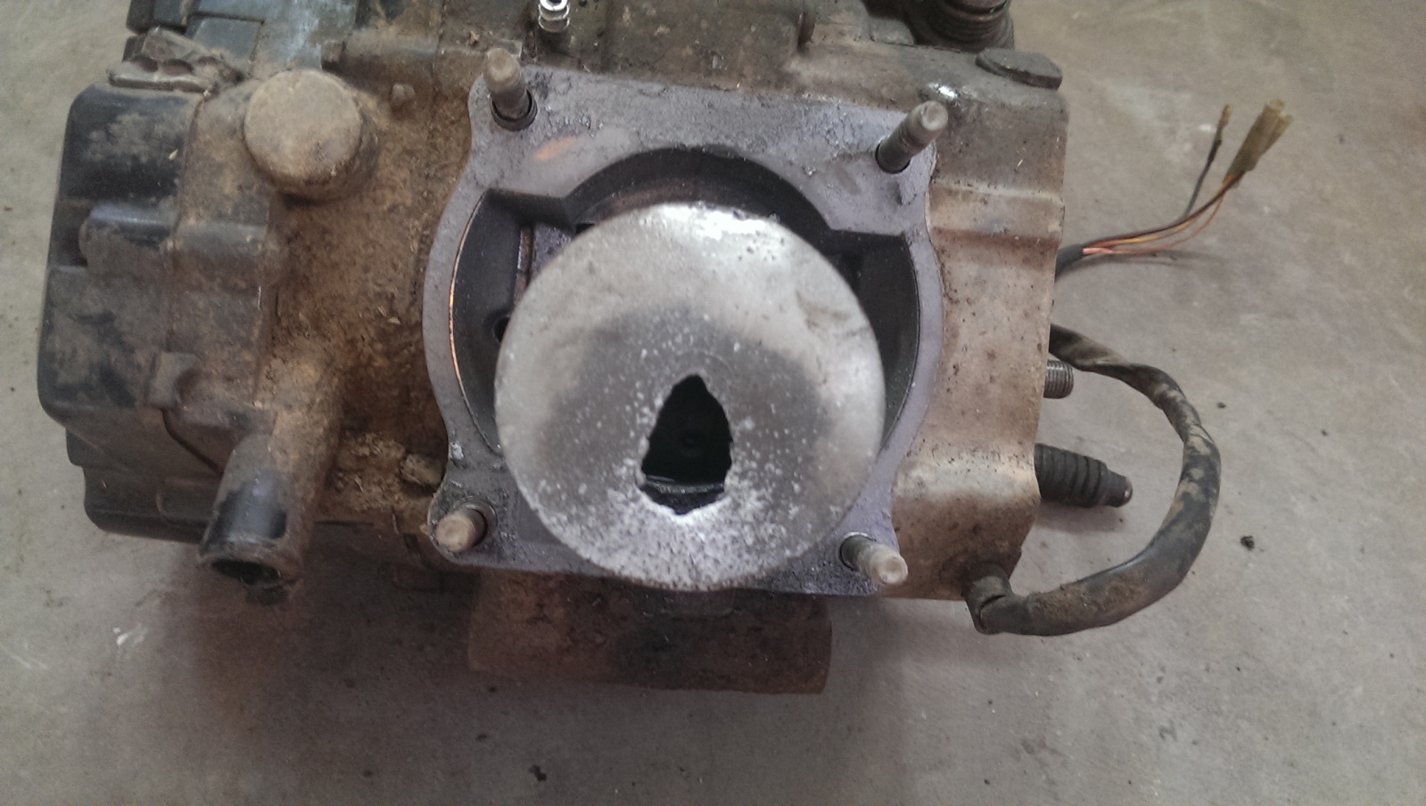

Basically you're getting the motor up to operating temperature and then letting it cool off. Retorquing the head and base nuts and doing heat cycle again. Repeat two or three times. You are trying to get the gaskets to set properly. If heat cycles aren't done, you run the risk of an air leak causing lean condions...and potentially destroying your top end and crank
Here's a pic of what happened when my bike was running lean because of a head nut that came off...
Hence why I am doing two rebuilds and not one lol
Heat cycles are done to new gaskets and rebuilds.
The gaskets must be conditioned and fastenings re tightened or they stand a good chance of leaking and you will end up with a DJ piston.
