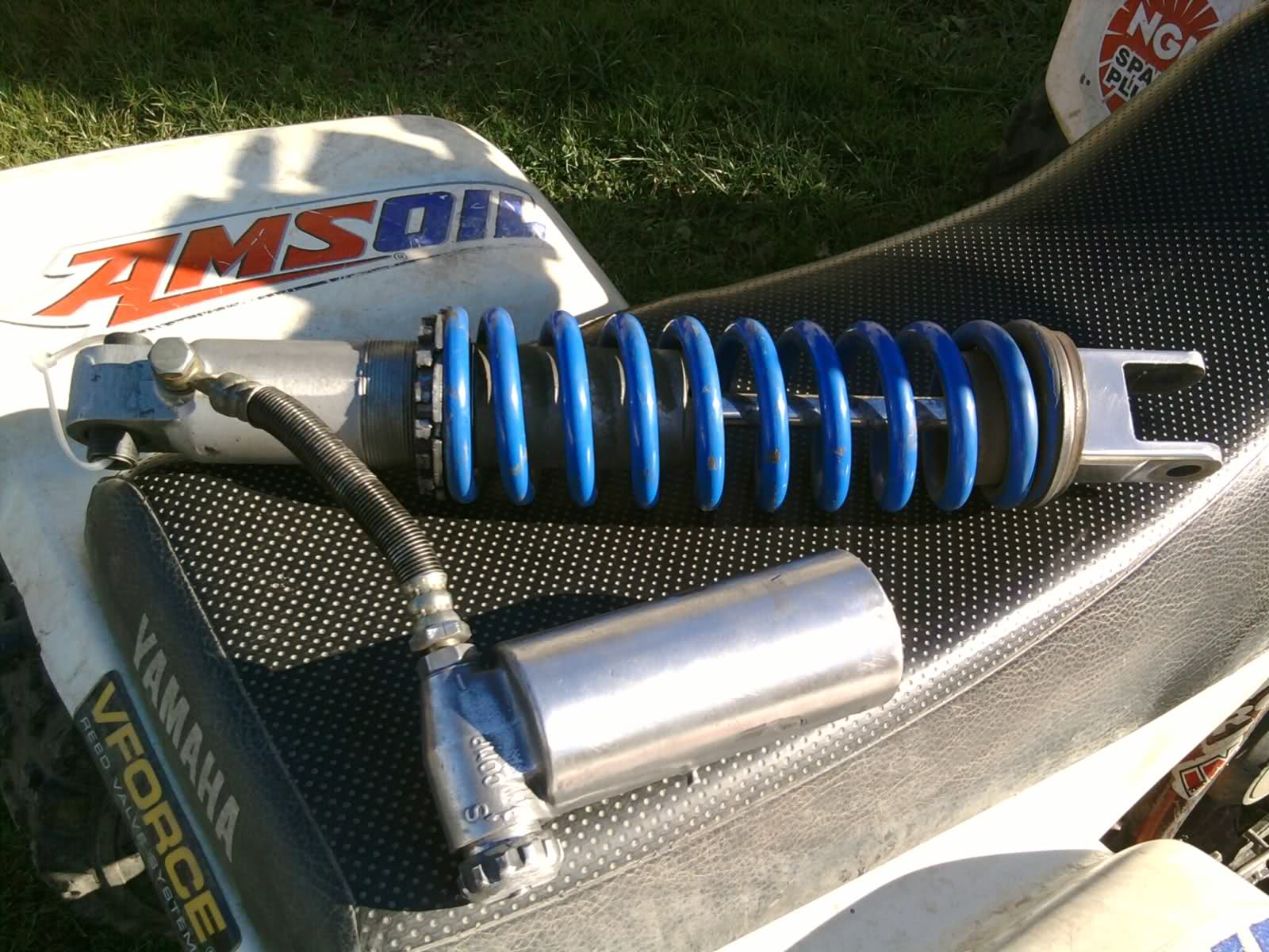

trx250r shock, very nice shape and clean, the one i have on my sons blaster gives it like 12 inches of rear travel, very plush.
i won a "works ultra cross" for mine so wont be needing this one
$60 shipped anywhere in the lower 48

awk, do you think the 250r shock softer than a 400ex for my 200 lb ass? i need a softer rear shock but dont want it to sag when i first sit on it. would putting my ex on full soft make it softer without sagging?? sorry for the thread jack but its sold anyways haha :D
noobs, i have both, a trx450r rear(same as 400ex) on mine, soon to be works ultra cross,
(450 sold)
and the trx250r on my boys, the 250r is way plusher, i have the preload set in the middle, and it drops down about 3-4 inches with my sons 240lbs on it, which puts it at a good height, and still has tons of soft travel, i have never bottomed it out.
i would say it's a way better shock than the 400's and 450's
but if ya get one, make sure it's a trx, not an atc, imo

i think it's advertised at 7 inches, but more like 5
Yhe biggest thing with the blaster is not the shock, although it does suck, but where the mount is.If u move the mount forward and down, you create much more travel, this will be happening on my build when i get my swinger extended. Should make for a much nicer ride, and i wont be afraid to bottom it out of big airs
cmon whitty, i dont know if your tryin to talk yourself out of spending the $60 for a trx shock or what, but your forcin me to bust your balls......stock shocks suck !!
no compression or rebound adjustment, the heaviest, stiffest spring they could find,
and there is nuthn compared to a fully adjustable, valved and springed for your weight, aftermarket shock
you keep your stock shock, move it forward and down so far you have 24 inches of travel, and i'll blow by you in the ruff stuff everytime with my trx or works rear suspensions !!!!!!!
Bahahahahahaha, I think u misundertood me lol, the stock shick does suck lol, I have my 400 ex shock already, and it is leaps and bounds over the stock shock, I was just saying the more can be done if u have more travel on your mind like I do.
Anyways, that is a great price if it aint sold already, someone snatch this up
good for you whittey, thought you were defending the pos stock shock, my bad, but i'm still blowin by you, hahahaaaaaaaaa
