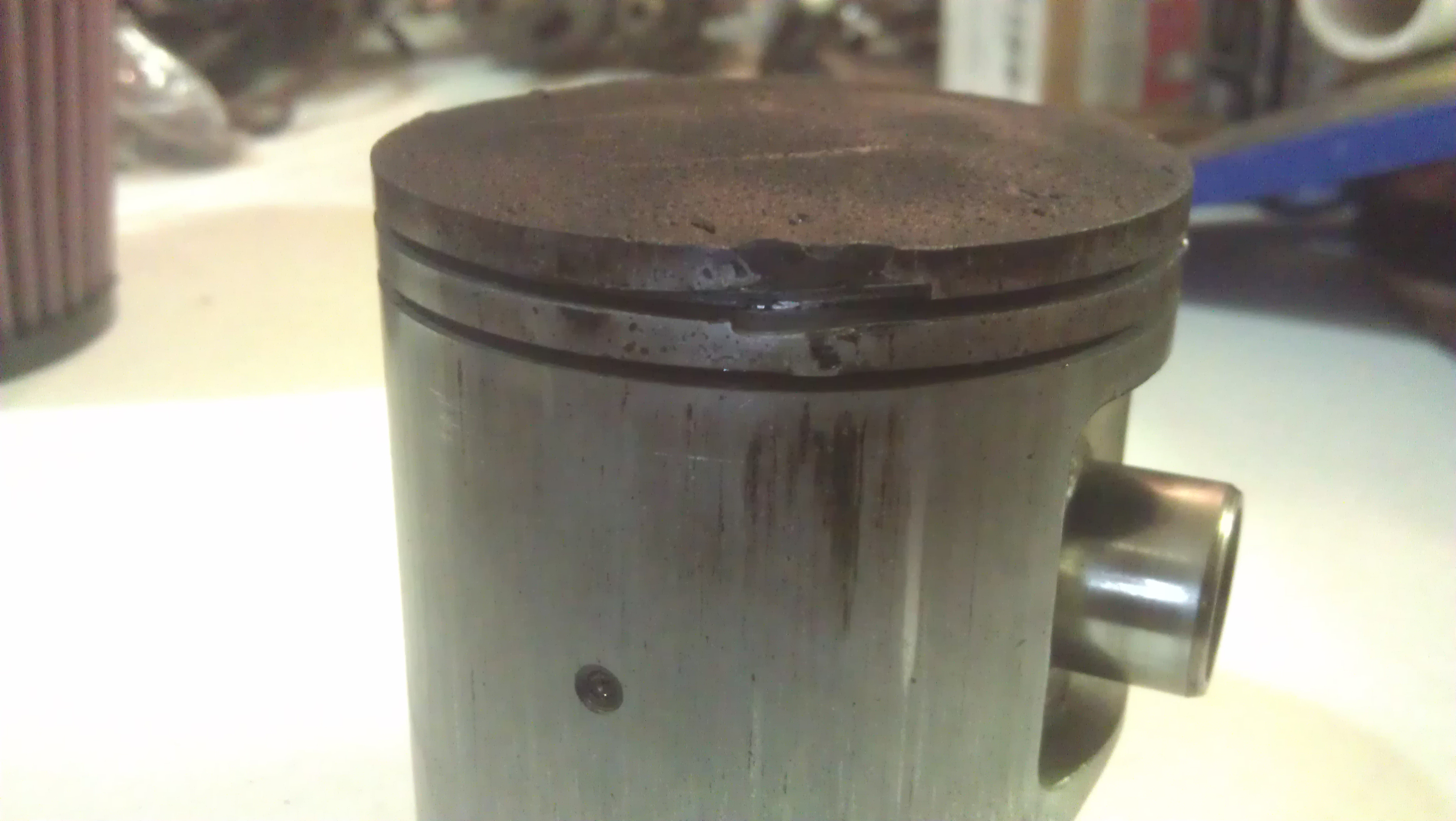

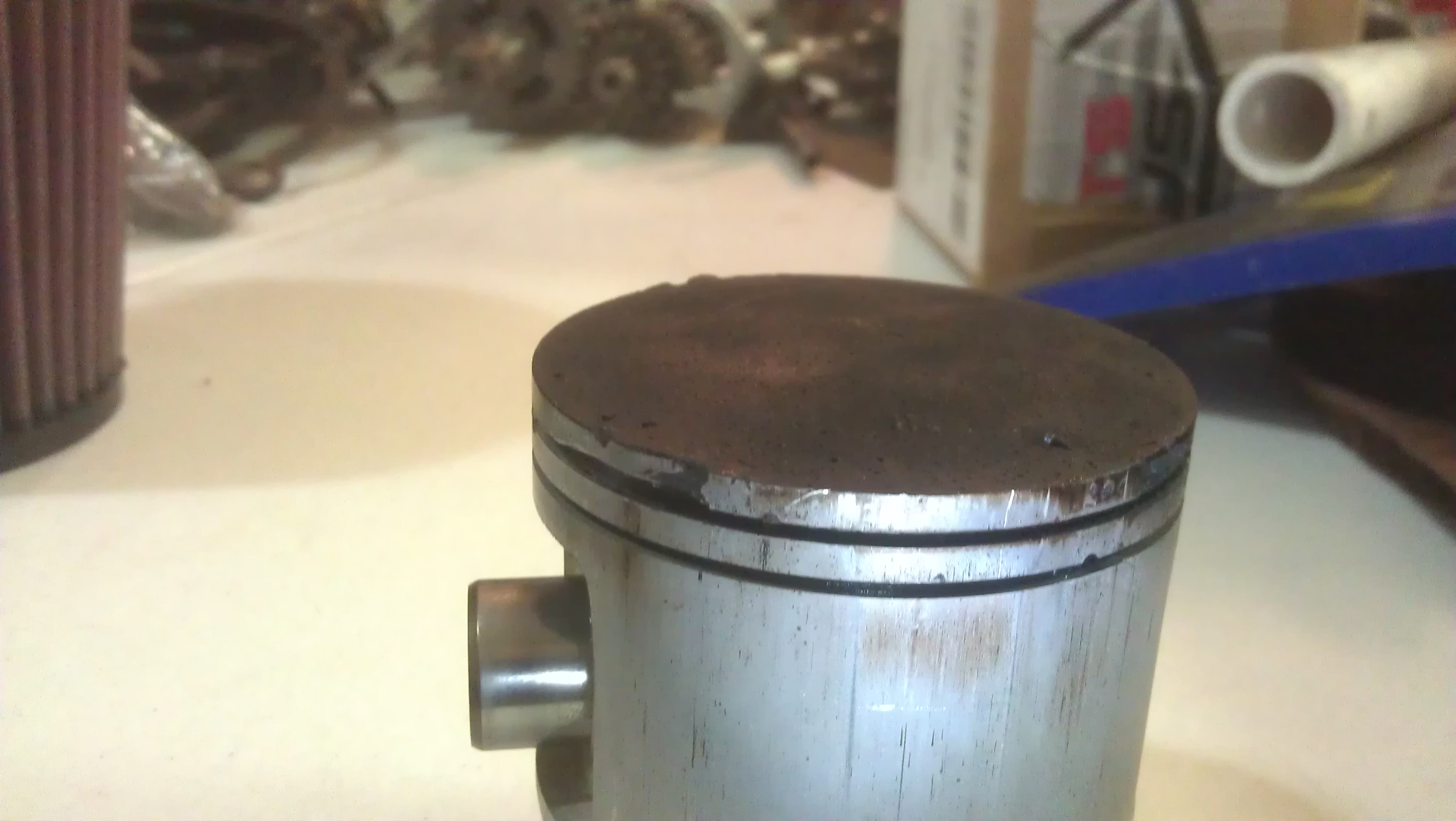

I checked my top end and it looks like its time for a rebuild (some scaring on piston), but will needing a top end and low compression (145psi) cause it to burn excessive fuel, not too long ago my son and i rode around 6 hr on a full tank, him on a Blaster and me on a YZ250.

well i found out the issue to my bad compression, i went from 140 psi to 190 psi with a new top end, but I'm still smoking like a chimney and going thru fuel like there's no tomorrow, 2 gallons in 1 1/2 hrs, my slow jet is a 50, it wont idle and the smoke is thick and lingers, compared to my blaster and YZ250 its like 3 times as much, could it be that i need to be really lean im thinking of somewere in the 40 vicinity on the slow jet, what do you guys think?

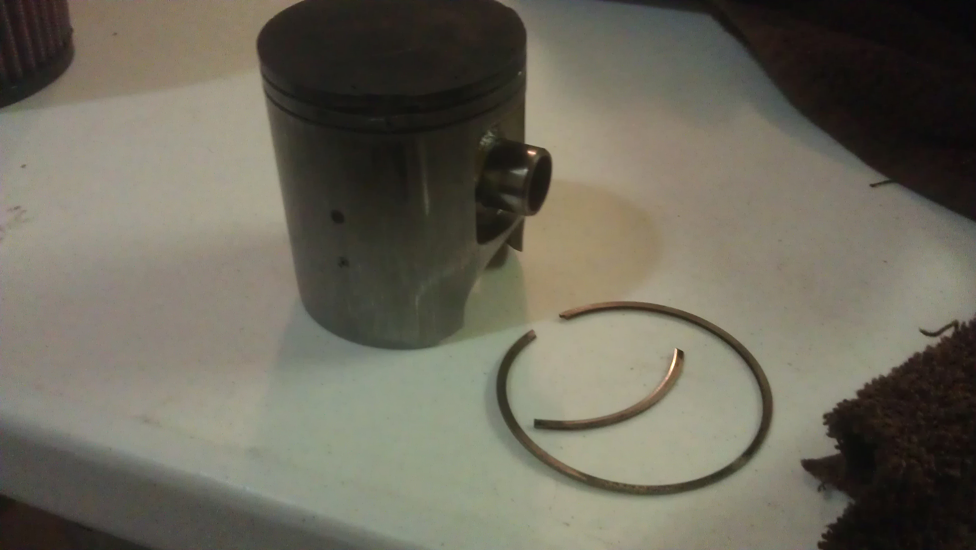

The top ring broke in 3 parts, i only managed to find 2 could it be that the 3rd one left thru the exhaust?
