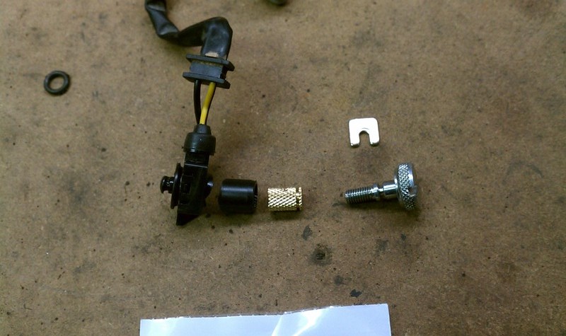

So I present you my solution.
![imag0848i.jpg](/proxy.php?image=http%3A%2F%2Fimg848.imageshack.us%2Fimg848%2F2272%2Fimag0848i.jpg&hash=cc964e181e0997ec159cdfefd22582f8)
These are the pieces.

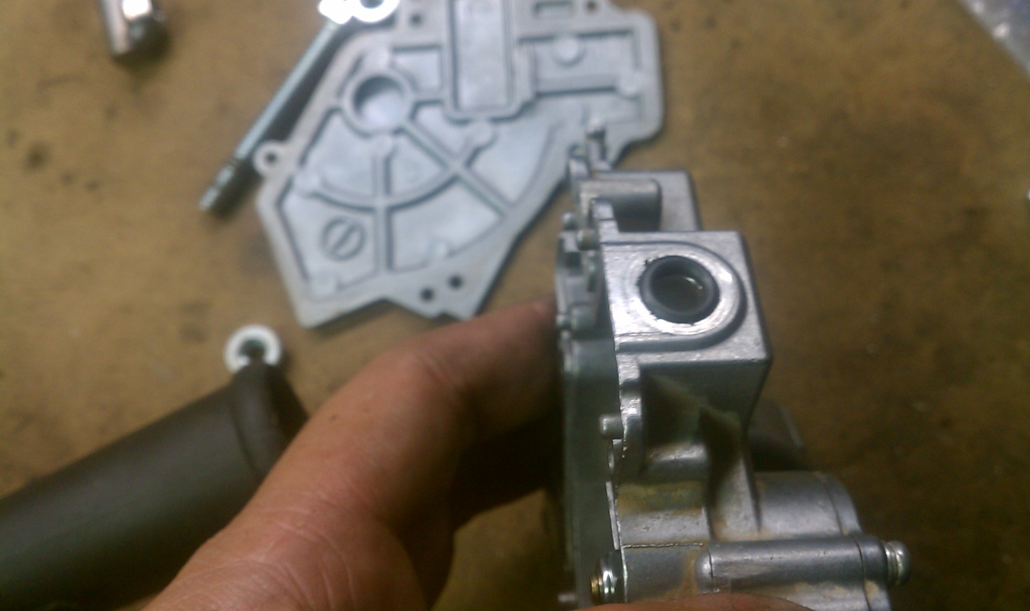

So after spending some time at my hardware store i figured a way to fix it for less then $5 bucks.
This is what I used.

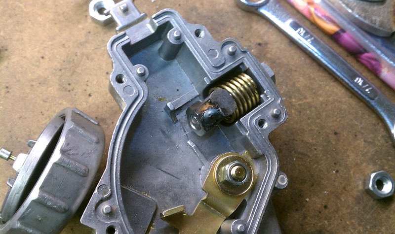

![imag0853r.jpg](/proxy.php?image=http%3A%2F%2Fimg830.imageshack.us%2Fimg830%2F9268%2Fimag0853r.jpg&hash=3a65ea922b4858c5df54d08c4b5dc6d6)
I needed to grind down the cross dowel so it will fit in the case, and this is my holder.

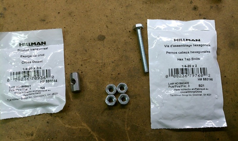

![imag0858f.jpg](/proxy.php?image=http%3A%2F%2Fimg528.imageshack.us%2Fimg528%2F7635%2Fimag0858f.jpg&hash=025bc73f535ee8b5c1debe3549e91183)
After grinding the top and bottom, I saw that i needed to grind the sides as well, then I welded a small nut on the front so it would push enough on the throttle lever.
