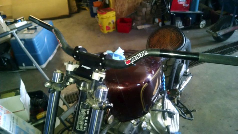

I have these Powermadd 7/8" to 1-1/8" x 2" rise on my scooter build, they also come in 3" and 4" rise, and 7/8" to 7/8"
CNC'd out of a solid block
http://www.ebay.com/itm/PowerMadd-P...ars-PM15431-/191586609250?hash=item2c9b73a862
2" rise w/ MSR fatbars
