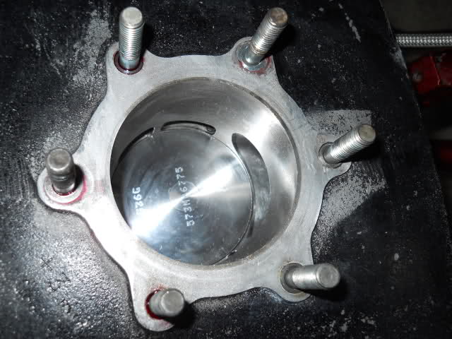

Sorry it's been so long since pics but it's really just taken down right now until my head gasket get's here in an hour. but here's some shots of my timeserts in. yes all of them but one is a timesert and it is a helicoil

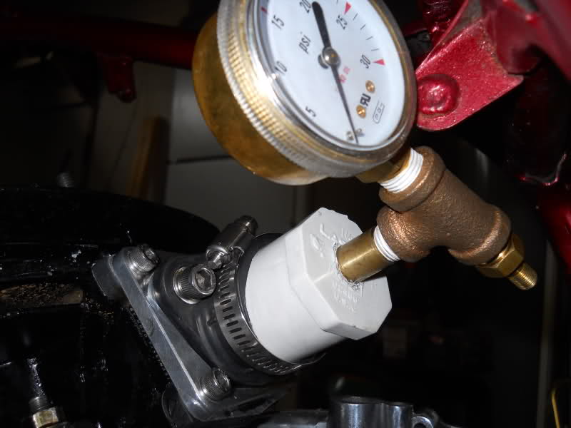

This is my leakdown tester. works like a charm. too bad my head gasket didn't workk as well. but i didn't make the headgasket. lol
