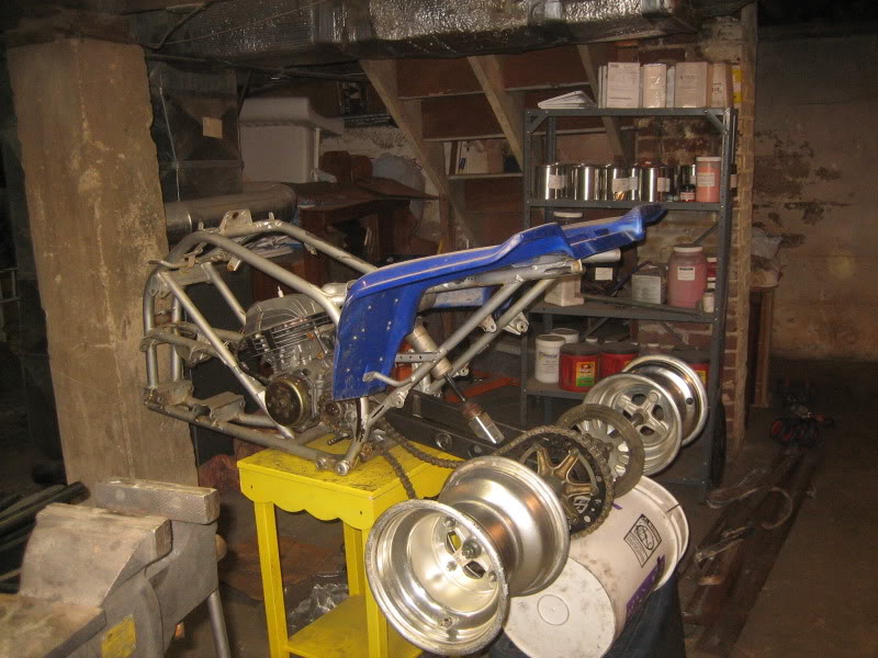

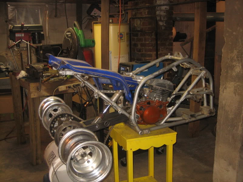

The build has begun!

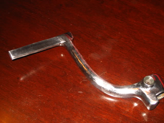

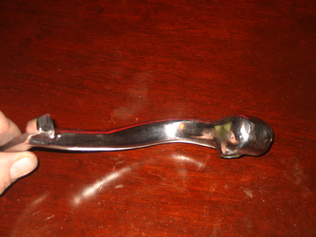

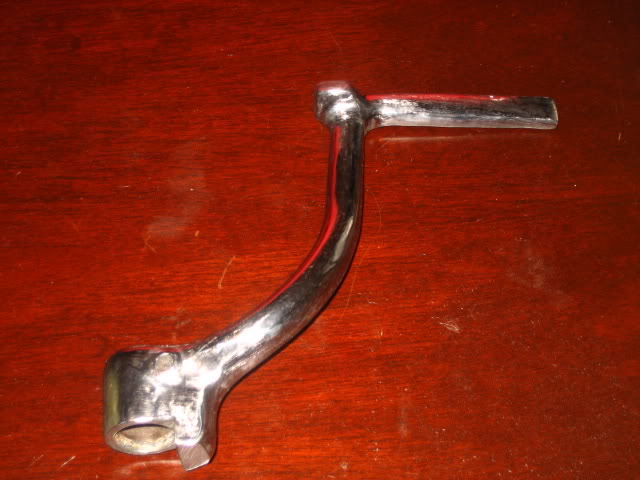

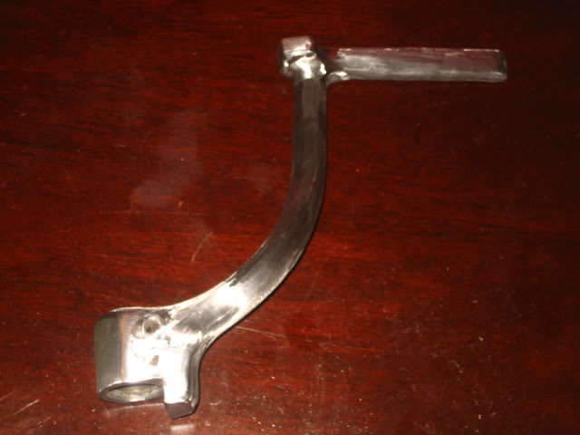

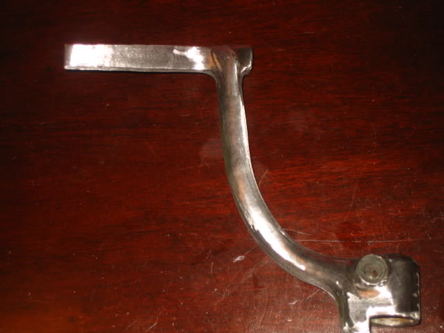

More kicker grinded with dremel
Yeh i think it needs more sanding...evening out some spots, but I'm not gonna spend hours on a kicker tho! Thanks man..
I here ya. Its just going to get kicked around anyway ahha. Build is coming along nicely though man, got any other pics of some stuff put together?
Not at the moment...I am in the middle of texting someone with some works shocks...so that may be on the list of soon to be gotten items! 400ex rear shock, works front, hopefully +2+1 a arms, and +3 swinger it should look pretty good! oh I am gonna have the 03+ plastics...i will say this...the plastics are going to be new and a different color! I will show them after the bike gets put together...I figured out i am doing the frame in a charcoal metallic, orange transparent parts, and polished stuff. I may sand down the surface of the rotors, and hubs, then polish them for powder coating as well. Decided on Banshee wheels as well and they will be polished. All calipers polished and hopefully smooth. Already got the fender brace for the front polished up, and cut the rear brake light to accomodate my new LED brake light i bought. It has amber, and red lights in it.
Still alot of parts to get...but slowly coming along! I am just as excited as you guys are...I see it done in my mind, but dammit it needs to be done now!
Very cool what you did with the kick starter. In my opinion it's the little custom things that count. I guess I know what I'll be doing with my kicker. Good luck on the rest of the build.
Thanks man! Just took a 4 1/2 grinder with a flap wheel grinding disk and smoothed it out, then smoothed it more with a drum sanding disk on the dremel, then sanded it down with 120 grit sandpaper by hand, then polished it with mothers and the dremel. Not much to it! And cut that annoying flap off...

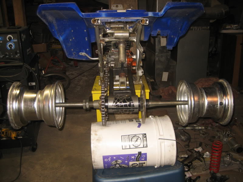

Just a quick mock up of what it looks like now. i gotta do some gusseting and more strengthening on the shock mount and a grade 8 bolt. Like I said...quick mock up so there is still alot of fine tuning to do. Had to re locate the shock mount because it was too far forward. There will be some strengthening in place of that hole there and completely covered up.
longggg and wide just the way she likes it............i mean,just the way the blasty should be!! lol lookg killer man,cant wait to see it all done.
