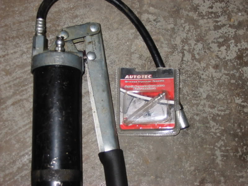

Ok, figure i work on the blasty today, get the new wheel bearings in check all the balljoints/tierods grease them all up and start fresh! I couldn't do a vid, so I took pics! Haven't ever heard of anyone actually refilling them I think it's pretty important to do if you are doing a rebuild or complete teardown especially if ya ride in water and soupy mud alot! Took me literally after disassembled 20 minutes that included changing a boot that had a tear in it.
This is the tools to do it grease gun and needle adapter can be found at any harware or auto shop place-

Actually that is what the needle is designed for, primarily bearings with seals, such as front wheels (hint, hint) I:I The rubber is somewhat self healing.
