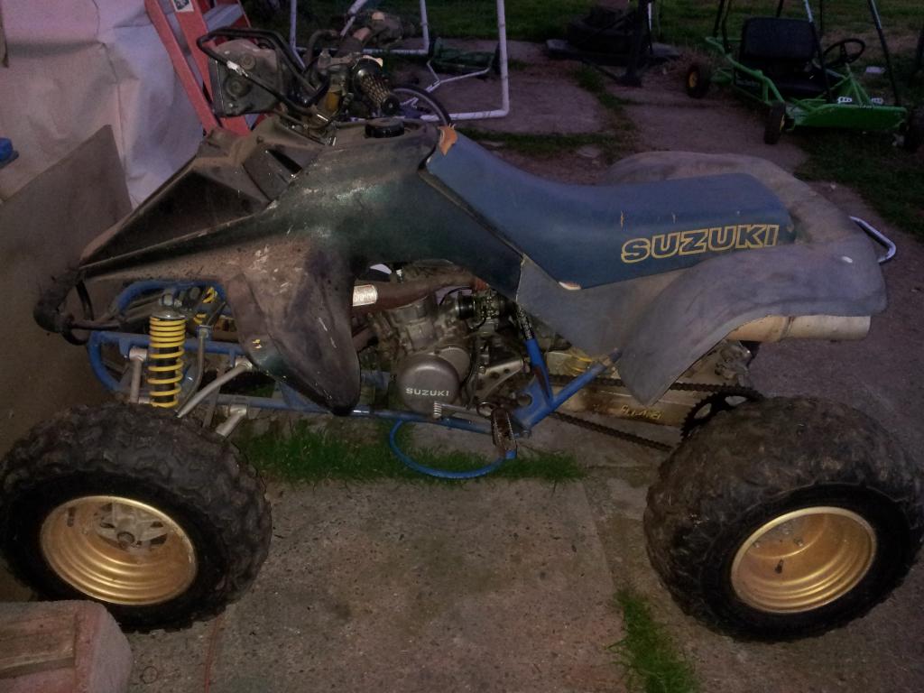

Dad - Susuki LT250R
Mom - 2008 Raptor 250 (She is only 4'11")
Kid 1 - Blaster
Kid 2 - Blaster
Kid 3 - LRX (Korean ATV, same as a Kasea 90)

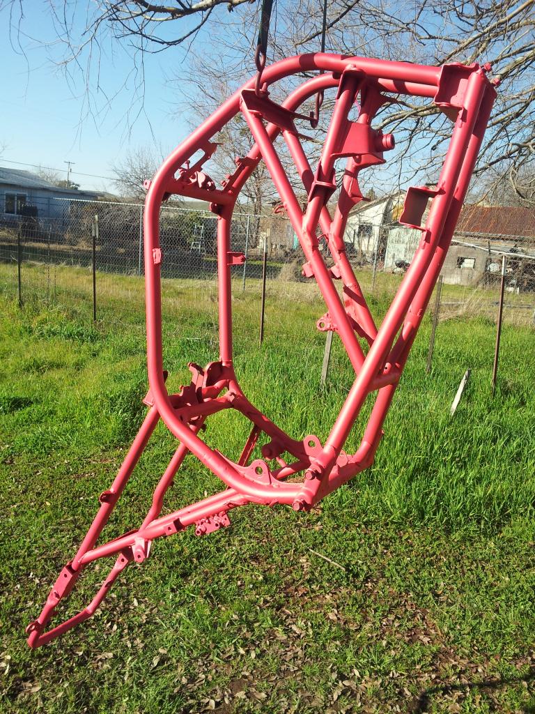

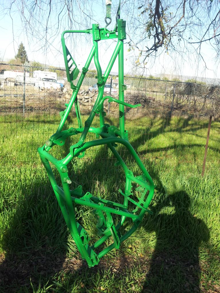

Anyhow, I started painting the quads today here is what they are so far...no clear coat yet
