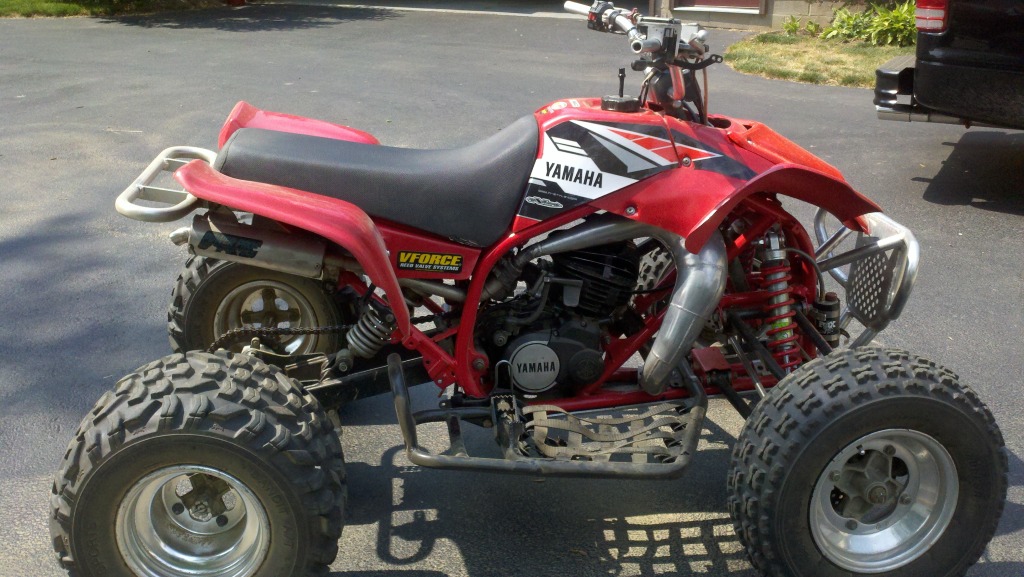

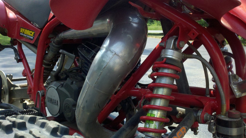

ok looks like i am putting the ported KOR racing ct240 sonic big bore with my stroker crank in my motor and putting the lightened flywheel in it aswell with the boyessen rad valve in it aswell but don't forget about the amr monster coil and i gotta cut my new plastics to put my sms airbox back on screw the clamp on filter so...

you can't just slap a cylinder onto a stroker crank, if the cylinder's porting isn't adjusted for that crank, unless you use the spacer plate
IMO......leave big wills CT motor together as it is, and either run it in your bike just like that,
or have it, or your current motor, as a spare
that stroker crank isn't adding as much power as they're cracked up too
that CT cylinder/porting is more than enuf power for you as it is !!!!!!!
and of course....use that rad valve as a paperweight !
it's choking off all the breathing that CT cylinder is capable of
