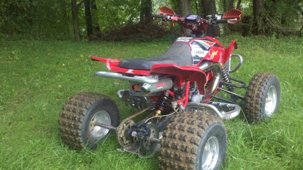

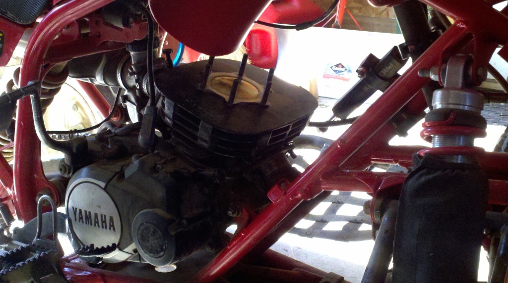

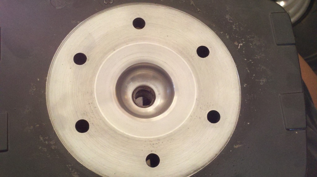

i took off my head today and put on the KOR racing high comp head and then i took off the boyessen cr125 reeds and put on the vforce delta reeds big mistake they have plenty of throttle response and very peppy lowend but it is very lacked in mid range like it wants to be overgeared even though it is in 1st gear they are not my cup of tea but if somebody wants top end theese are the reeds for them
Finally got my gopro home and my ps3 uploads my videos fast I have some of my bike paps bike and the Suzuki hehehehehe and they are all clear except for a scratch in my bubble lens so I need a new one it just looks like a blur
I also shortened my silencer today by 3inches a whole lot more torque and the head added a whole lot of power the Vforce reeds gave it better bottom and sucky mid but the boyessen had all the way around power

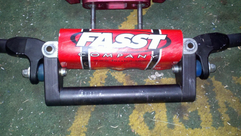

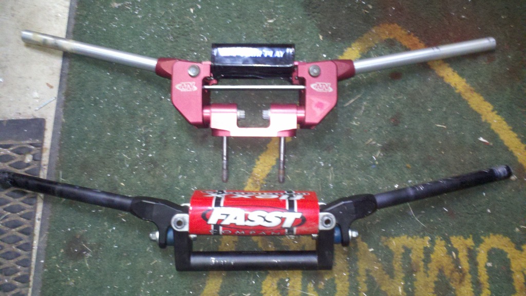

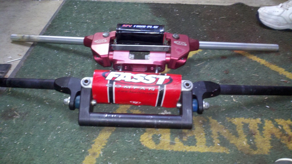

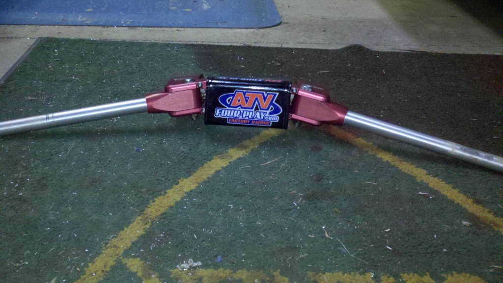

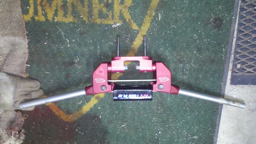

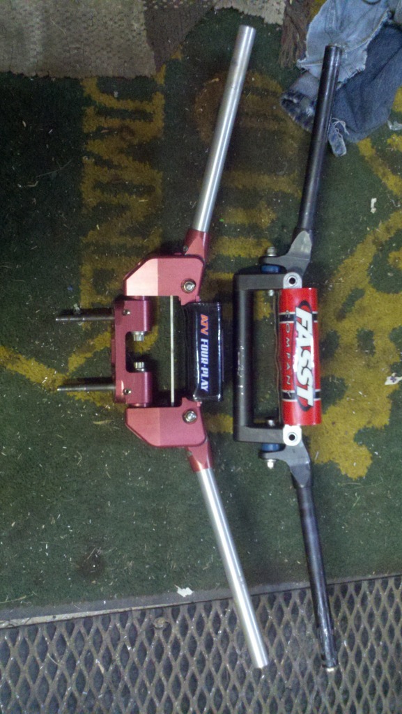

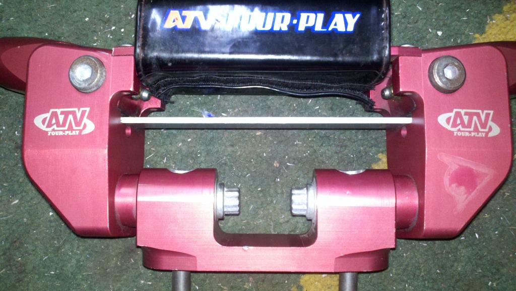

last night i got alot done. i fixed my fasst flexx bars so they work like new again.AND!!!!!! i ought me some new atv fourplay soft bars with new bushings. they can be adjusted on how stiff you want them without buying new bushings.

but... i cant wiat to get my anti vibe stems from uncle awk they will work perfect with theese flexx bars
as soon as lonestar gets off their asses and i receive the anti-vibe pieces from them, the stems will get made asap I:I

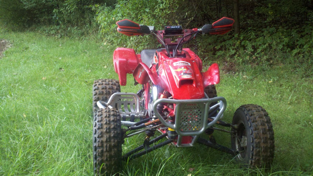

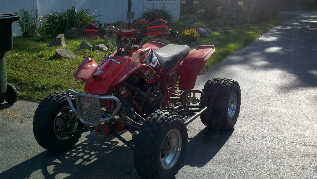

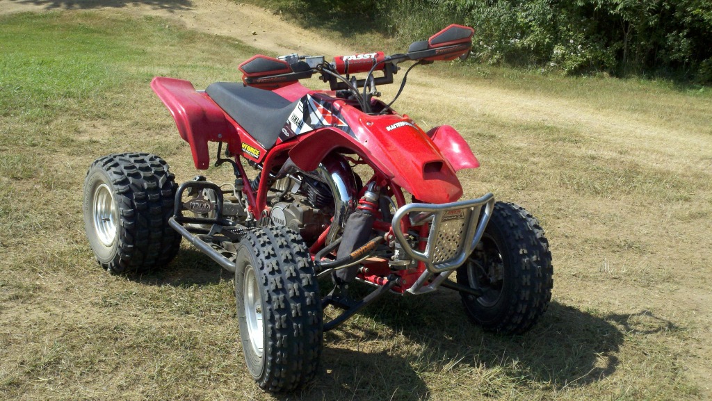

as you guys can see i finally got elkas and i got my xfr nerf bars and a actually good stabilizer and some maxxis razr rear tires

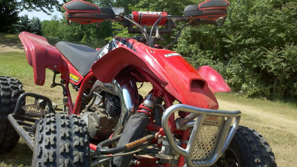

have to switch out my carbs going to a 36mm airstrykr and going to mess with jetting some more
might as well stay home from them races then, that 36 is gonna lose a ton of low end and be all top end, not what you want on an mx track or in the trails
i know i believe the one i have on there currently is a 36 will have to remasure my bike has alot of jetting issues especially down low and it starts harder than paps bike which is a 1 kick start so changing over then rejetting just so i get the airstryker

yea mx isnt looking strong so mx/xc is good enuf but the stabilizer i had worked like sh*t it worked one way but not the other i try turning right smooth like butter need to turn left cant turn at all.
