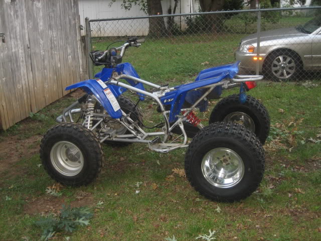

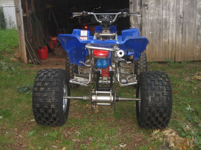

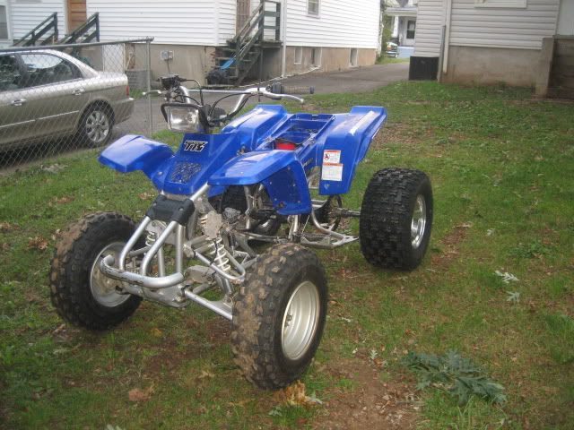

So I FINALLY got the right lug pattern rims and 10" tires.
What do you all think?
